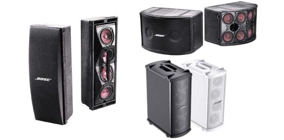

hi
hi
peterpan
totally soundreinforcement oriented
i know the design of the 802 matrix its a very good design and will work with any size of speakers to produce extreme realism in mids and midbass - the boxes are inricate to make , normally ive had to make thermocol models to explain such designs to carpenters
anyway
we will draw it in parts and explain the entire cabinet to you when you visit us , the dimensions may change as we have 1 ohms speakers but not of 4 1/2 inch size though i have the bose replacement cone / coil / spider kit
all the spks are wired in series in the 802
the panarray tops model is similar a matrix , all the mid woofers fire into their own enclosure / it will be diffcult to put in words we will draw that for you too
as for the 6 inches , we know the concept but not the enclosure design
what i have to say is most important now
the bose enclosures or other enclosures like the jbl control series (and all such) enclosures
are made of a accoustic poly_something (forgetting the technical name)
the important feature of these cabinets are that they resonate when the speaker is playing in the audible range and depending on application produce extremely impressive midbass frequencies
in the sence that the entire enclosure gets excited and vibrates such vibrations add to the spl
therefore
if you pull out the bose drivers place them in exact replica boxes of plywood / or other material , than that used by bose
the speaker will not play exactly like the 802 s , though youve used bose drivers
yet the box design (the matrix concept) and its application can have very good results even when ply wood is used (again strictly in sound reinforcement)

About the Bose cab material
Suranjan,
The material for the speakers is mica reinforced polyethylene. Is it available in India, S.E.Asia? What difference acoustically would it make if I were to use MDF?
Patrick

Re: hi
what you might be able to getaway with is thinner crossection of ply and than control the cabinet speak by using bracing and damping. what i am saying is that make the cabient live to begin with then use bracing to control the freq.you want the cabinet to be live and damping to control the level of the liveliness of teh cabinet.
even then dont expect to replicate the effect of mica filled poly. if you arei into moulding etc.. you might be able to build a box out of fiberglass matting (bonded with epoxy).
mica filled poly (braced) has a resonace that is soft and using bracing i suspect bose / jbl use the cabinet to assist the midbass (100-300hz) response of the speaker. I have exprimented with this concpet (not successfully enough) as a compensation for baffle step.

About Bose!!
Thanks there Navin,
I am seriously exploring the possibility of constructing 'xerox' copies of the Panarays in either molded form or braced. don't know how Bose went about it (whether its braced or molded) becauae I don't own a Panaray. But I;m very eager to try... in the near future (when I'm done with my current projects).
By the way Navin.. fiberglass is a subject that has facinated me and I really hope I can get into that someday.... (the resin epoxies are so darn expensive).
Now will you be kind enough to answer my question in the Toroidal Transformer in b/lore thread about welding transformers!
I'm desperate for an answer from any of you here.
Patrick

so far as my knowledge goes the bose drivers use
mica reinforced pp , the frames are formed in mica reinforced pp and the top plates insert moulded , this reduces driver resonances as claimed by bose
there are 100 s of ways to reduce driver frame resonances , what he has not mentioned is that such moulded frames solves the resonance problem in the 802 design the best
why
as these drivers are so compactly loaded the wall and the thickness of the cabinet is not large
and the cabinet itself is made of plastic type material
in such a situtation using metal frames will be diffcult and cost involving gaskets would be need to be placed for driver mounting
where as the mica + pp frames blend into the enclosure material wise
(navin will be aware , joining to totally dissemilar materials is difficult , speacilly in an enviorment where there is a lot of vibrations , screws of exact material , torque ets ets , making assembling costs high)
this is done by penshien of taiwan actually for bose (i dont know if it is right to give such trade news here ! )
the materials of the cabinet are not exactly injection mould material infact these moulds and the moulding material is moer like a pressure cast / formed
i have the list of the exact technical name , i mean compound
and their resonance frequencies
in fact it is a chart which includes mdf , particle board , plywoods (quite a few types ) to all these latest materials
notes on their application
these are of technical nature and manufacturer oriented where it cannot be replicated without involving heavy costs
why ?
big injection moulds require
ejection capabality , cavity of the mould generally ddoes not include further cavitys
if some one studies the 802 there are 8 seperate cavities
if this was a injection mould the cabinet will be very difficult to eject
there for the material flows more or less like a die cast
in order to make such cabinets first we have to locate - who is doing such moulding
as the moulding process is different and quantites are low
then getting the moulding material will not be a problem , for some one who has the money to shell out firstly for such a big mould
plastic moulding is of great interest to me and i have made quite a few moulds such discussions on the design of the mould and its ejection procedure are wellcome
in all this the good news is that forgings of taiwan is moulding the cabinets for bose
anyone with brains can get these cabinets from them at around 6000 to 8000 each , drivers from me 1000 X 8 and have bose ready ! prior to investing in the moulds
then market this india wide check out customer base
then slowly mould the cabinet / costs for such a moulding will be around rs 2000 each - a rough guess ! and reduce production costs
suranjan
