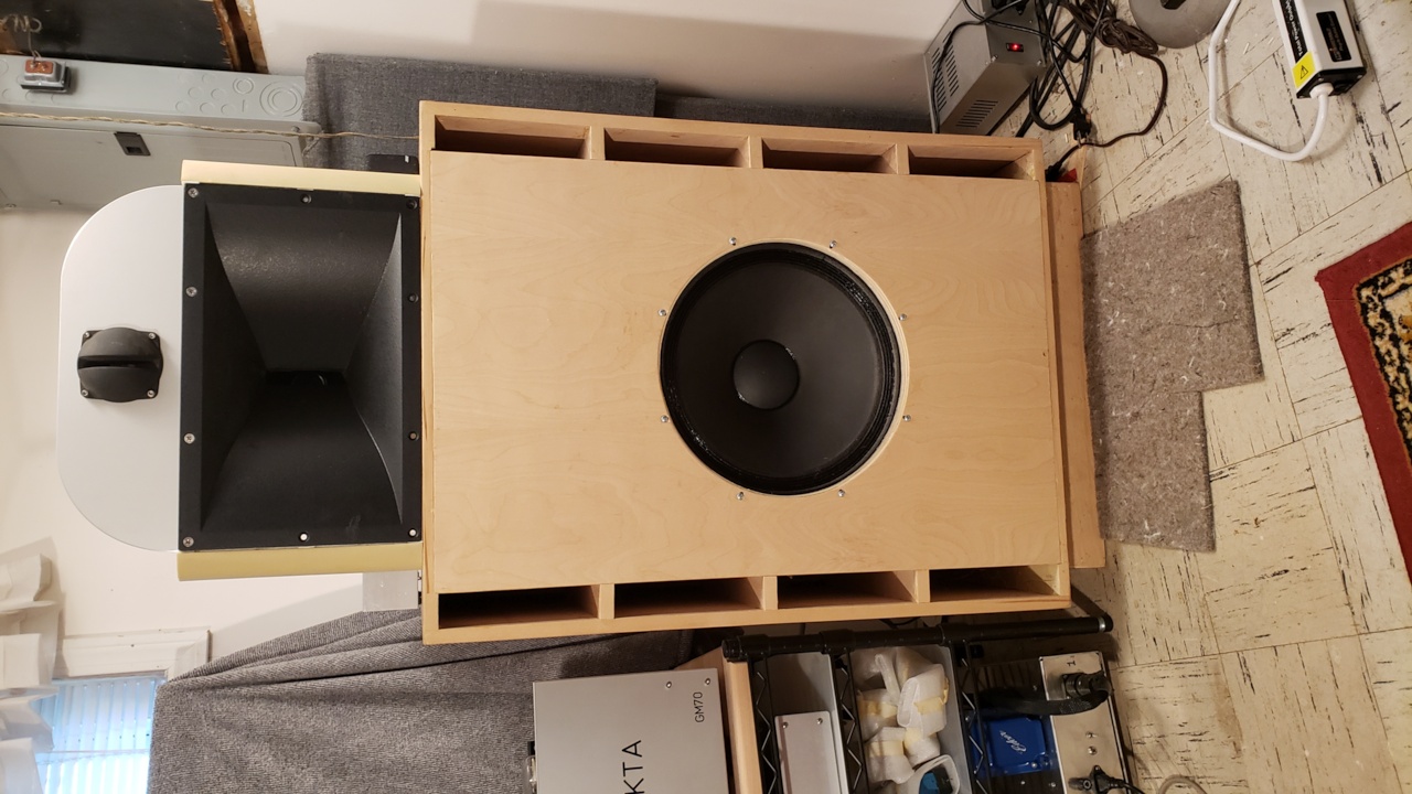

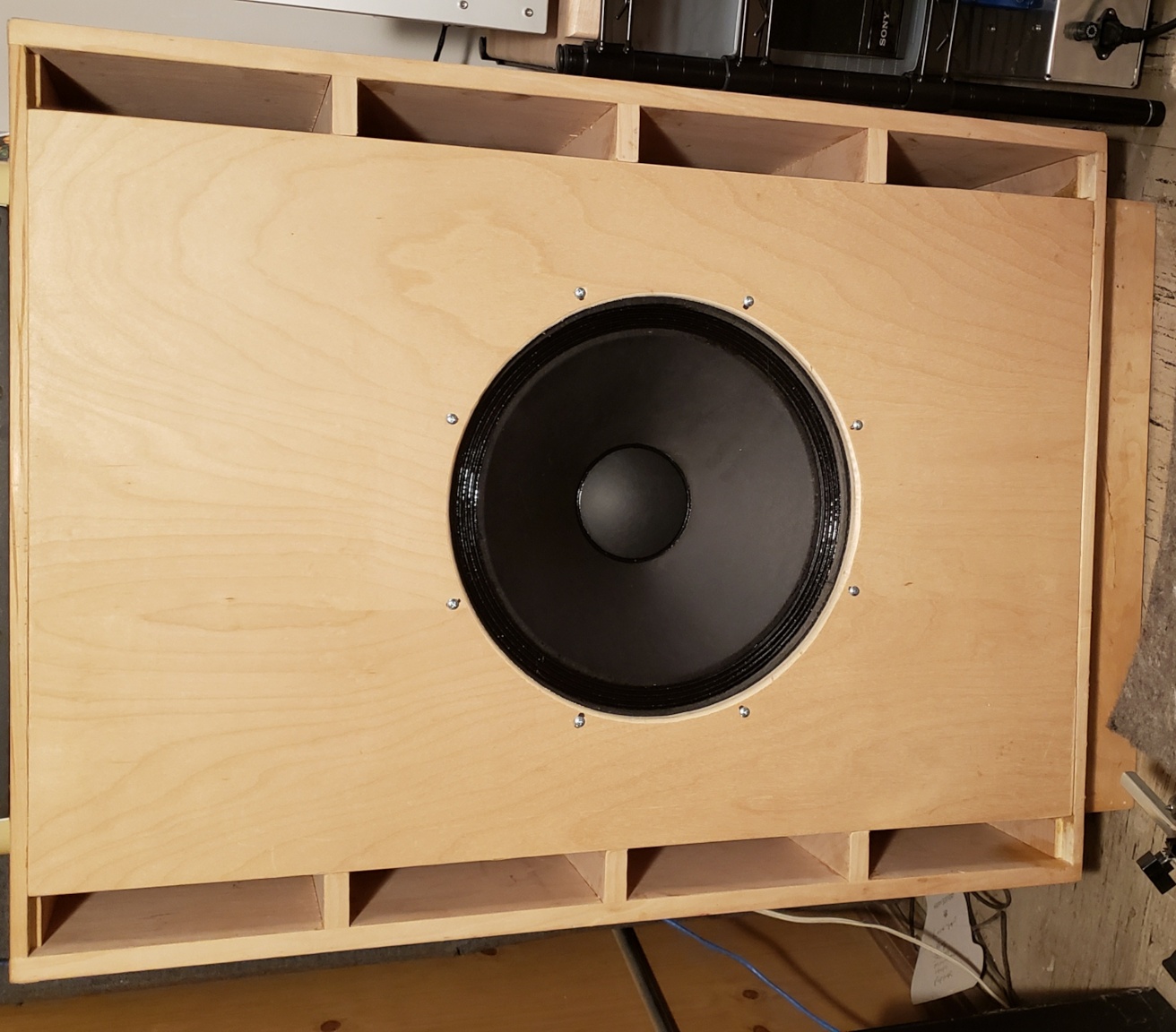

I will try to post a picture of my cabinets as an example of something someone here built and uses on a daily basis. (Coming up on 15 years in a couple of months IIRC)

See the attached, it will open correctly despite the sideways orientation. Originally I had intended to use midrange w/lens, and horn tweeter in the cabinet above the woofer. I ended up with much larger midrange horn on top of the cabinet with horn tweeter above that. The center to center spacing is not optimum, I currently cross at 700Hz and have crossed as low as 500Hz but did not like the result.
