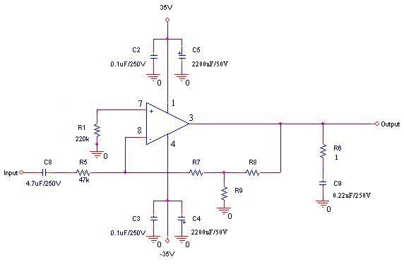

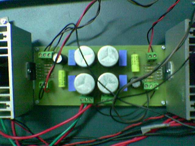

Yesterday I finished the T-network chip amplifier but some noise sound came from my speaker like "chi" sound. I thought it may be occurred from the volume because last time I applied this kind of volume (Alps 50K) to my old noninverting gainclone and also heard the chi sound from speaker same as this time. Could you suggest me other reason which may generate this kind of noise out? Thank you.

Thank you for the suggestion.
It's not cause from heat sink certainly because it's not hot.
For volume pot, It's a general volume, I will take it photo and post in this thread next time. I connected the PCB board to the volume via wire harness, this may be a reason of this noise 😕
That noise is continuous sound, not short duration.

Upupa Epops said:
Franz, if you can to get lowest distortion, impedances on both inputs of amp must be approximately the same 😉 .
Yes.
Franz, you can try 22k from NI to ground.
I decided not to change the input resistor, I use 10k on inverting input, so I will remove the multi-trim pots I used for test and use 10k from NI to ground.
I prefer to use smaller value resistors from NI to ground, that's why I've chosen these values.
Feedback is 4.7k/56R/4.7k.
carlmart said:
R1 should be 10K or adjusted for minimum offset.
Carlos
You are absolutely right.
The cause of the noise on gencard's amp is that 220k resistor from NI to ground.
EDIT:
Also, 4.7uf is too high a value as input cap.
It won't do much to protect eventual DC from the source getting in and being amplified 21x, the gain of gencard's amp.:bawling:
Franz G said:
Are you sure?
I am speaking about an inverting amp, so, the signal should not be influenced by the impedance of the noninverting input, imho.
Franz
Yes, it's an inverting amp.
The higher the resistor you user from NI to ground, the more noise you have.
Try 220k there and you'll see/listen to the noise.😀
You would have to use a small cap across it.
Matched impedances on both inputs are also important.
22k probably is not be ideal value to have the lower DC (that resistor value should be Ri//Rf, but on T-Network maby it's not as simple...).
Try it.
I prefered to mantain 10k as input impedance, you can try it too, but you would have to also change the feedback resistors.
