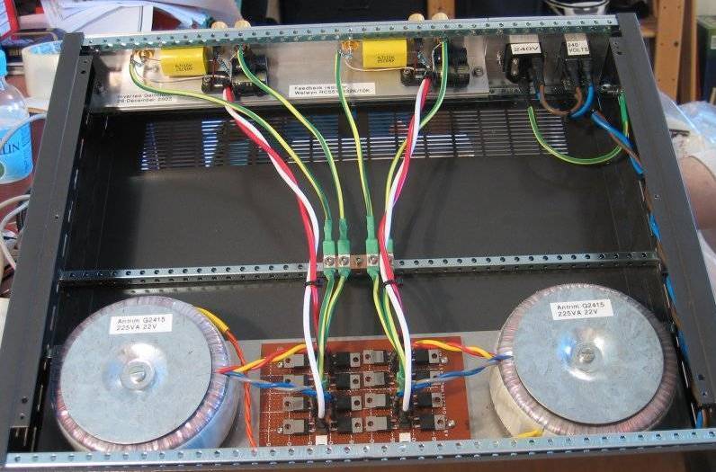

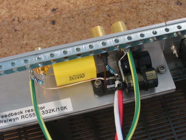

In your arrangement you could have signal star ground?
The little board on the right could be removed and the resistors also connect at the one in the middle.
From that little board on the middle (signal star ground), take a small resistor (1 to 2.7 ohms) to the power star ground.
The chips could be even closer this way, more silent amp.
Or you have everything independent (including PSU) or the ground should be only one.
I miss DIN plugs...🙄
Note: the right input caps would have to be side by side with the left ones.
And Nick, you use very thin PSU wires...
Use at least 1.5mm (I use multi-strand), and for ground, 2.5mm.
Thanks for your comments Carlos. 🙂
To clarify, are you saying that there is no need for a signal ground star for each channel?
Does that apply in the case of using a single signal ground star or where you have one per channel as well?
This amp is silent :att'n: There is just no noise at all even with my ear touching the speaker. No switch on thump or noise when the amp is powered down. I believe a slightly larger gap like I have in this case helps cooling too!
Point taken Carlos. I prefer solid core wires to stranded and larger diameter solid core wires are quite stiff and difficult to work with. I keep meaning to get some 0.8mm solid core that would be an improvement on the 0.6mm. Is this a safety issue or a performance issue?
Yes.
Both.
Yes, your arrangement is good, I believe in you.:angel:
That is true, but a thick heatsink would help.
Better to have a thick heatsink to avoid "hot-spots" than a thin and large one.

DIN plugs make the grounding arrangements much tighter and better. Single ground.
Performance.
Large currents travel through them.
And the ground is common, it should be the thicker wires (as you have).
Safety is not an issue here, I don't think those thin wires will put your amp on fire anyway.
If you like solid core, why not 1.5mm?
Everything made with solid core wire, well arranged and braced can be very good looking.😎
And it still has some flexibility.😉

Yes, I guess so. I am just a little worried about connecting such stout wires to those very fragile chip pins in the case of P2P construction! :att'n:
I may try 1.0mm next time though. That is the size of wires used for household lighting circuits in the UK (and I suspect Europe too).
I had no trouble connecting large wires to the pins, but the pins have been reinforced with the capacitor leads, so they form a reasonably solid connection point. The wires are also cut to the right length and cable-tied to support each other.
The wire is fairly thick probably about 2.5mm. I buy 5 core flex and strip the cores out, so I get indentical wire with 5 different colour insulation.
and most importantly Greg - you have securely fixed those caps in place. If the caps wires can move, you will most likely break a pin. 😉
Very neat work by the way! :smash:
Thanks. Everything ties together quite rigidly so I don't think a pin will break. 😉
