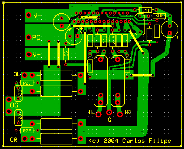

World record: one layer
Man, I have an amp with LM4780 on veroboard and you can't imagine the pain it was to make it.
The LM4780 has a really crazy pinout.
Anyway, tonight, nothing to see on TV...
Three hours on PCB Express and I got this.😉
BTW, not finished yet, it's late.
Very nice, Carlos! I could recognize the t-networks 🙂
And the mute circuit, in the upper right corner. Correct?
Franz

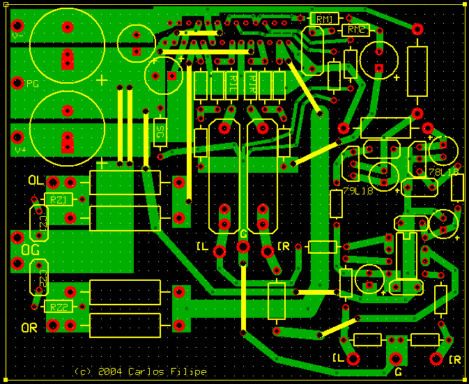

Franz G said:Very nice, Carlos! I could recognize the t-networks 🙂
Franz G said:And the mute circuit, in the upper right corner. Correct?
Yes, correct.
I made some small changes after posting it.
Basically I forgot a trace between one of the zobels, and also I changed the line that comes from "SG" resistor to go to exactly the mid point of the small square area (signal ground).
As I was doing the PCB, I lost more time thinking on solutions to keep it single-layer, than actually designing it.
This chip has really crazy pinout.
Not finished yet.
With (optional) op-amp input buffer.
And (optional) bigger PSU caps, as the small ones are for 100uf, for regulated PSU.😎
So... some small changes.😀
BTW, there are already more links than I wanted to, but there's no other way.
Single layer.😎
Not finished yet, but I'm too busy now, I'll finish this soon.
Single layer.😎

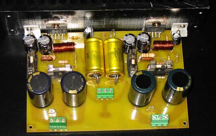

Another IGC .
I finally completed my IGC board. It uses a T network feedback scheme.
The feedback resistor is 100K and the output divider is 2.2K and 75 ohms.
Offset is L ch -18.1mV and R ch +2.1mV. At 68Deg C heatsink temp the offset was L ch -19.6mV and Rch +1.2mV.
Ambinet temp 31deg C. Heatsink temp after 15 minutes ( no signal) was 42 degC . Playing loud music for about 20 minutes with an output of 25 volts peak into 8 ohms speakers ( Mission 701) caused the heat sink temp to rise to 74DegC . That is hot !
My heat sink was 150mm long , 50mm high and with 25 mm long fins ( 20 fins). So I guess a 100 mm tall sink should be fine.
Supply is 4700uF followed by a fuse and then 470uF at the chip . Tracks are not exactly short but it does use star grounding. I think the layout is too big and not very well done. I'll improve on it for the next boad. The large fuse holders are a real pain. I couldn't find any vertical mounting types.
I found that it does sound very clean but harder than my reference amps which are very good . One is a Sherwood and the other a Luxman.
Transients are however very tight and have more bite than my reference amps. Voice unfortunately gets hard as the volume is turned up ,in comparison to the reference. I have not yet connected the tube buffer stage. At high volume and very busy tracks I get a spitting sound which is clearly audible at 60 deg off center from the tweeter. It is HF trash which I should try to look at on an analyser. Voice even at low volume does not come close to what I'm used to from good tubed equipment. If my memory serves me right , the voice doesn't sound as good a Bryston 4B power amp either . I'll have to run in the amp for at least a couple of days to determine how it really sound. The hardness in the voice might reduce or disappear.
Maybe things will change with the buffer also.
I tried a 6922 cathode follower with a CCS and also as a standard gain stage . Both sound good and I found it hard to differentiate between them. If I HAD to choose , I'd pick the cathode follower.
Cheers.

Ashok, well done with your amp but I think there are a number of things that you could do to improve the sound.
Using just 1000 uF caps right on the pins and (as you said) using a nice tight star grounding layout, getting rid of the fuses and those electrolytic caps and using a good quality film cap for the input.
But you do have something to build on and make comparsions with so the exercise has been worthwhile. 😉
Hi Nuuk,
Thanks for your suggestions. I was aware of the 'nasty' fuse location. However since there was no other protection , the fuses would do to start with. I can make a fast acting relay to cut off the speakers ( or short the terminals ) in case of DC problems. Contacts in series with the speakers is frowned upon. They however do protect expensive speakers or difficult to get speakers . I have goofed before and I prefer to be on the safe side.
The fuses can come out and probably be on the trafo primary side .
I will try 1000uF at the pins. It might improve the transients further . But I am not sure how the bass would sound. Right now I do get bass but it sounds a bit lean. The -3db point is about 12Hz.
I think there are quite a few things that I can do and I have one reference unit to compare by. It worked out pretty cheap. The most expensive part being the toroidal transformer.
I just tried the cathode follower with the amp. It sounds practically the same . The HF tizziness does not go away. So I will now include an HF filter and see what happens.
I have used a Zobel ( 10 ohms, 0.1uF) and an output inductor wound on a 10 ohm resistor.
On to the next board now and tweaking on the existing board.
Cheers.
By the way those input caps are Jensen Aluminum PIO's. I found them to sound cleaner than the Wima film (MKP10) and other poly prop caps that I have. We've been testing the PIO's against several other caps. Unfortunately the PIO's did sound better especially in the lower level signals. I didn't want it to turn out this way because of their cost. So you might say that we did the test biased against the PIO's! But they won.
