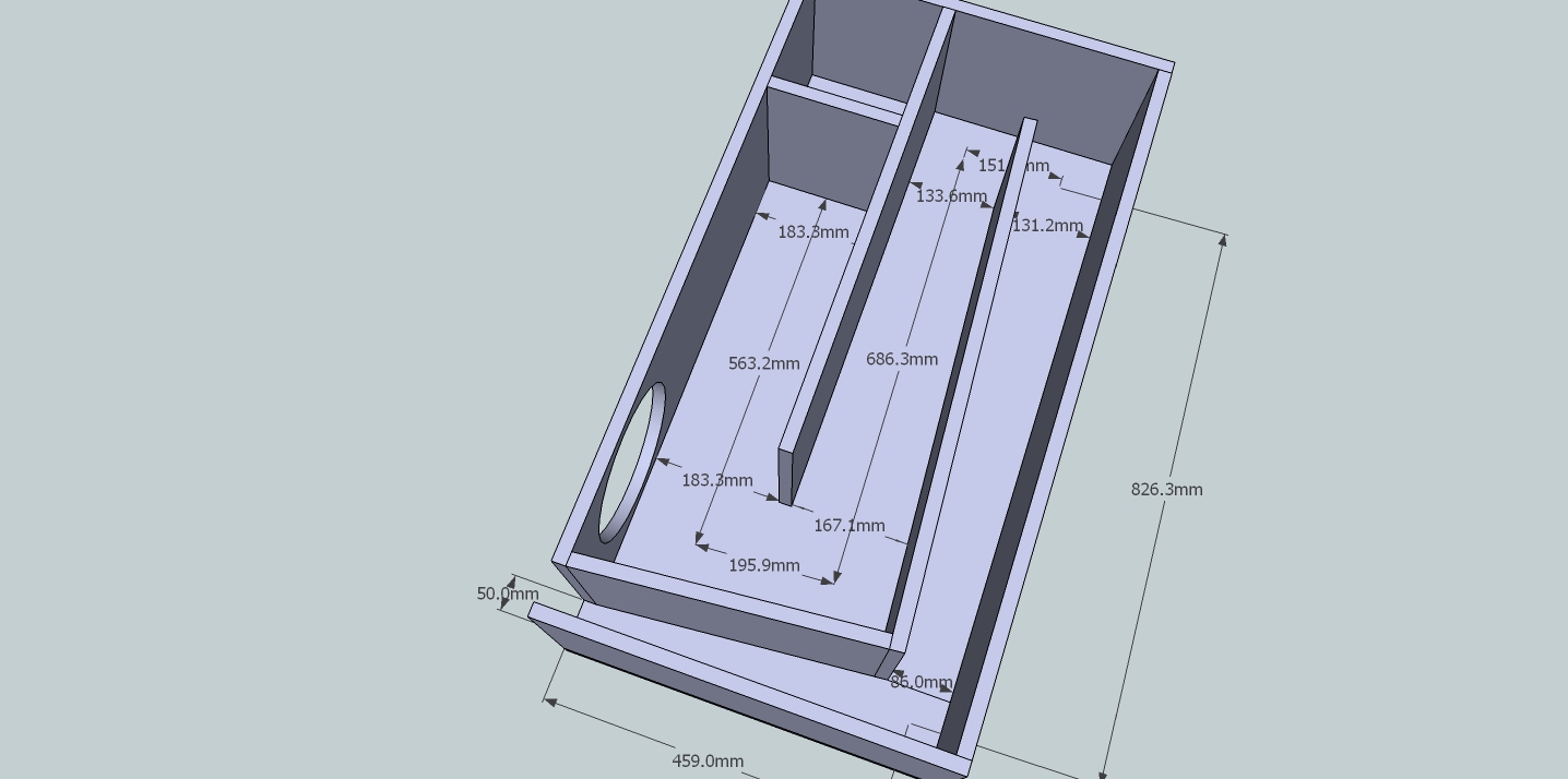

Long story short: I plan to build a suboofer using Dayton SD270A-88 in a transmission line enclosure for deep and tight bass. The sub will be used for music to complete the spectrum of my two bookshelfs wich lack the low octaves.
The thing is I have no ideea how will it sound since I tried to use Hornresp but I don't know what all those parameters are. If someone have 5 min to spare and simulate that for me I'd be very happy.
The line is 2.8 m, cross section is a bit tapered from 375 sq/cm to 340 sq/cm.
It will be filled with wool acording to the best sound.
So what do you think?

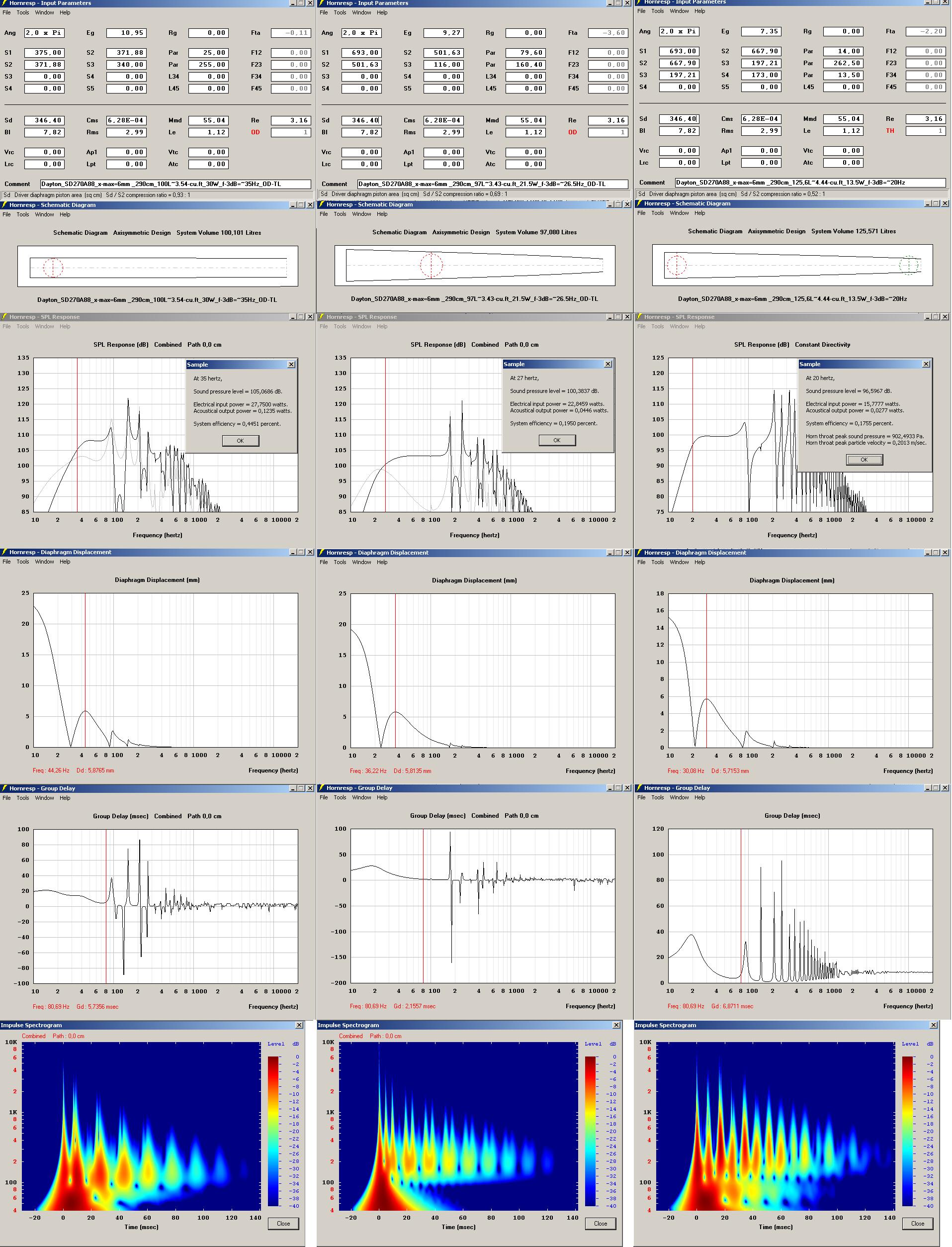

I think tour TL-line have an adequate length and total volume but :See the first of rows in the submitted picture then compare with the other suggestions where more BW is traded from SPL and to a smoother in-band phase/gldy.
If you fill your design with damping material: The BW will decrease further with a slope starting ~at 60 Hz, thus moving f3 above to 40 – 50 Hz.
b🙂
Thank you so much for your response, very useful info.

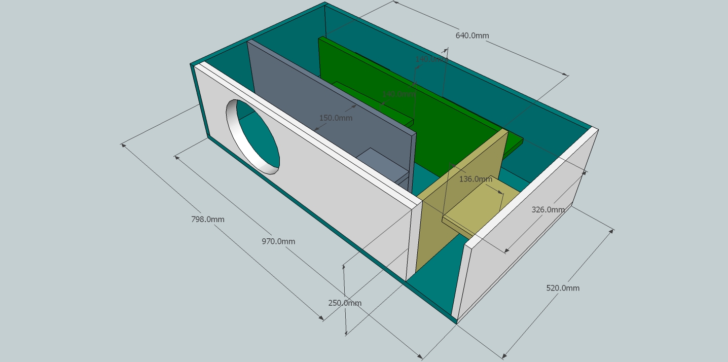

The second graph in your photo looks a lot better than mine, good spl/f3 compromise. I redesigned my line but kept the outer panels same size since they are already cut. I hope this will generate a better response than the first one. I had to cut 20 cm of the line sice it became to long.
What do u think?

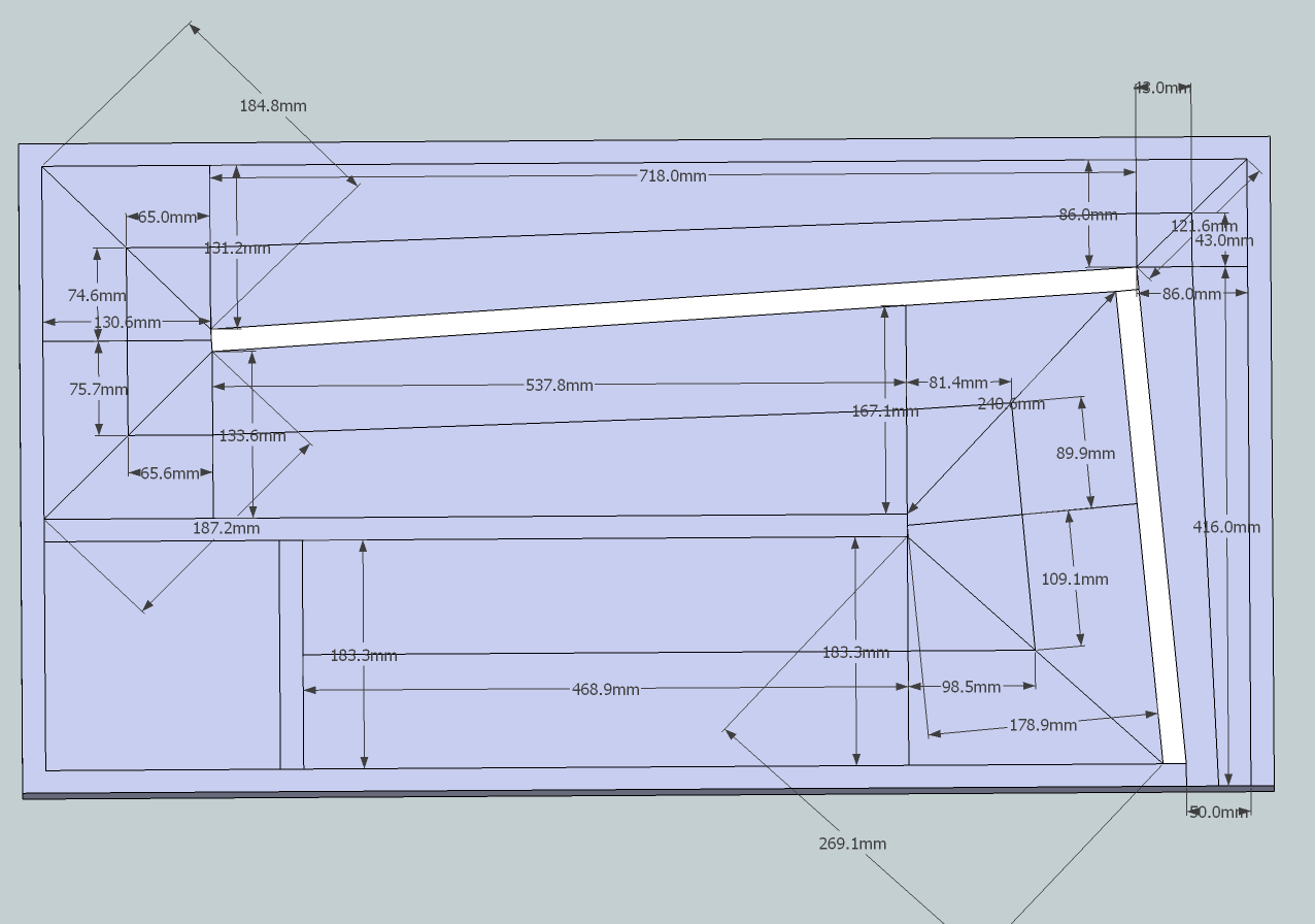

blackbird84:..This is how I think it should look like. Something missing?..

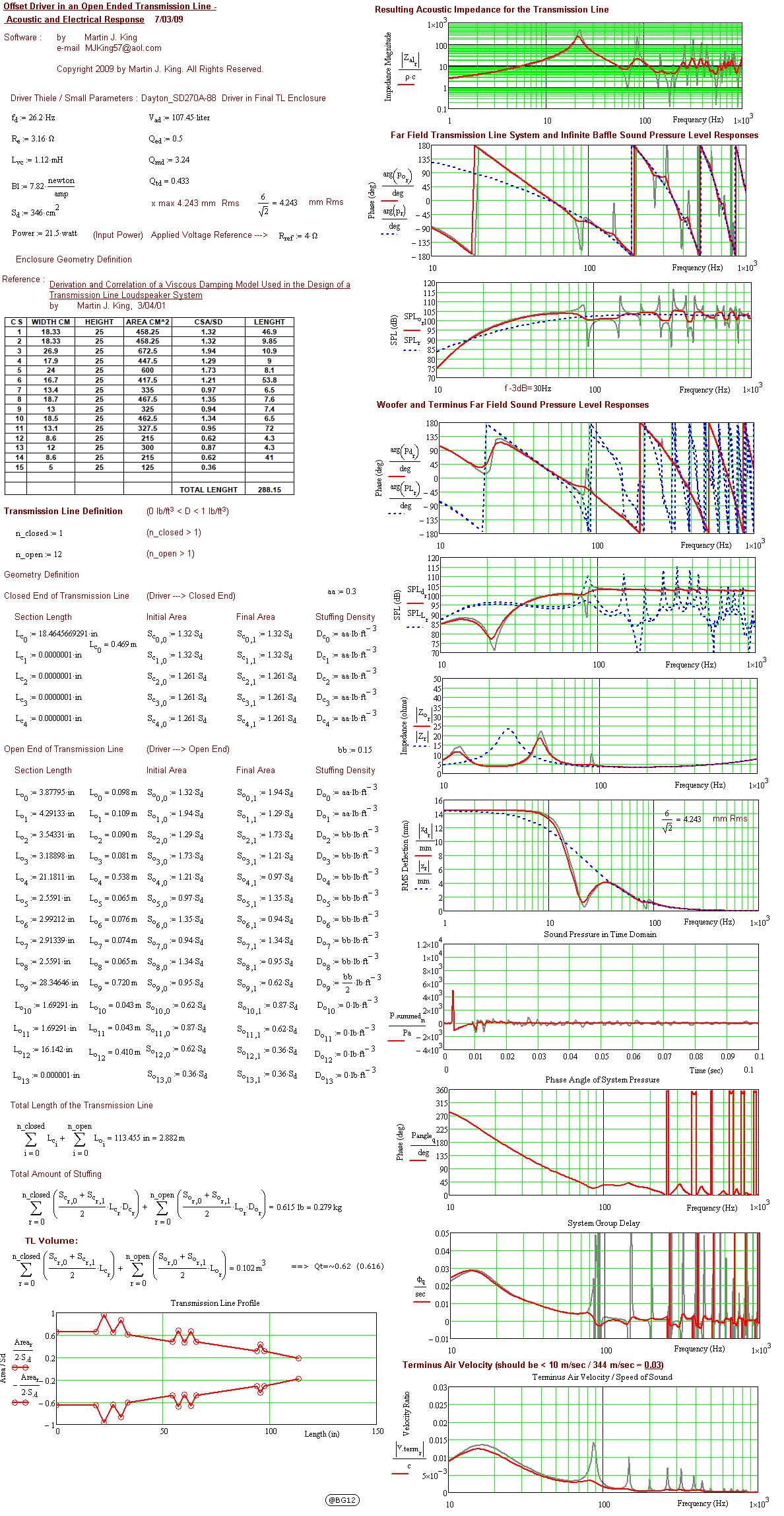

Thank you:This is quite adequate! This evening I will start entering this into MJK:s program..

Thank you for sharing your knowledge and time. The response graph looks good to me, tomorow I'll start the assembly.
