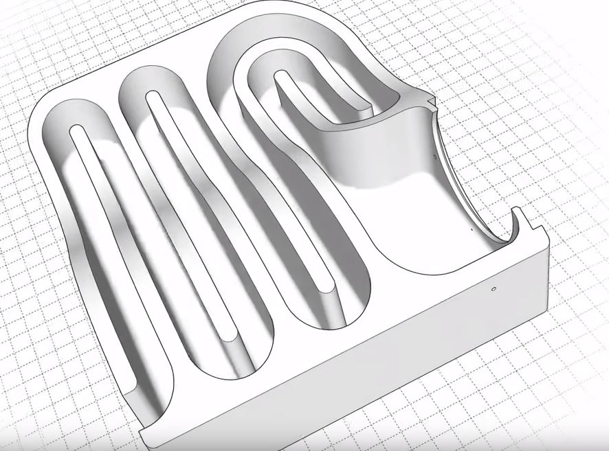

TLines, (or bass reflex) enclosures, how would i look into sizing something like the photo?
This particular one the gentleman used bass box pro and 3d printed an enclosure for a small 3 inch sub, but i was thinking of its application for a small boombox.
i did find some posts from 2010-2014 on here and one had a spreadsheet, but i dont know if it is for the same application.
There was a number of taper selections but 1/11 was what seem to produce the smaller box, but i honestly dont know what that actually represents, it would be great to see a picture of what the internals would be. The required length was about 80cm which seemed ok and the FS around 60hz, which is what i would be chasing from a small 3.5" FR driver.
I've made a small T-Line once before by copying a design on here, but dont know what was done to size it and it had about 2 folds, which not sure if that satisfied anything. It sounded good, but lacked those lower notes.
If there is any direction it would be greatly appreciated, if i can picture something in my head and get some idea into sizing (keeping in mind im a noob, not audiophile) i can start trying to CAD up some options.

Ok, that was just an example as there has been generally some confusion as to what that actually is, ie rear loaded horn, maze, transmission line etc
I guess I used that as a poor example, but thinking the was a straight fold TL. I will take a screen shot of the spreadsheet, but don't really know what a 1/11 taper is, I've heard of 1/4 wave and wondering if there is something lost in translation as I think it may have been a Dutch original.
There's no technical confusion as far as I know, just that there is a lot of misinformation out there.
1:11? Using conventional notation, that would imply an expanding line (horn) with a 1:11 throat - terminus expansion ratio i.e. the terminus has a CSA 11x larger than the throat. Assuming whoever wrote that got it backward, it means a contracting line with an 11:1 taper ratio, i.e. the throat has a CSA 11x greater than the terminus.

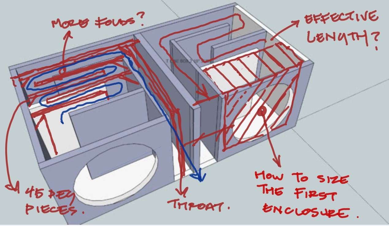

What would this be? I thought it was a TL.
On the assumption that it is,would I need to size the first enclosure? Ps this was called a transmission line for a subwoofer and I have just scribbled on it, so please pardon the mess
Technically ducted port since they have well defined low pass filter chambers and constant area 'vent', so can be designed using a basic reflex calculator such as is one of many types of alignments in Hornresp.
If it was inverse tapered from the top to the bottom, then it would be a TQWT.
The difference in path length, was possibly to not have two ports with interfering output next to each other.
Good idea, bad implementation, and setup is wrong in scope and intent to care about stuff like that.
With such small initial chambers, bass frequencies output, is still going to be directional. You'd want the port out the sides ideally.
For a boombox type setup you'll want regular BR ports, or other restricted tuned vented cabs (aperiodic etc). Or possibly even closed with the right size cab and driver type.

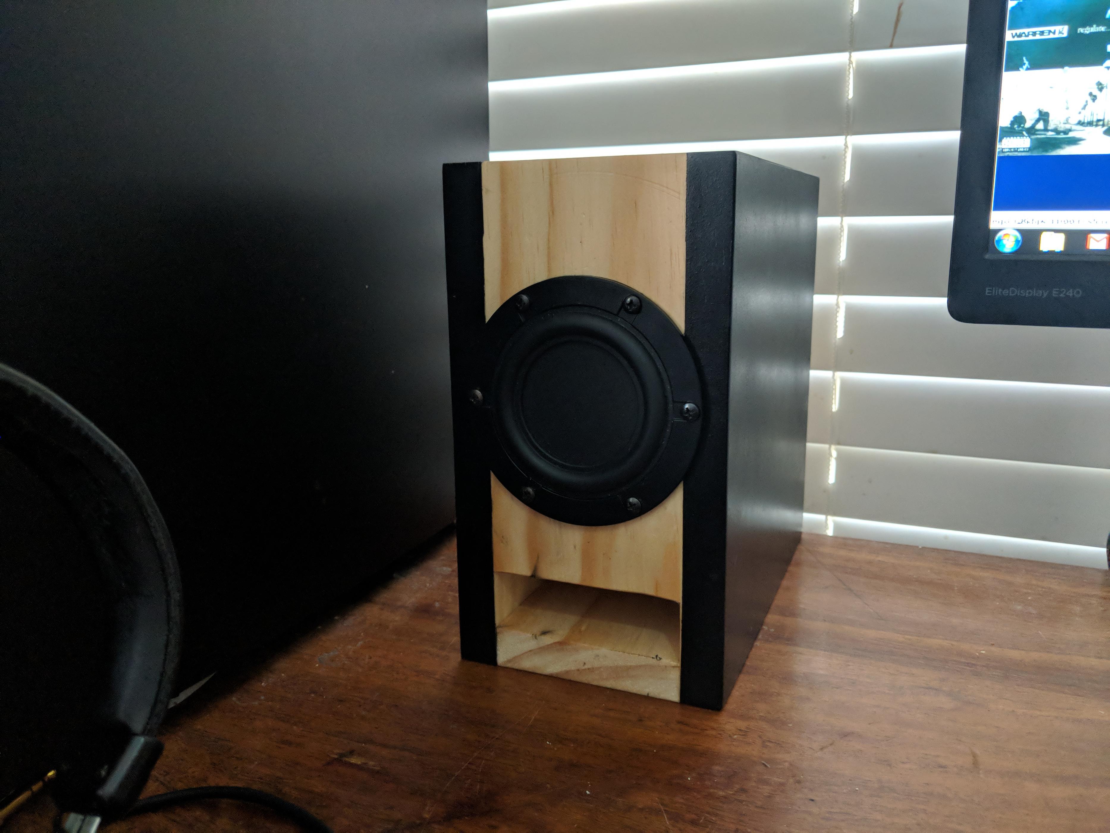

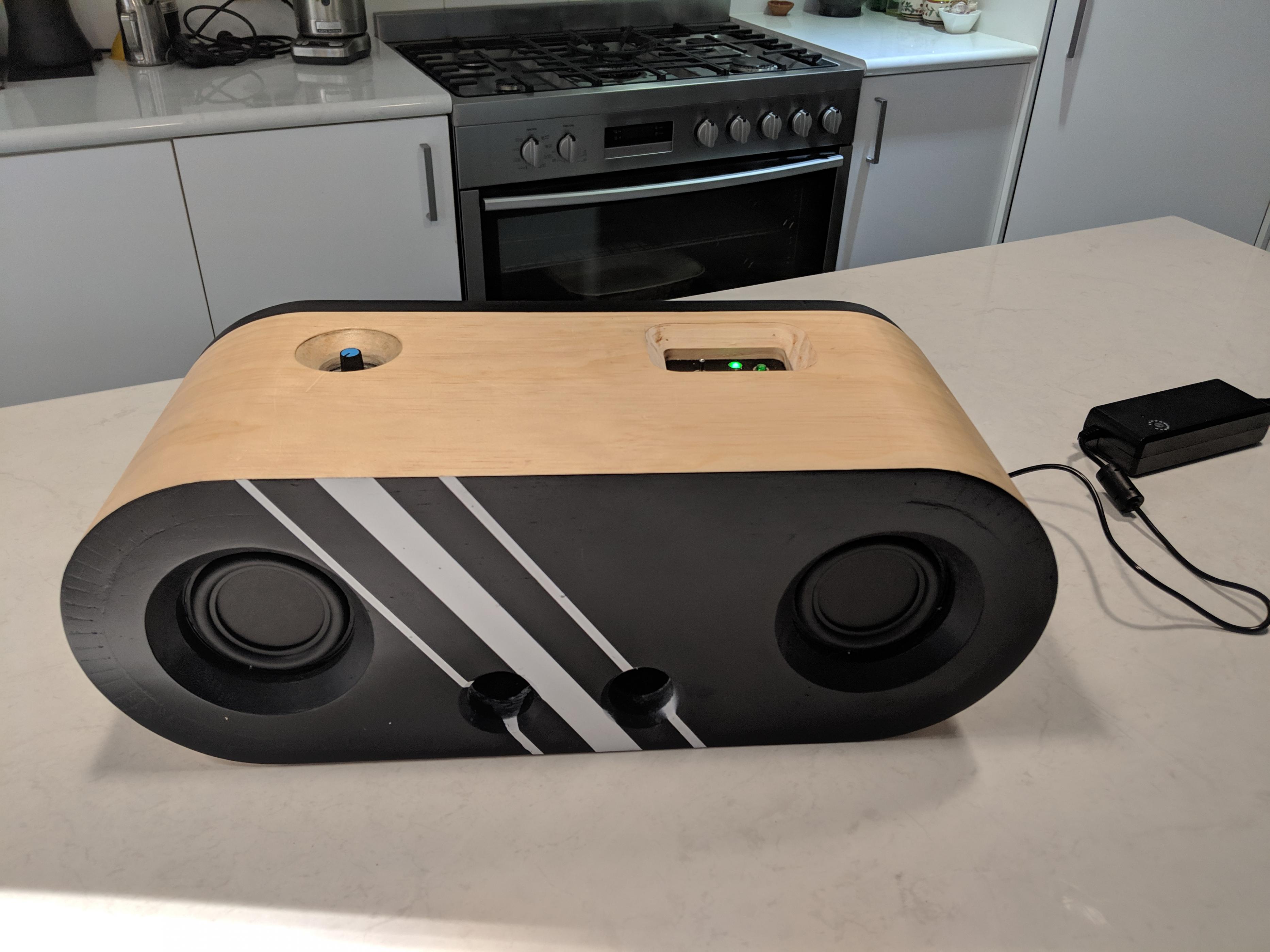

ok, ok, ok, look i always get caught up thinking that maybe i can grab a router and carve me out a maze/labrynth arrangement, or build a proper t line one that actually lets me hit those notes around the mid 50's out of my 3.5inch drivers.
But from what i've been reading outside of this forum, the time you calculate your length required, take into acount wood thickness and the intial chamber, a transmission line may not be as small as i thought. Using an online calculator it would appear that the travel length needs to be around 700mm+ long and i have no idea yet what the inital chamber has to be to cater for 2 drivers.
I'm not too concerned about weight to be honest, just wanted something smaller than my first boombox which ended up being about 450-500mm long. It sounds pretty good for what it is. What got me going with a bit of wood working was the T-Line i just copied from this site, based on the same driver and measurements, it did a nice job, (lacked a little in the lower end), until i lined it up against a vented 0.18cuft enclosure which blew it away (tuned to a FS of 58hz). All to date has used the TEBM65's which i actually like.
On another note, i've researched isobaric, which most information to date only seems to relate to sub woofers and cars, Linkwitz circuits, which look to be only sealed boxes, stuffing the box, which seems to reduce the Q, smaller vented boxes, mazes, bass reflex ports, T lines and honestly completely confused. Most Youtube out there is geared towards subs, where if there is a TLine or maze, it is japanese and listening to classical music, which isnt what i would be listening to.
Just really want to make something smaller (at least 1/2 to 2/3rds the size of the bigger brother), which was tuned to around 60hz, that sounds thumpy when required, not caring if it weighs a kilo.
