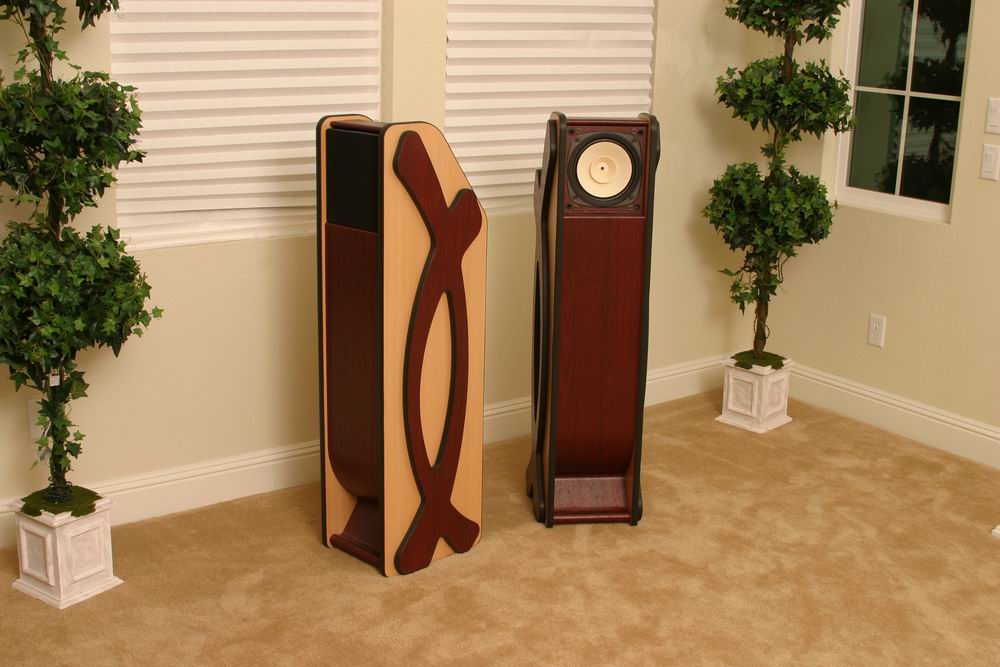

Hi all, what do you think? There must be a home for it somewhere...

Thanks to all that viewed about the T-Horns. I had many interesting questions & comments, but no bidders, even no replies to this post. What am I doing wrong? Bad design?

To an audio nyophyte, that driver is not terribly pretty and looks dated, but honestly I think you're asking to high a price. For $1500 a DIY like me could build something more matching my tastes.

BEAUTFUL JOB. i agree the speaker isnt that perdy im not too wild about the design on the side. but the two-tone is plenty nice. as a diy guy the price is way high for me, but definately a beautiful set of enclosures. great job.
on a side note. how did you come up with the layout for it.

- Unlike conventional folded horns with stepped / straight internal curves, the entire length of the 6-1/2 feet exponential horn is perfectly smooth, free flowing path enabling unobstructed motion of sound waves
This still has to be proven... 😉
Anyway very nice/professional woodwork even if I'm not a fan of this kind of finition.
Seems to me that this kind of "back horn" design obliged to place the speakers far from the rear and lateral walls. This obliges your customer to have a (very) large listening room.

I've always thought your design was intriguing. Yes, that seems a little pricey. But is it worth it? I don't know.
I think it would definitely help if you had response curves, etc. in the ad so they knew what to expect. Especially for that kind of money. How much power does it require? How loud does it go? What are the benefits of your design? Have you compared it to anything similar in price on the market? You get the idea.
It could be the best sounding speaker out there. But, it's an unknown to pretty much everyone what that box really is and does.

Thanks guys for all the constructive replies;
The design, I thought it would be good to come up with something a little different from the ordinary square boxes.
The layout is basically like a Buschhorn concept; my question still is which is better, front or rear facing horn? I'm re-drawing the T-Horns because loss of data, long story 🙁
Maybe I could be the 2nd DIY Horn shop from the garage....
IMHO I already gave you an answer :
Please read "rear facing horn" instead of "back horn"
I'd say this is not necessarily true, note the Hornshoppe Horns. Some rear loaded horns are made to be put near corners to enhance the bottom end. Obviously careful balance is required, but a large room isn't a necessity. However, I would say it somewhat requires available corners. Then again, I could be wrong about that.
In general, I think front firing speakers, be they rear horns or bass reflex, are easier to place than rear firing speakers. Then again, I'm guessing the speakers in question would have a different flavor if they fired out the front instead of the rear. Only one way to find out...
Maybe I can try to build a pair with front facing horns to compare in the future. In anycase, the bass (rear facing) now is very surprising and impressive; rattles the garage walls and sink.
I will stop after this one because it starts to be over my poor knowledge and understanding.
Seems to me that, unlike TL or vented charge, the horn construction hasn't for only purpose to improve the low-end response.

It is a good project
Layertone:
I believe that it is a good project and IMO the price is correct.
Personally I don’t like the lateral decoration but I like the general aspect.
The constructive system is similar to this?
http://www.spnet.ne.jp/~hasehiro/product/backroadhorn.html
I always liked because it has a very smooth route.!!!!!
I have a horn with mouth backwards and am satisfied, but the room is 6.00m x 4.50m.
The horn has many cavities. Exists an opening to fill up?
