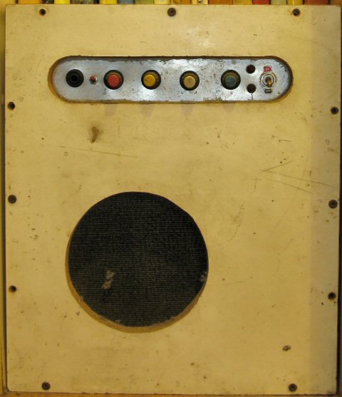

Yes, why not, it'll probably make better use of your battery than the 7 Watt TBA810S one I built about 15 years ago, but you may want to include some kind of sound shaping like a Behringer V-Amp or Tech 21 SansAmp at the front end as the overall sound will probably be a bit too clean and clinical for guitar.
TBA810S busking amp with 15 4AH nicads:-
w
