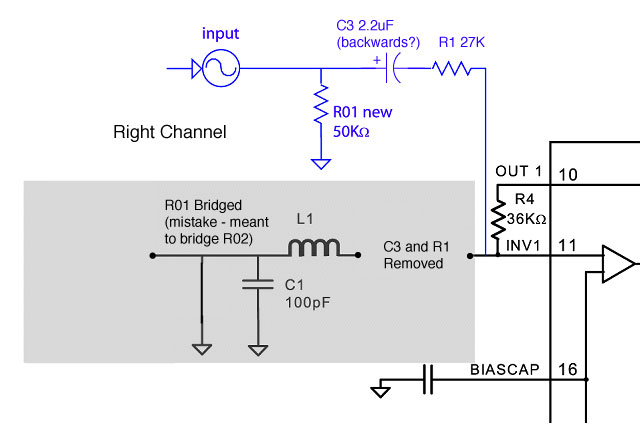

oops - after looking at the schematic I notice I got something wrong.
I wanted to mono-block the amps, and use the right channel. So I should have grounded out the input to the left channel, which is R02. I don't think this grounding out step is really necessary - it was just a precaution, and the other one seems to be running fine this way. As R01 is "behind" C3 (which I removed) bridging R01 should have no effect whatsoever.
[/B]
If you removed C3 then you may be shorting the 2.5V to ground. Did you check DC offset? If you have a resistance to ground, or a short, on the 2.5V side of the cap you'll get DC offset and that channel will use a lot of power.
On the unused channel you should just leave everything in place and tie to ground before or at R01. If you removed C3 and did any shunt to ground, that would not be good.
Maybe I didn't understand what you did. Can you post a sketch of your wiring diagram?
Wiring Diagram/Further Error?
Ok - here's the wiring diagram of the input of the right channel.
After reading another thread, I'm a bit worried that I may have put in my input cap backwards. Is this the case? Might this be the problem?
Also, I've measured the DC offset. In the cutting-out channel, it starts at about 60mV, and starts rising slowly... after a few minutes (didn't time it) it was at 400mV, and I shut it off. I checked the other channel, and this one started at about -60mV, and exhibited the same slow rising... hmm - yeah... this doesn't look good - I guess neither channel is working properly - as soon as the one channel has cut out, I turned off the (common) power supply right away. I would imagine the other channel would cut out as well if I would leave it on long enough.
Does this set off any warning bells? Could this be caused by a backwards cap? I only hope I haven't damaged my speakers too much...

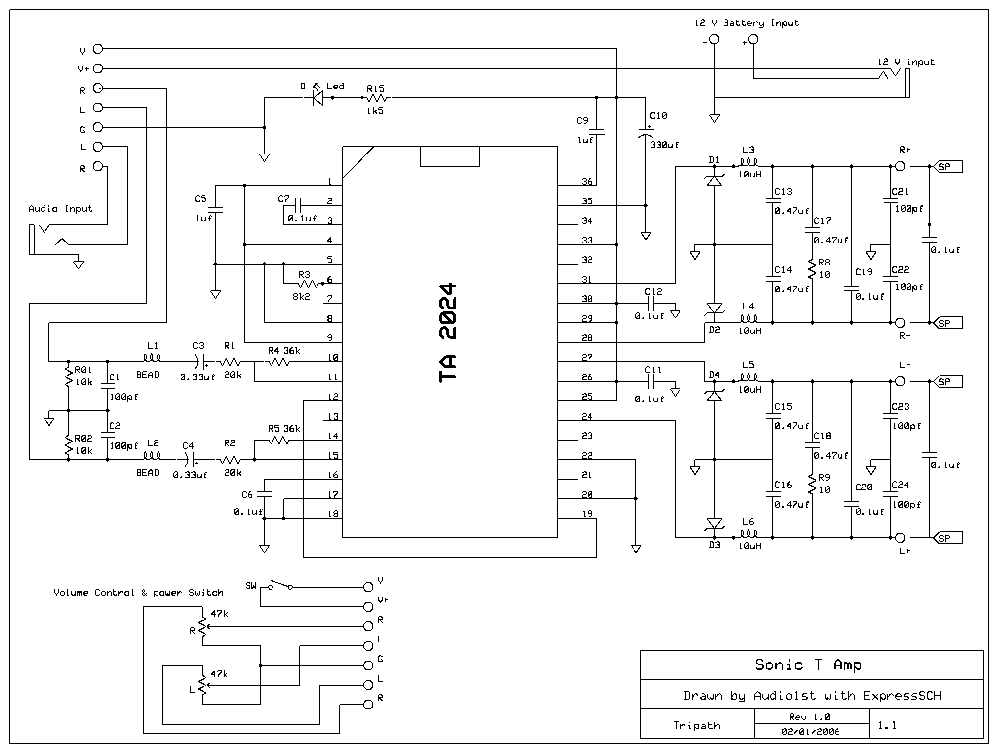

You seem to be getting your channels mixed up.. R2 is the left ..
Also is the resistor or the cap' connected to the board? They should be connected as in your dia'..
The direction of the cap is dependent on the source voltage, over 2.5 V, + to source, under 2.5V, - to source.. I think?
Here is the original cct of the Sonic T..

audio1st - you're right - I was confused about the channels. The pad of R1 is where I've put the input.
And it is indeed wired as I've drawn it - input RCA (with 50K to ground)->2.2uF->27K->R1 pad.
I've just measured my source - it puts out -6mV? Am I doing this correctly? I plug an RCA cable into the analog output of my DAC, and touch the positive lead to the centre pin, and the negative lead to the outside bit, right? Does the DAC need to be loaded or something before it puts out a higher voltage? Anyway, the manufacturer claims the DAC puts out "2.17V RMS at 1KHz Nominal (for 0dB digital level)", which seems about right. Which also means I've probably put the input cap backwards... Could this cause a drifiting DC offset?

The rising DC offset is a new one to me, never seem that before. But I guess it could be caused by a reversed electro cap.
If you are using a polarized cap, then the + side goes toward the amp (R1) and neg does toward the input (DAC). So have a look at that cap.
Your diagram looks correct. Don't worry about any DC offset on the DAC, it will be blocked by C3.
Ok, my cap was backwards. I've swapped it's polarity, and now we have something just as strange, but probably better. :)
The channel that was previously not working, starts at a DC offset of 60mV, and drifts downwards, seemingly settling at -4mV after about an hour of operation.
The channel that was previously deemed working starts at DC offset -110mV, and quickly difts to a fairly stable -113mV.
