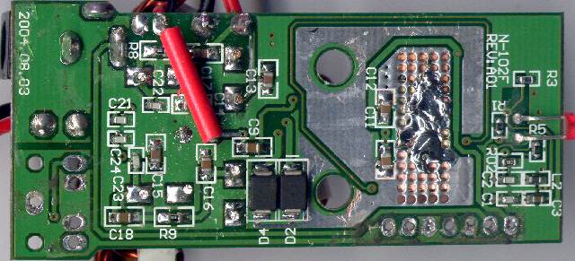

I'm also planning to apply the stealth mod to my t-amp, for that I just ordered 2x Mundorf-MCap 2,20 uF 400V, 3%. Those are made for crossover building, but I suppose them to work, or did I miss something ?

ciorbarece said:should I take those cables leading to the batteries an put some adapters on them and connect those with the 2 cables from the voltcraft ?
Yes. You should also put a better electrolytic onboard (C10). When you do, jump the positive leg of the new cap over like in the photo below. You'll see that i have slipped a bit of red insulation over the cap lead.
This jumper gives a more direct, lower resistance path from the PSU to the supply rail.

You will need 3 caps. 2 for the inputs (left-right) and one electrolytic onboard.
