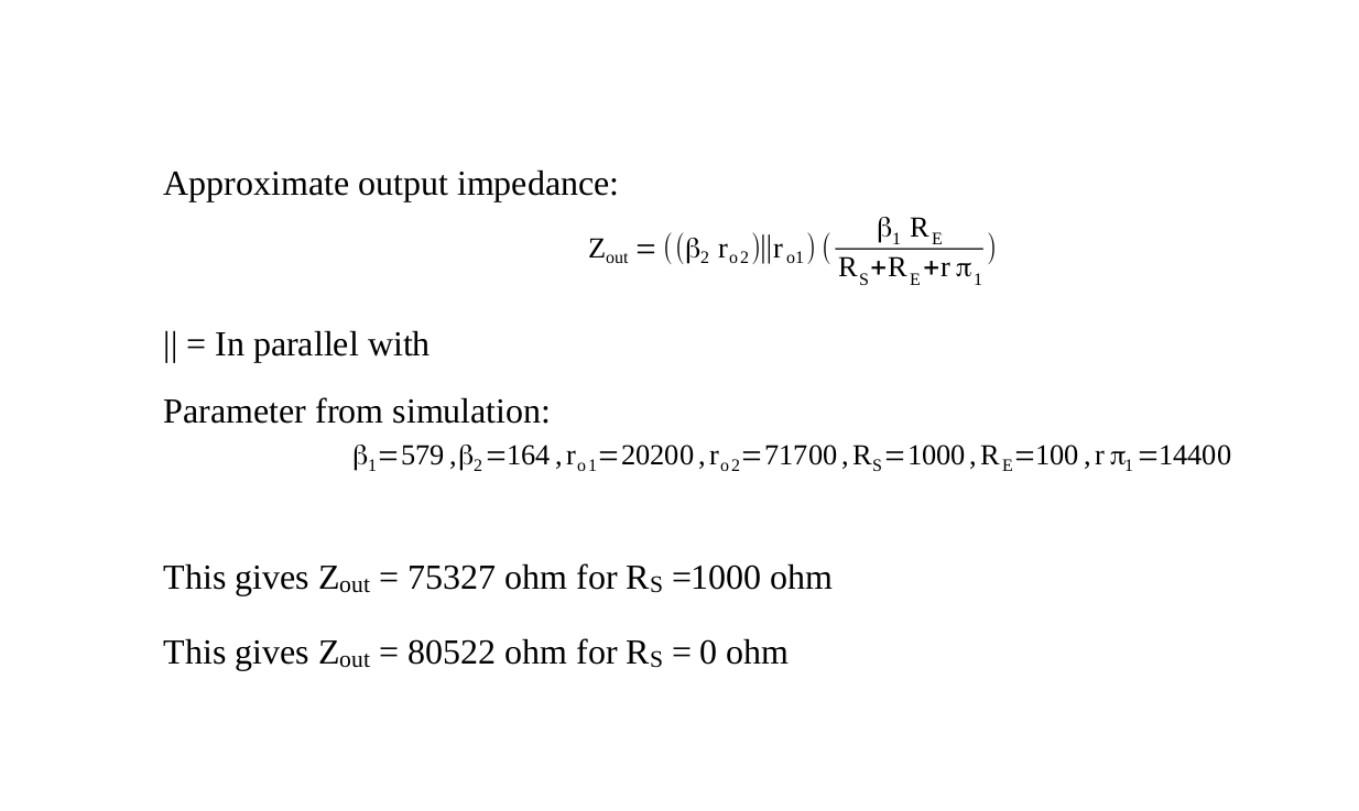

Here is my approximate expression for the output impedance, RE is R7 in post #6, while RS is R7.
