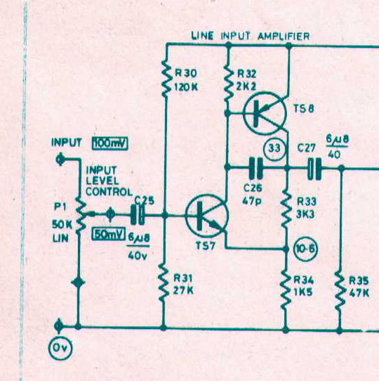

beppe61 said:At the cost to turn out monotonous I am attaching an example of
sziklai pair.
I would like to replace the input bjt with a nice fet and so avoiding the input cap.
Thank you for your patience.
Kind regards,
beppe
I would also point out that this is not a Sziklai Pair. What that is is two common emitter voltage amps in series with a NFB loop.
The Sziklai Pair is a Darlinton-like arrangement which uses an input NPN with a PNP to simulate an NPN transistor and vice versa. It's the same idea behind the quasicomp topology, except that there are two of them. This topology has the advantage of better temp stability since there is just one V(BE) drop to contend with instead of two. Since it also has local NFB, it's supposed to have improved sonics as well. Some folks do indeed report that this is the case. (Of course, whether this is simply a self-fulfilling (no pun intended) prophecy because Doug Self said so, or not is a whole 'nother story.) There is a price to be paid for this in that Sziklai Pairs tend to instability.
Sziklai Pair

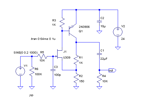

beppe61 said:Dear Mr. Alex,
may I ask you wich software have you used to simulate the circuit ?😉
It is free LTSpice/SwitcherCAD III, available from http://www.linear.com .
I would like to ask you another thing.
Do you think that "playing" with the value of R1, R2 and R3 and/or the V2 value it would be possible to get an even better distortion spectrum ?![]()
In a simulation it looks possible, however I never tried it in real life. Would be interesting, thought.

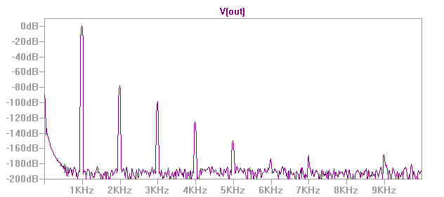

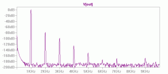

Beppe,
here is a possible schematics and results of FFT simulation for 1V RMS output - the gain here is about 7. I did use similar gain stages in the past and if you have time to select JFETs, it could be a very good circuit.
Input here is directly coupled, however in real life you may decide to add a simple RC filter to remove RF, say 10K and 100pF.
Cheers
Alex
P.S. - I've edited the schematics to add the filter.
