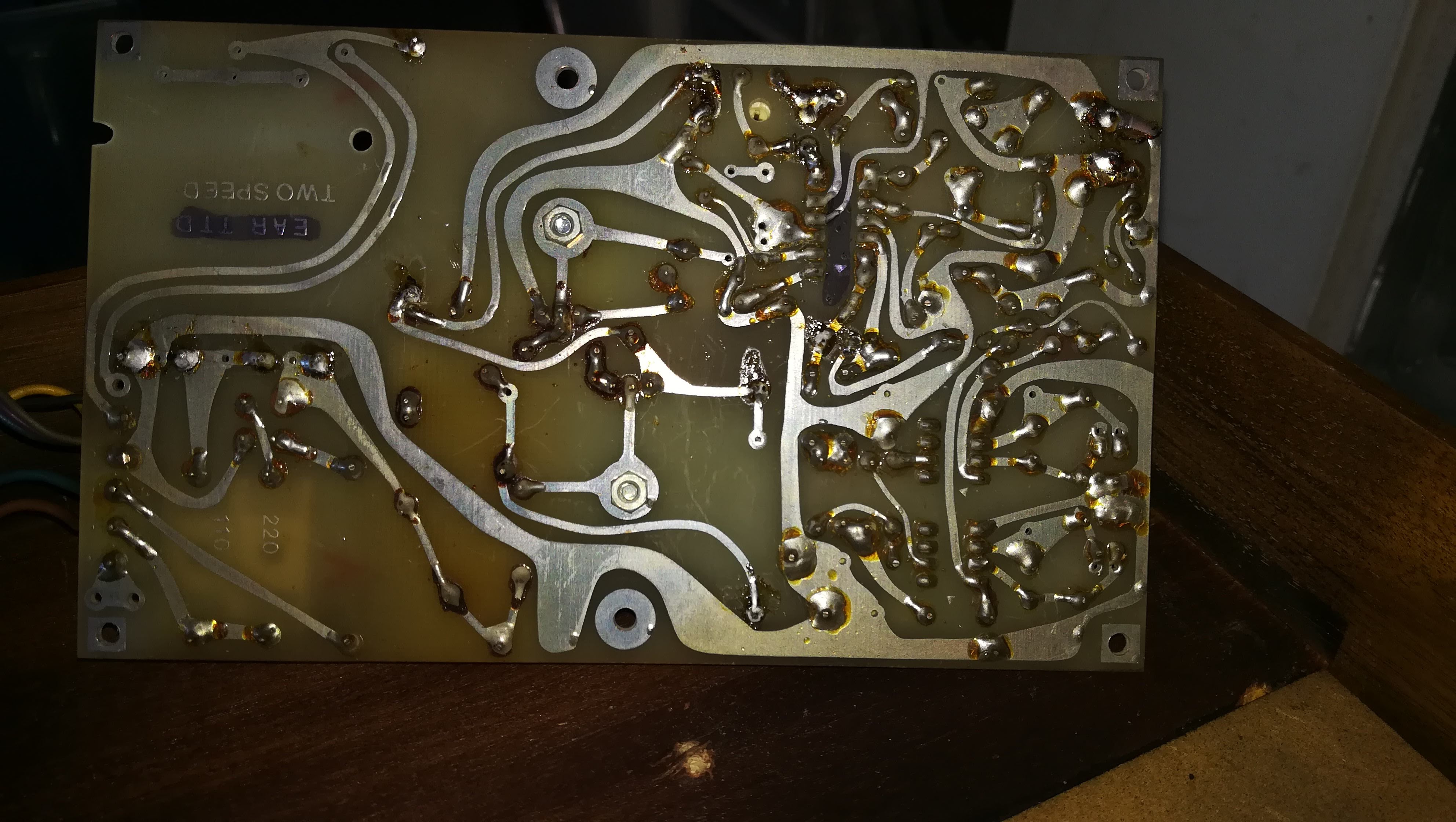

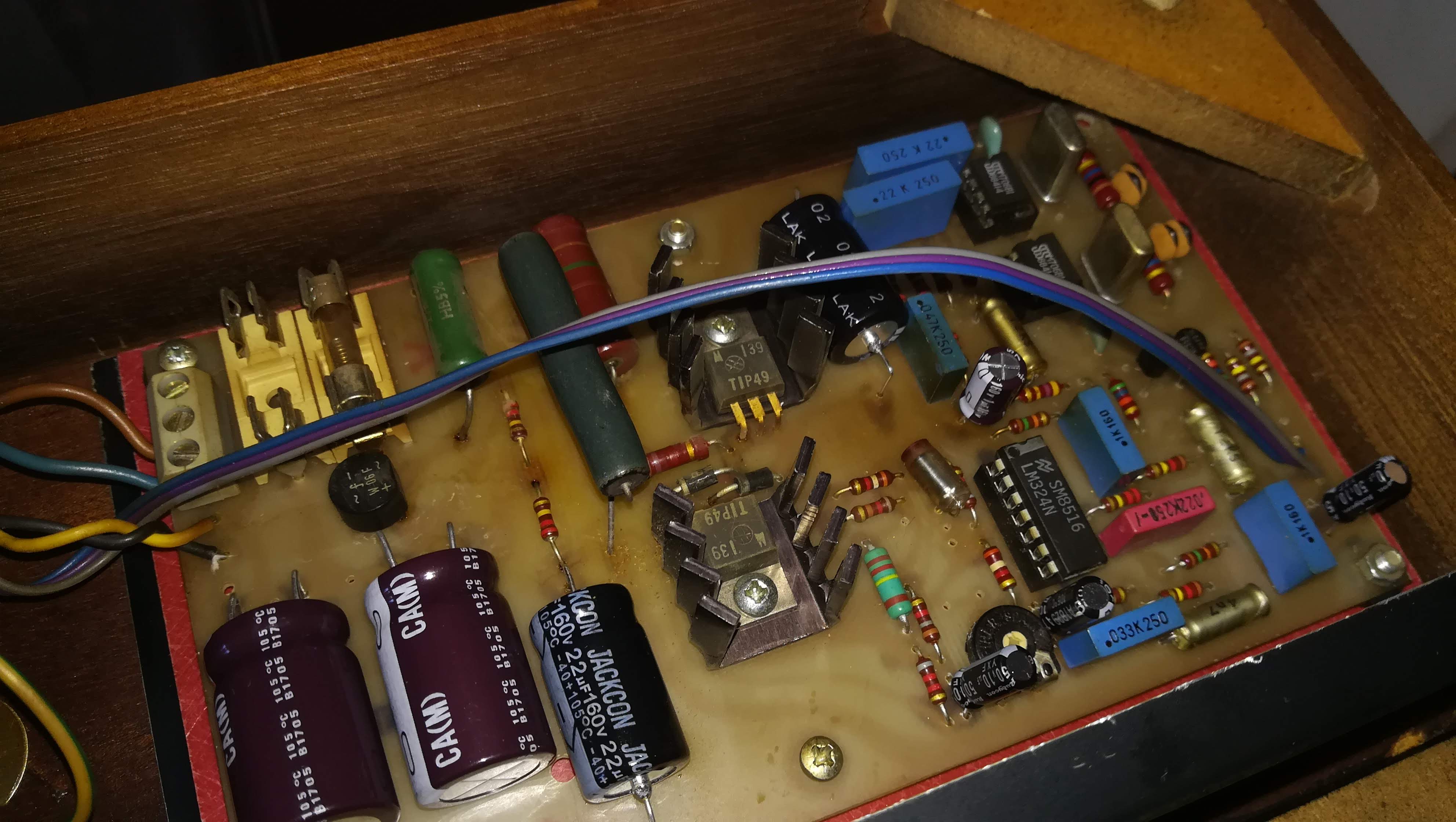

One of the guys over at the vinyl engine forum suggested I try this forum to get help fixing my Systemdek iv E turntable which I had recently got out of storage. Unfortunately when I went to play some of my old records the motor on 33 rpm stopped after about an hour. The motor still plays at the 45 speed but the 33 speed won't. I realize it's not easy suggesting what could be wrong from looking at a picture but I'd be grateful if anyone could take a look at the attachments and make any suggestions as to the possible fault in the PCB which is stopping the motor running at the 33 speed.

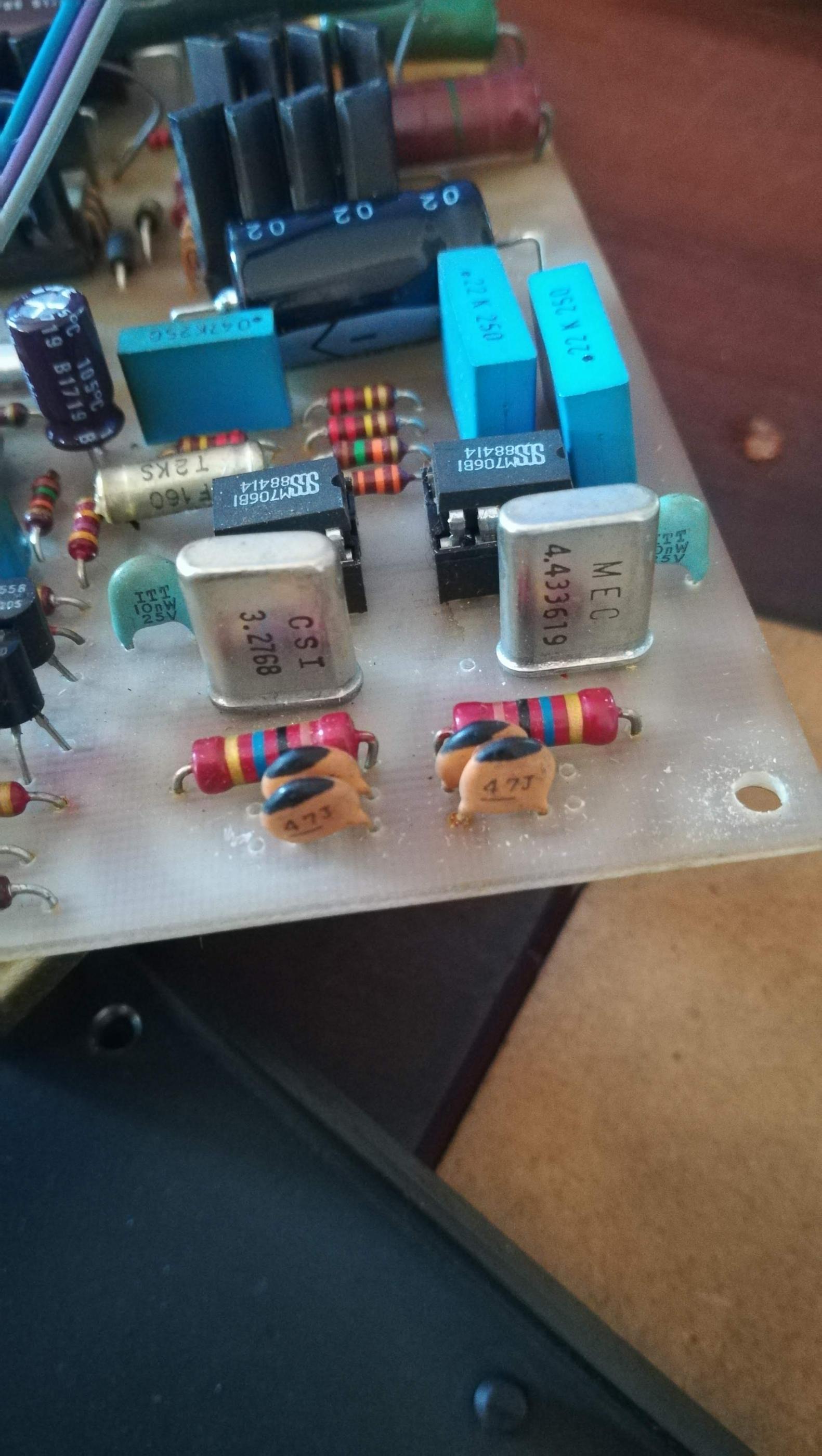

I'm not entirely sure, but I think it could be one of the two m706b1 chips next to the 0.22 k 250v capacitor I'm also not sure which one controls the motor speed at 33rpm.

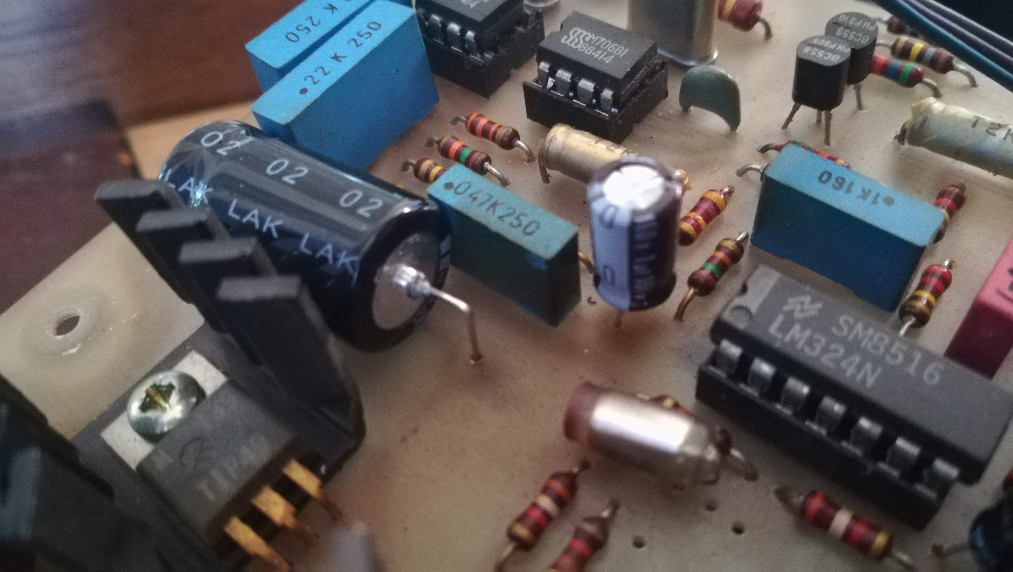

Any help would be appreciated and if you could also confirm if I'm correct in thinking that the 0.047 K 250 capacitor looks damaged and a replacement would be a 47 picofarad polypropylene film capacitor. I'm not certain if the "K" on these old capacitors signified 10% tolerance or 1000 times the stamped capacitor value.
Many thanks
Ken

Your images are indeed dark and blurry, there is very chance to examine the circuit properly. The mentioned capacitor looks blackend, but not because it is damaged but maybe the adjacent electrolytic capacitor is damaged.

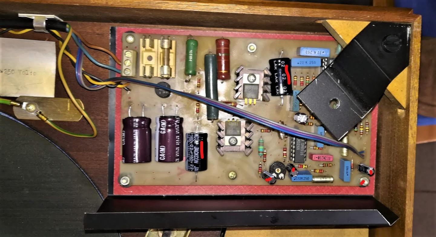

Here's another pic which is hopefully clearer and with the changed capacitors
marked in red.
I would just like to get an idea of what may be wrong so that I don't get the run around anymore.

I wouldn't like to give a definitive answer to that although you could say the lower frequency crystal would be used to derive the slowest speed... but it doesn't necessarily work like that as it depends on the division ratios available and how the raw frequencies divide down.
Surprising to see the 4.443619 MHz crystal used here (actually its 4.3361875 and is the colour subcarrier frequency of the old PAL TV system).
Although crystals are normally pretty (make that very) reliable they occasionally can give problems.
Just swap them over as Arch suggested or you could (if they are identical) swap the chips.

Hi Guys,
I've swopped the IC M706B1 chips around and the problem reverses. ie, the motor turns at 33 instead of the 45 setting. I'm assuming that means one of the chips has gone and everything else is ok. I'm can't check to see if the speed is correct at either setting until I put everything back together. But the problem does reverse when I swap these chips around.
Cheers
