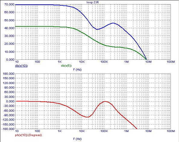

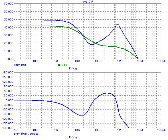

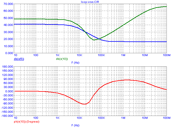

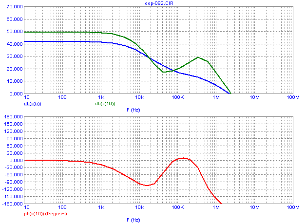

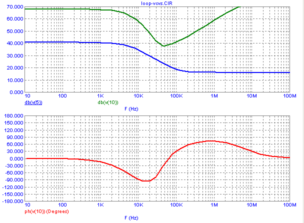

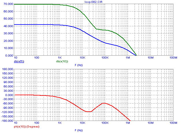

I would like to mention that the post-filter NFB topology response can be severely impaired when the opamps with finite GBP are taken into account. Here are open loop signals on the outputs of opamps (post #122).
1)VCVS, gain 1000
2)OPA134
3)TL082
1)VCVS, gain 1000
2)OPA134
3)TL082
Previous plots were calculated for R104=47k. Attached are simulations for correct value R104=4.7k
1)VCVS, gain 1000
2)OPA134
3)TL082
Charles, what was your target for phase margin?
1)VCVS, gain 1000
2)OPA134
3)TL082
Hi Dimitri !
Absolutely right. Charles is implementing the D portion in the forward path with OPamps, in order to avoid the caps in the feedback. He does not like feedback caps, because in many designs their values turn very small and it is hard to get types which are welcome in the audio path.
Some insights of my design:
I am not afraid of the caps in the feedback, because I found simple ways to keep the values large enough which allows to get preferable cap types easily.
But I am generally afraid of running the D-portion through the OP amps.
This concern is independent from an implementation with feedback caps or in the forward path.
In case your OP amp is to slow, the oscillation frequency will drop remarkably below the theoretic value . The triangular shape of the carrier will be impacted and consequently distortion will go up.
Furtheron it can be expected that large HF sloping would activate multiple additional distortion mechanisms inside the slow OP amp itself.
For all these reasons I am running the D-portion through the common base arrangement of the BJTs only (post#151).
And already in my configuration a TL082 would be much to slow and an OPA2134 still slightly to slow. The NE5532 is really the limit of acceptable speed. Real measurements with NE5532 showed that in terms of HF accuracy high voltage levels are more critical rather than high output currents.
Consequently I designed the loop on purpose with small HF voltage at the OP amp, but make use of the driving capability to keep the gain behind the OPamp reasonably high. Last but not least I have to drive the NE5532 with low impedances, otherwise its low differential input impedance would divide down the signal and the results would deviate from what the GBW graph in the data sheet makes us think.
Also the shaping network (R220, C209) is a questionable attempt, when using the NE5532. This network is more intended for upgraded builds with LM4562, or LT1364, or any fast OP amp of the DIYers choice.
In most cases of class D amps running the D-portion through the OP amp would demand to use types like LT1364 or AD2652 in order to avoid increased distortion (clocked & self osc.) and frequency drop (self osc.). Even then I am not convinced that it is a fortunate configuration. High gain for high frequencies through a long chain, might be more critical from perspective of disturbances, I guess.

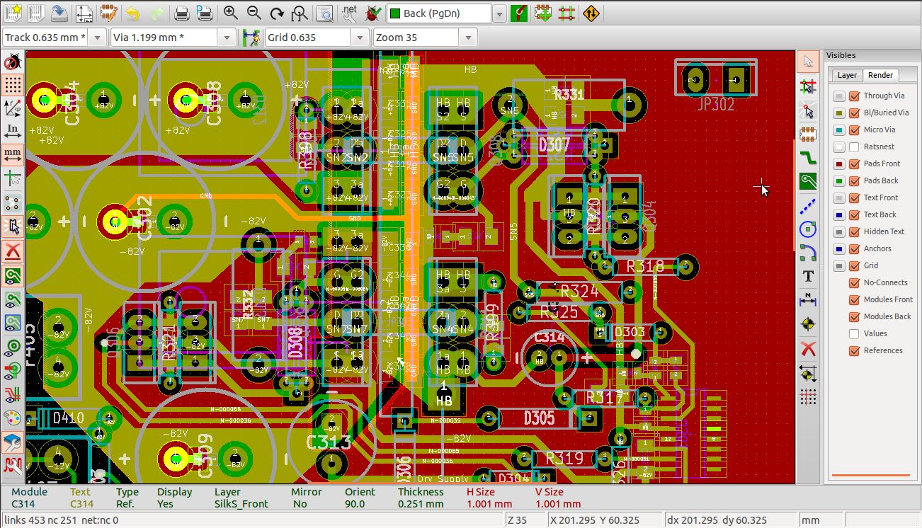

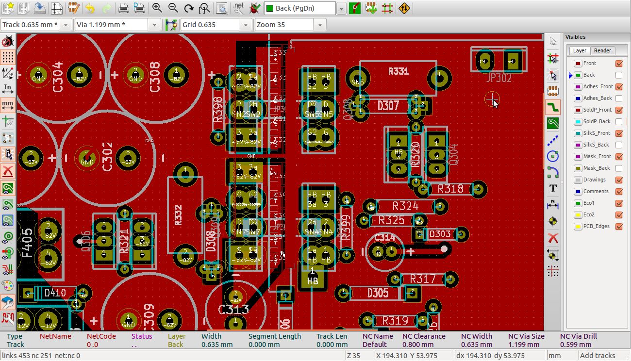

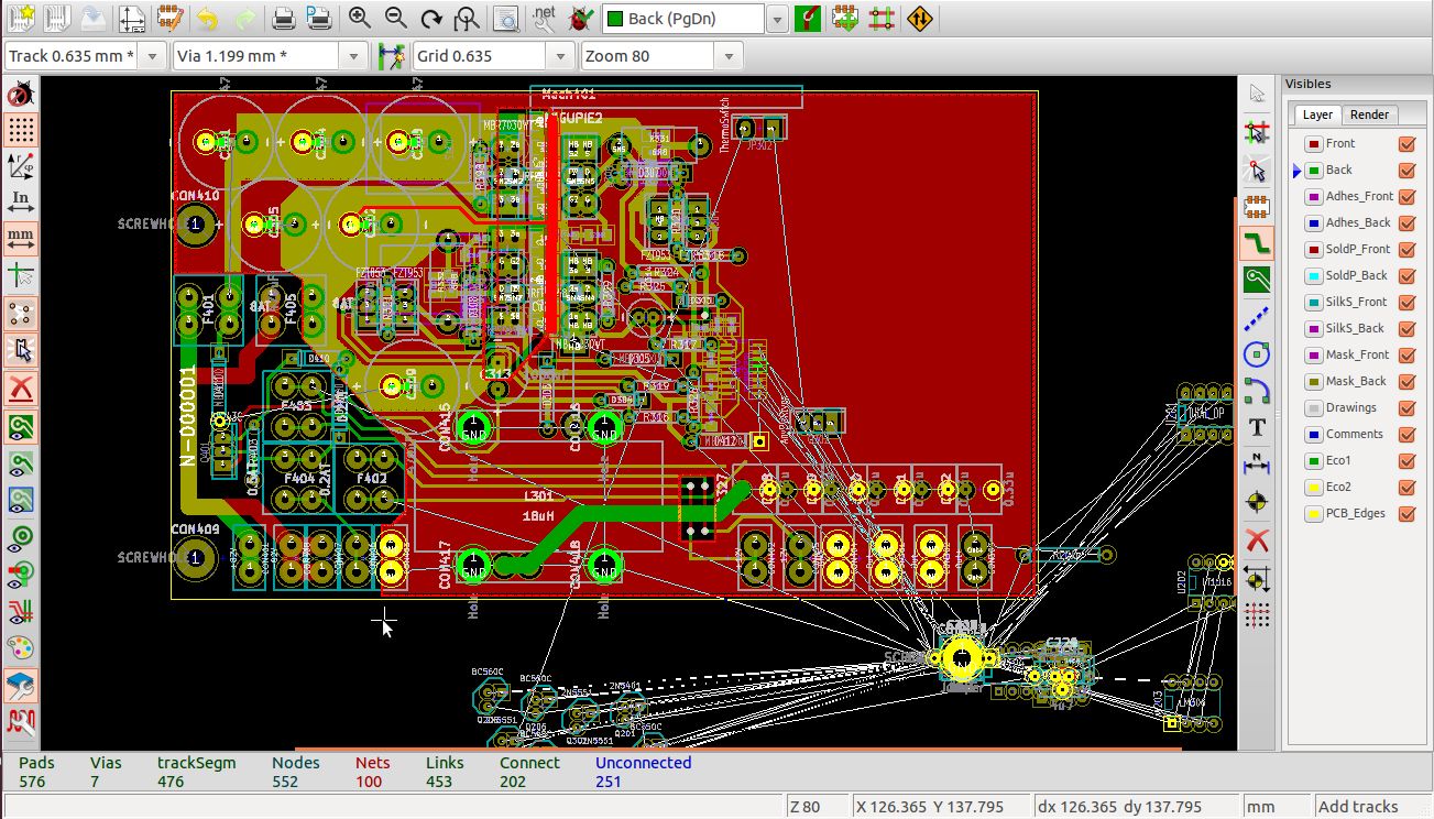

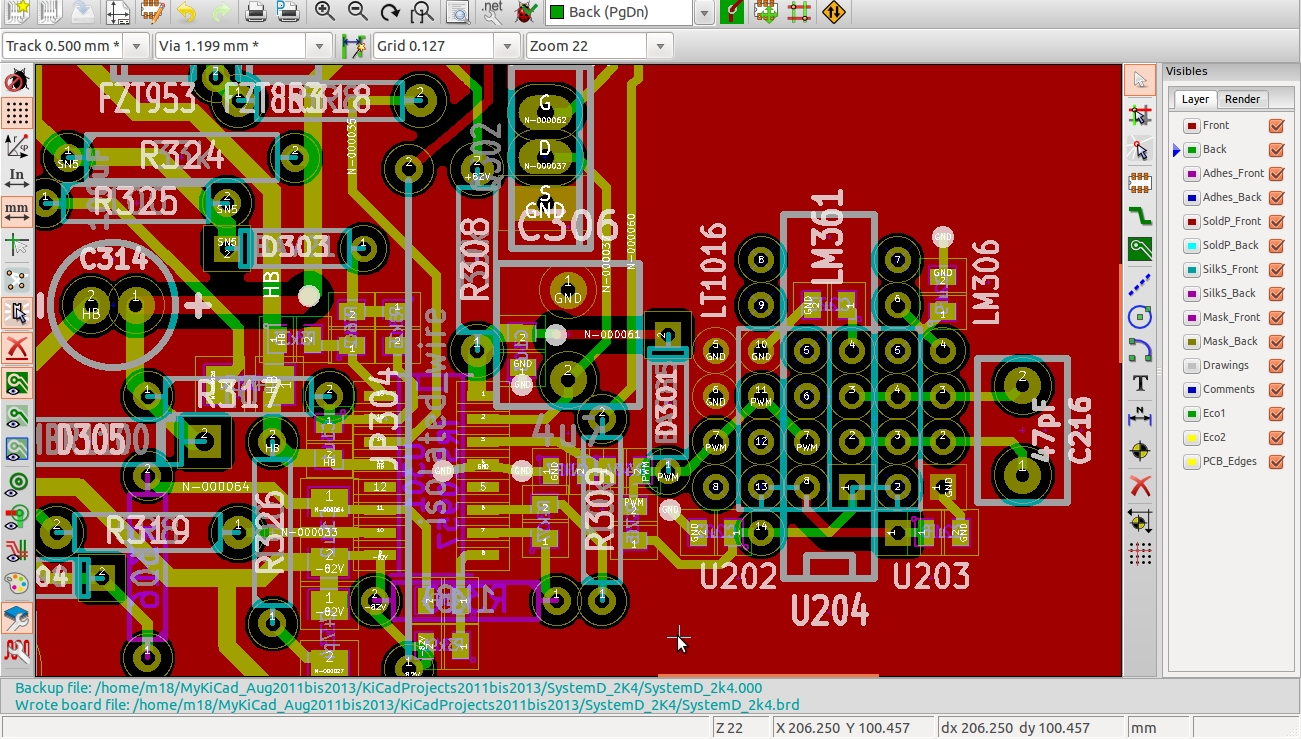

Some screen shoots from my ongoing layout activities...
- Back2Back placement of MosFet and series diode ==> short wide CuBar between drain and cathode.
- SMD rail caps between power devices ==> critical loops minimized with front/back position of tracks with high di/dt and return path.
- Freewheeling diodes on the back side ==> no additional track inductances.
-OCP sensing nodes separately snubbered directly at the IRS20957S.

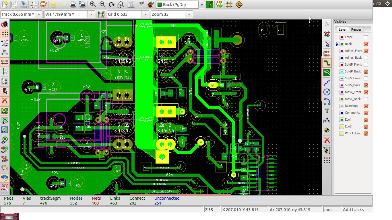

Hi Kanwar,
...your request to add the LM361 is leading to a third comparator outline.
Altogether this is breaking up my GND plane below the comparator.
Nevertheless, I would not expect immediate noise catastrophies - still reasonable GND paths close to the signal available. So I am intending to go for it.
KiCad does not allow to set different clearances, as a function of position, for a filled area.
Nevertheless the necessary structures below the comparator would be OK for most PCB manufacturers even with 70µm copper.
So I added manually a GND grid.
Edit: The track thickness and and clearance setting for the grid is 0.35mm.

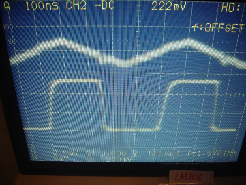

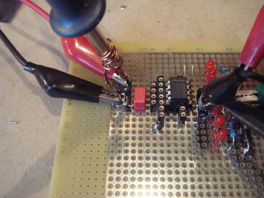

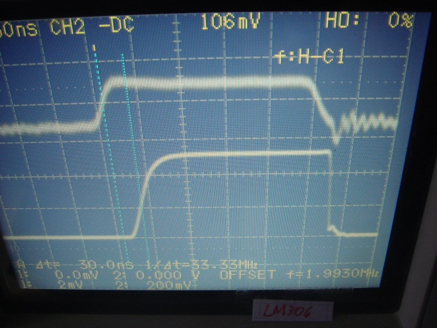

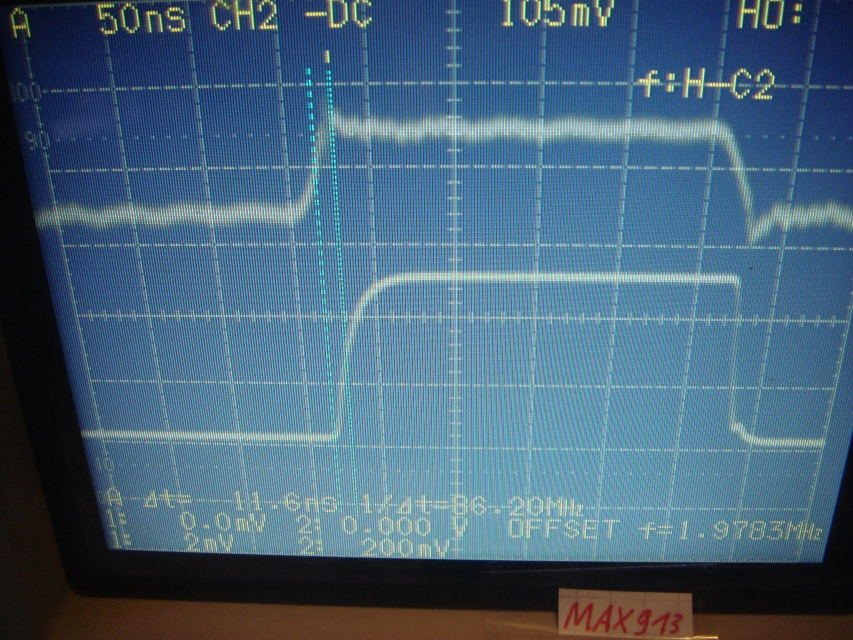

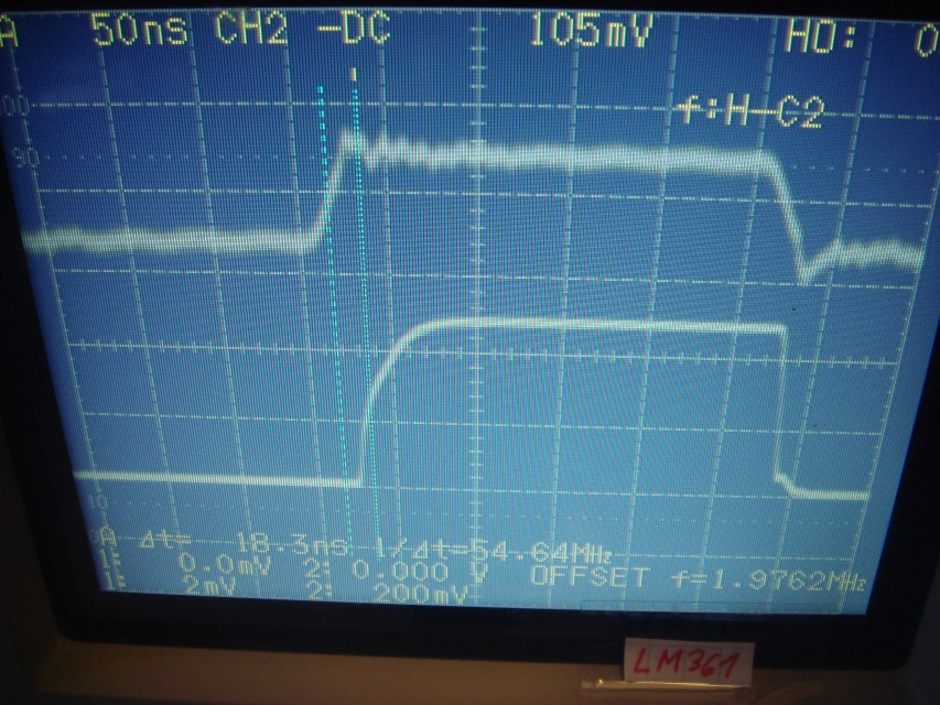

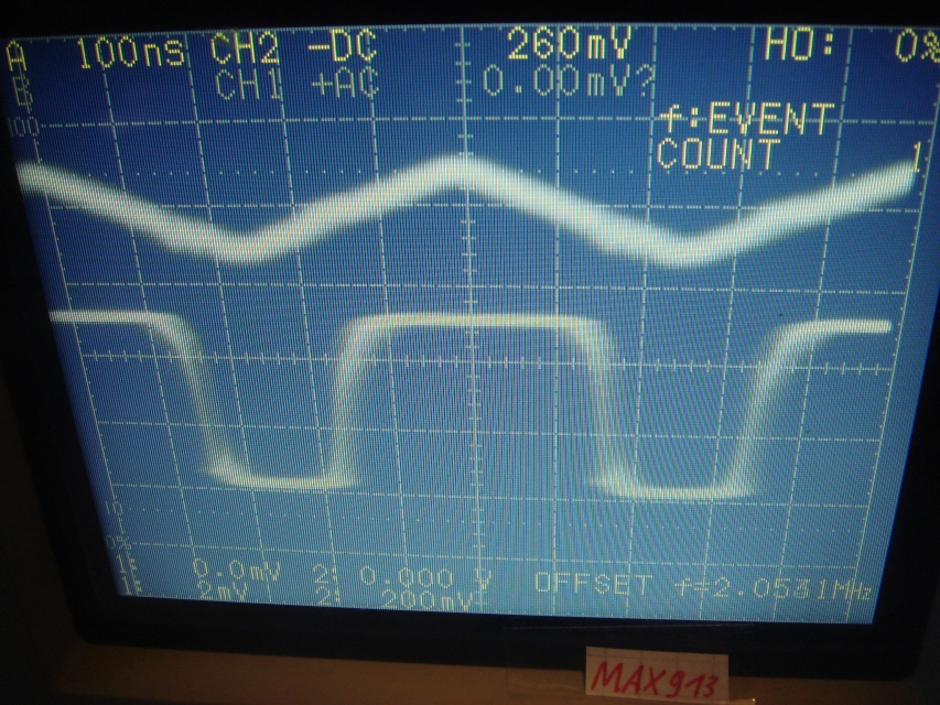

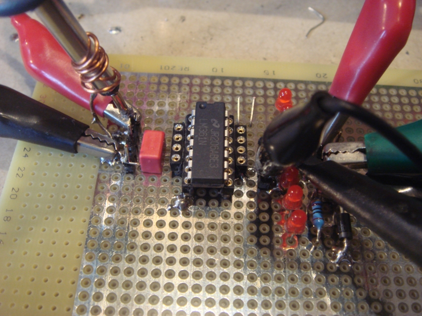

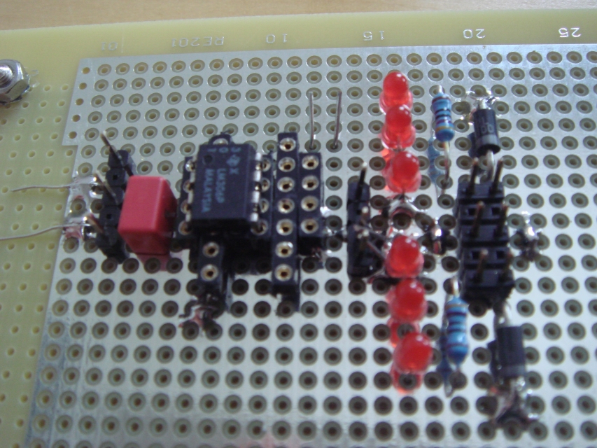

Multi Outline of Comparators
Today I set up a small jig for testing the intended multi outline before going on with the layout.
Also this is helpful for comparing the comparators.
The jig is build with identical routing as intended for the amp.
Attached some pictures showing the different positions of LM306 or MAX913 or LM361.
All comparators are working correctly with the intended routing.
The electrical testing was done with input signals of +/-10mV and a frequency of 2MHz.
LM306 is the slowest and shows slightly more self disturbance when driven with rectangles, but for a so called 'scrappy' comparator it is really good.

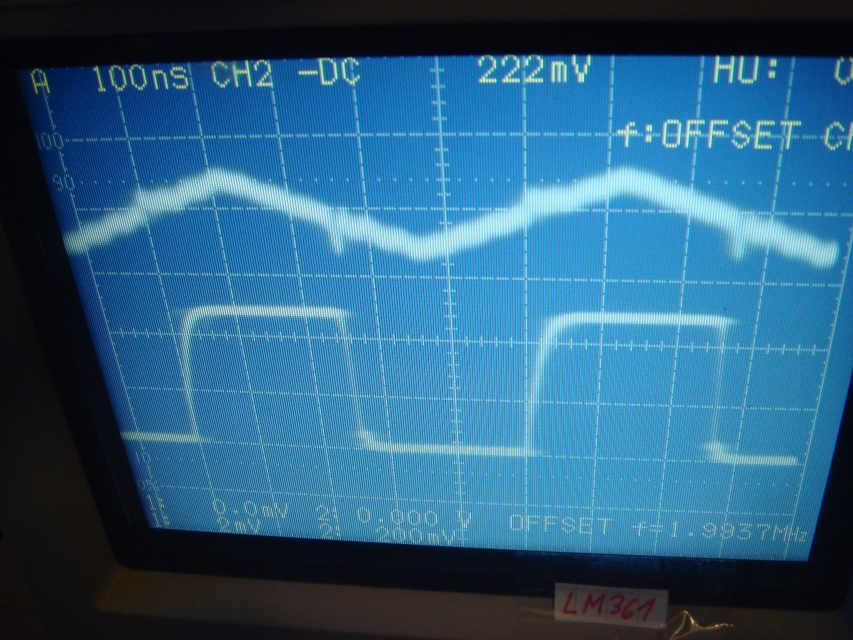

Besides measurements with rectangles, I also measured with +/-10mV triangles.
And there we can see, why I am stating that the fastest high end comparators are not the best choice for classD. When driven with small and slowly creeping signals these ultrafast high gain devices start to show serious jitter.
MAX913 performs great with rectangular input signal of reasonable size, but for input signals with low dv/dt it generates by far more jitter than a LM306 or LM361.
I am curious if we will see impact from this effect on the noise figures of the amp.
Overall the LM361 seems to perform very well.
My thanks to Kanwar that you pushed me to add it, despite its unpleasant size.
Edit:
All measurements were done with 10:1 probes.
Upper trace is the input voltage of the comparator.
Lower trace is the output voltage of the comparator.
Edit:

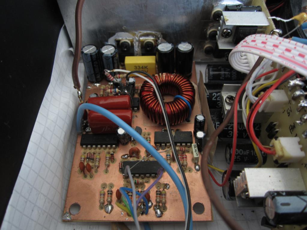

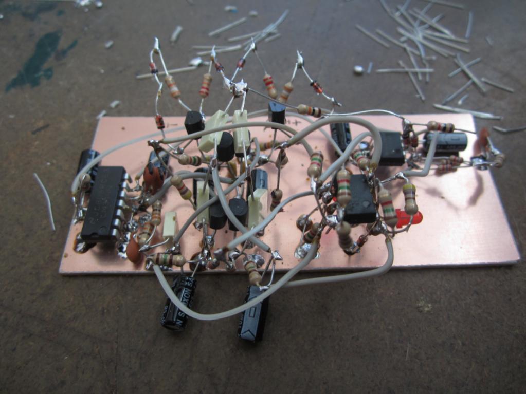

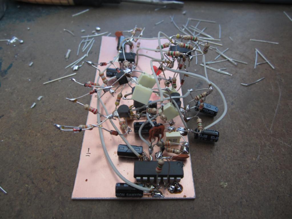

Power stage Irfb4332+ir2110, +/-107v, 4r dummy load, with load works ok, but not superior to ucd at clip, frequency drop the same.
This is what i have in hand for a little experiment (ucd-like builded about 3 years ago, but works ok even in 2r, offcourse-with power supply sag):
ouch, how did you even get your circuit to work, its looks like a forest.Power stage Irfb4332+ir2110, +/-107v, 4r dummy load, with load works ok, but not superior to ucd at clip, frequency drop the same.
Hi Ionut,
your posting does not show any key information.
You are stating that you tried a class D amp as 3D pin2pin construction and it was not better than an older design with a GND plane construction.
Considering that the layout makes 50% of the design of a class D amp, your findings are not surprising.
Regarding circuitry I can only guess you tried one of the modulator schemes of this thread with a completely different power stage and higher rails.
If done right, 3D pin2pin can operate in a satisfying way also for class D.
But I have to disappoint you - in the moment my priority is clearly to bring forward my design rather than debugging yours.
I understood that you did some comparative measurements before your experimental set up died.
If you could post details of your experiment and screenshoots of the measurements it might be interesting to have a look at.
Well, there is still your UcD amp.
IMHO UcD is a reasonable benchmark.
I have no UcD amp on hand, but we could use measurements from yours to set the mark.
I.e.
- Screen shots from clipping ( 2R and no load )
- Screen shots from the output signal of a 10kHz sine wave at high output levels, say 10% below clipping
- Screen shots from load dump
- THD measurements
- 10kHz rectangle into 2R and no load

I donot have a good scope at hand, only one very old. The waveforms looks like in this post: http://www.diyaudio.com/forums/class-d/195243-hard-clipping-classd.html
Hm, the wave forms shown in your thread are looking much better than your verbal description. Your words are pointing more to the direction that the amp falls into interuptive operation... - which is not easy to catch without a storage scope. ...but already with a cheap USB DSO it should be possible to find.
I guess you already followed Jens' hint and tried larger caps for the bootstrap and floating supply?
Edit: I see - you tried...
