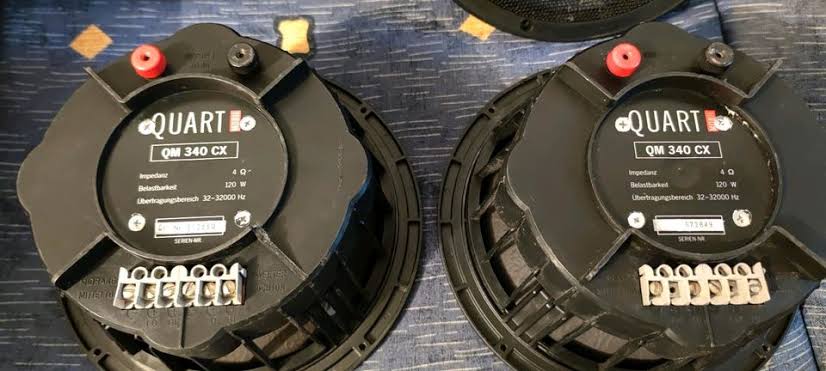

I have a set of MB Quart QM340CX which is separated 3-way speaker system comprising 1” tweeters, 5.25” midranges, 10” woofers, and 3-way passive crossover networks. I also have a pair of 8” KEF KAR 200B subwoofers. I plan to use them with a 5ch amplifier; Soundstream Reference 405. The 405 can be used in 3 channels mode, by bridging ch1 with ch2, and ch3 with ch4. Anyway, the midranges and tweeters will be installed at the front doors and the subwoofers are planned to be installed on the rear parcel. Because the MB Quart subs utilize PASSIVE crossovers while the KEF subs will receive filtered signal from the 405’s built-in ACTIVE crossovers, I wonder if installing those 8” KEF and 10” MB Quart on the same rear parcel, will the sound that is formed by different signal interfere with each other and causes bad sound?
I wouldn't expect any problems with the sound for the two different woofers but you will likely have some peaks or dips as their phase will be shifted from the 8 to the 10". I doubt that it will be a problem.

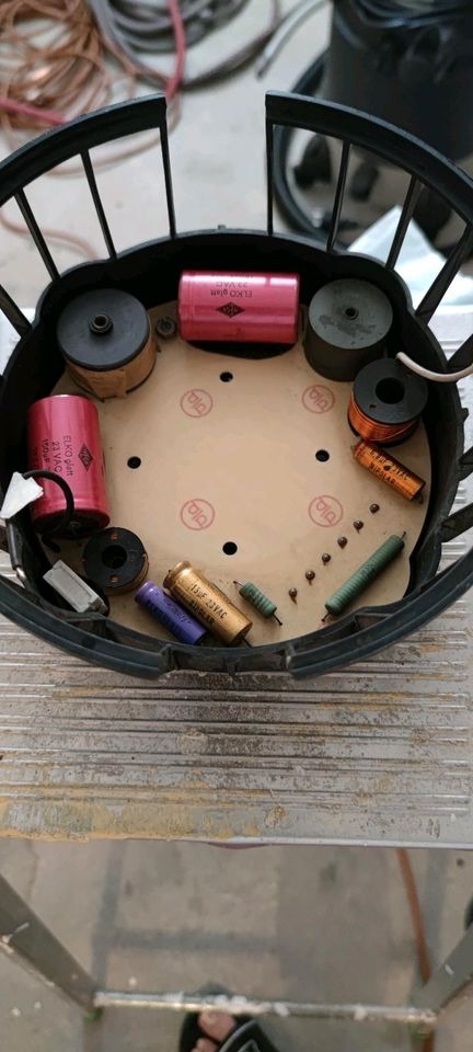

Yes, the 10” woofers in the Quart’s system are attached with the passive crossovers. It requires modification to delete them from the woofers which may be undesirable for me. However, IIRC, the passive crossovers have relatively low x-over point of around 120-200Hz. So, is it possible to set the active crossovers that feed the KEF at lower frequency such as 75Hz in order to avoid phase interference?

Are you referring to removing all passive crossovers from the system?
If you have 12dB/octave crossovers, you cannot drive signal into them if there is no speaker connected to it. If you go full active and the passives aren't used at all, no problem.

I don't know the crossover circuit but if the input terminals will drive the woofer's 12dB/oct crossover with the woofer disconnected, you must disconnect the woofer's crossover. Removing the series inductor may be the simplest.
The same thing applies to any 12dB/octave crossover. If there is no speaker connected to it, it cannot have signal driven into it.
