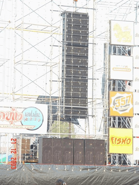

L-Acoustics - rented this sound for my event, liked the sound Photo 1 Photo 2 (Photos from our event in Bangkok, underground basement)

Why is the rig setup so far from the back wall? That will result in a lot of bass cancellation on the dance floor.
How is it the DJ does not feel the bass he plays? Bass reflex subs are omnidirectional which means they produce just as much bass behind as they do out front. In the pictures you posted above the DJ decks should have been literally dancing on the table from all the bass, if they weren't then you either did something very wrong with the setup or the subs were a cardioid design.

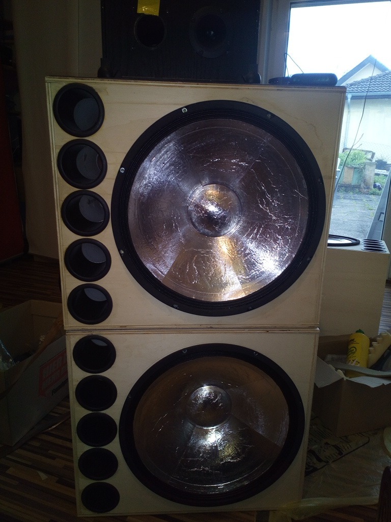

Here a bass system I realized
https://www.diyaudio.com/community/...loudspeaker-sandwich-cone.402917/post-7443474
