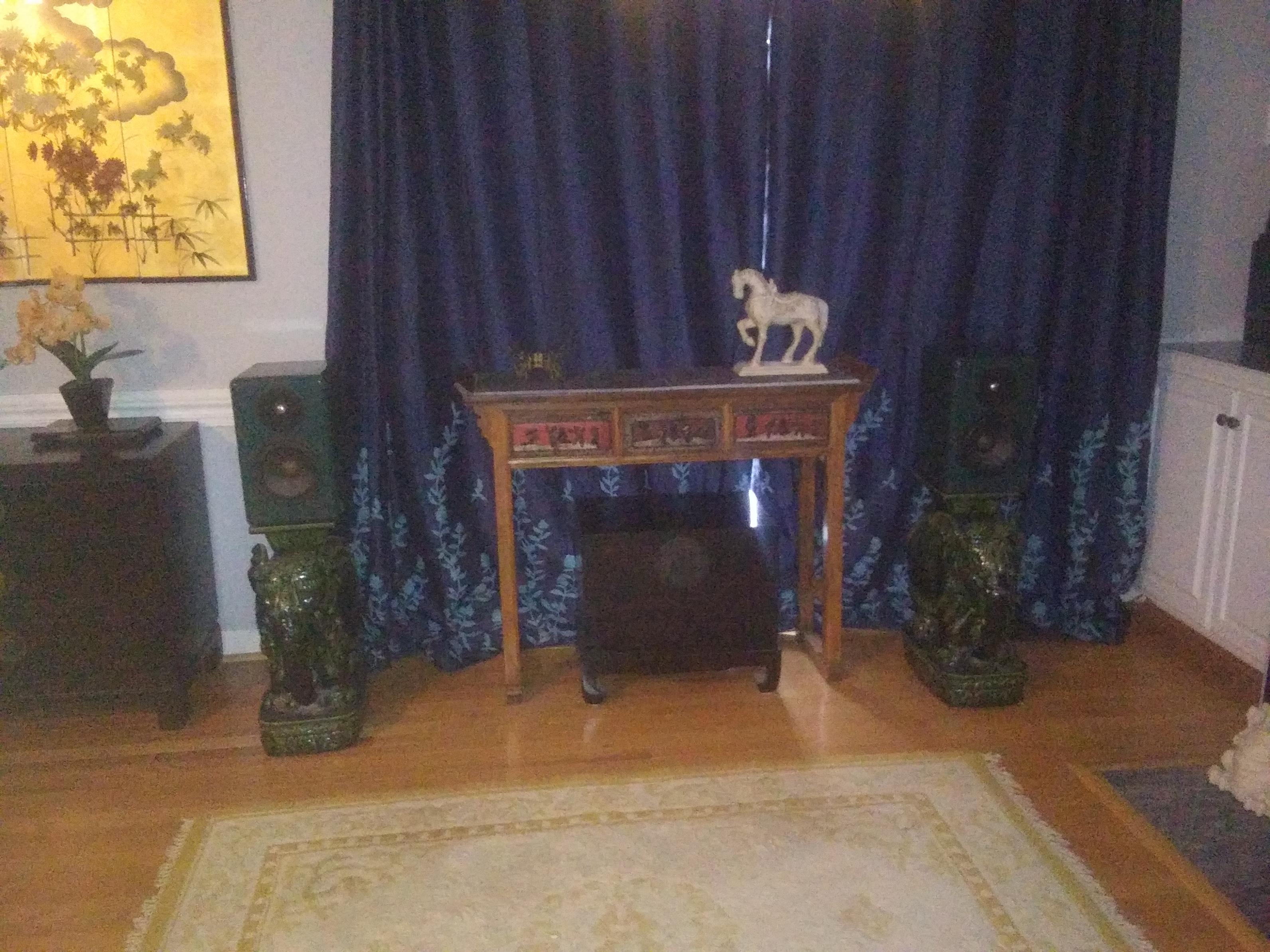

Sub and small is unfortunately an oxymoron. Just physics. You can force it with lots of power and EQ, but distortion skyrockets. How audible it is to you, you have to figure out. My living room sub ( 12 inch Peerless, critical Q,) is disguised as a Chinese chest.
The Dayton DSP plate amps seem popular.
