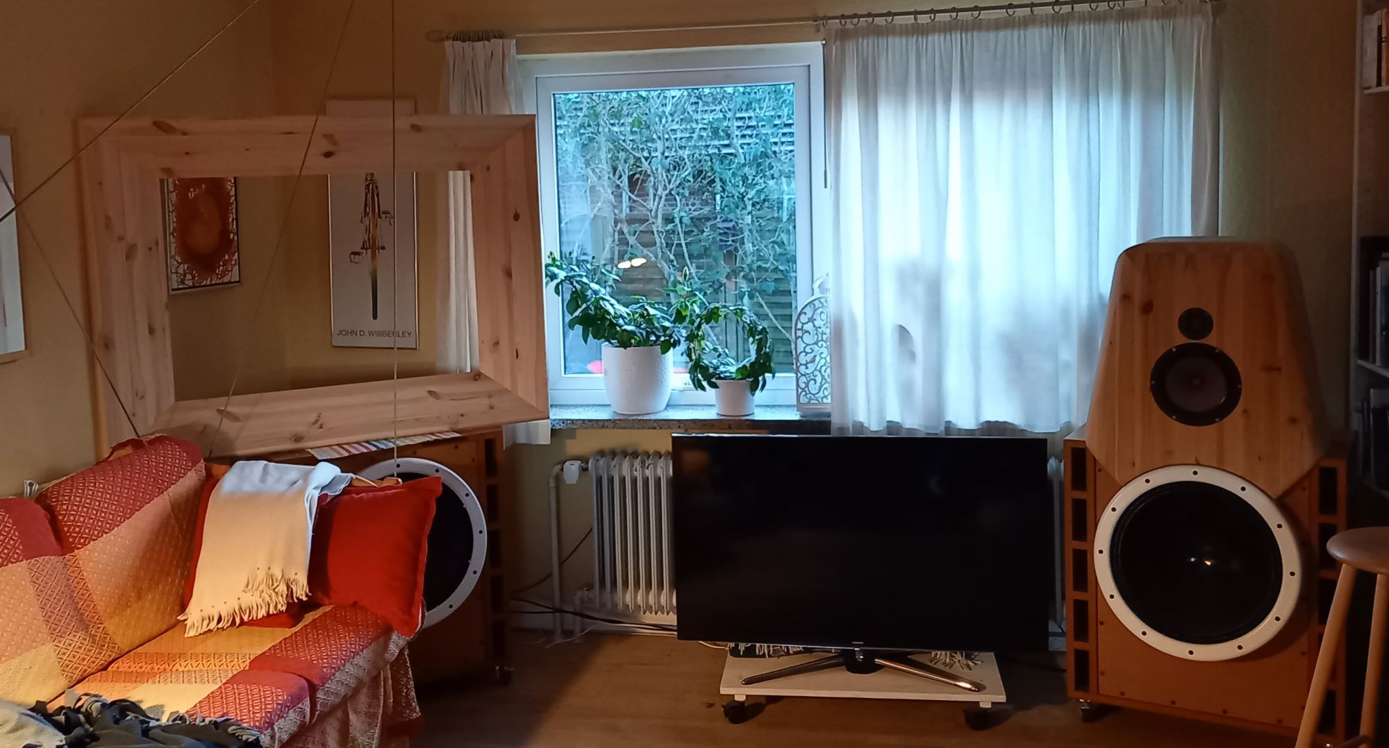

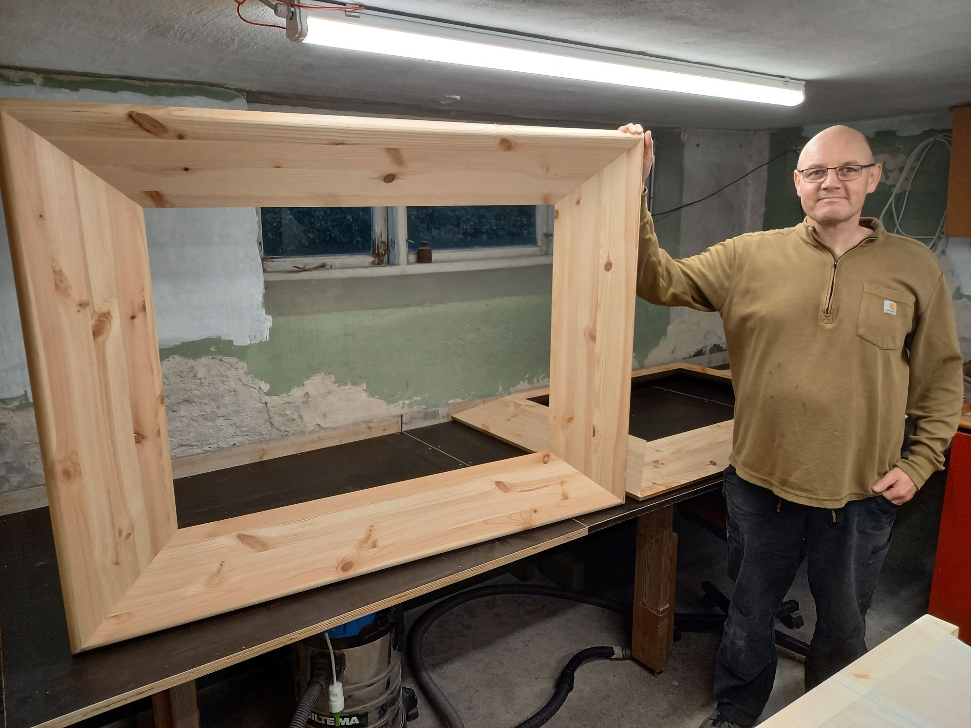

I have started to build a pair of MEH´s this summer. I call them "Le Grande MEH Danois". I am far from finished, but I will start a thread soon. Maybe my story can inspire you?
I have been collecting and preparing for years actually. Reading through a lot of threads here on diyAudio and also on the Klipsch forum, following the writings of members that have already contributed in this thread. I am particularly inspired by Mark100´s builds and Cask05´s K402MEH.
I have kind of made some basic decisions and started from there:
I wanted some really big MEH´s to control directivity as far down in frequency as possible/reasonable in my room
132cm/52"Hx98cm/38,5"V
80Hx60V, ratio 1,35:1
corner-placement up against the sidewalls (as Tom Danley did with his SH50´s in his living-room back in Illinois)
secondary flares with rounded edges (approximating some tractrix flares)
1,4" compression-driver (Faital Pro HF1440), that can be upgradet to a BMS 4594HE if I want that in the future. 1,4" is a sweet-spot/good compromise I think
midranges (4x4NDF34 16 ohm as Mark uses)
I start with two old 15" woofers I have (Visaton BGS38), but the MEH can be upgraded with four 10" og 12" woofers if I want that in the future
midranges and woofers mounted on top/bottom panels that can be changed, modular design!
15mm plywood for the horn and 12mm plywood for the enclosure. I found some WISA TWIN that had an OK price, as my MEH is modular I can upgrade to birch-ply.
DSP crossovers, I have a bunch of MiniDSP plate-amps with DSP.
I have decided to start with at square throat, to get started! In the future I can upgrade with a 3D printed round to square throat adapter du to my modular design.
After many many hours of contemplating (and obsessing over details), I have come up with a somewhat untraditional approach of building the MEH upside-down, starting with the secondary flares, to be able to make a modular design and round edges. More on that in my own thread. It has turned out to be a rather complicated design, but that always happens to me!!
I would probably not go that route again! I think the way Mark100 does his SYN-builds is easier.
Then I used Bill Waslo´s Synergy Calc to get some plans to start with. I actually had to recalculate the initial horn, as my prototypes had shown, that synery-calc computes som minor errors (39,78 degrees instead of 40 and 29,78 instead of 30). I choose to recalculate on paper and made my own plans. The secondary plans are build according to synergy-calc. That´s just me and my perfectionism!
BUT FIRST I made some smaller "prototypes" 73cmx54cm out of scrap material I had at hand to learn and make my mistakes (most of them!) before I started on the big ones!
It is a bit like solving a SODUKO actually, find somewhere to start an go on from there. There are many choices to make! You have to find your own way I guess.
I have an idea of where the midrange- and woofer-tabs have to go. But if I do not nail it in the first try I can just make a new panel and try again. Modular design!
The MEH´s will be placed in my room-corners on some double 18" subs. They will actually occupy less florespace then the speakers I have now!
A year ago I made a muck-up wooden frame out of some old boards, 150cm/59"x110cm/43", to find out how big a MEH I could build. Then my wife and I looked at it for a while and decided to shrink the MEH 12% to the size in the picture above.
This is what I have done/am doing. Hope that helps. I guess I will need some help from the diyAudio-community when I have my "hardware" finished.
Happy new year to everyone
Regards from Denmark
Steffen
