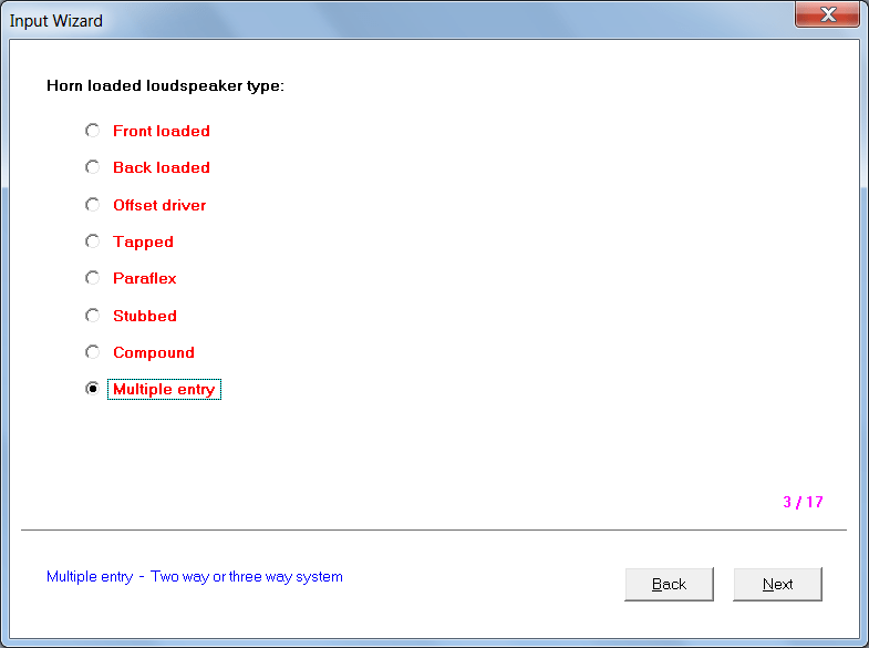

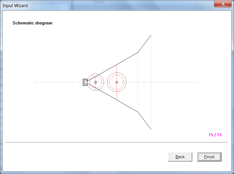

The Compression Driver is not included in HornResp modeling, only the midrange and woofer.
The updated Synergy Calc V5 detailed guide document was released in March 2014. A multiple entry horn loudspeaker wizard tool that takes the high frequency compression driver into account was added to Hornresp some time after the document was released.
A MEH template can be created using the Input Wizard and the parameter values then changed to suit the specific design.
See the Multiple Entry Horn Wizard and Two-Way or Three-Way Multiple Entry Horn sections in the Hornresp help file for further details.
Thank-you David! This is extremely helpful.
