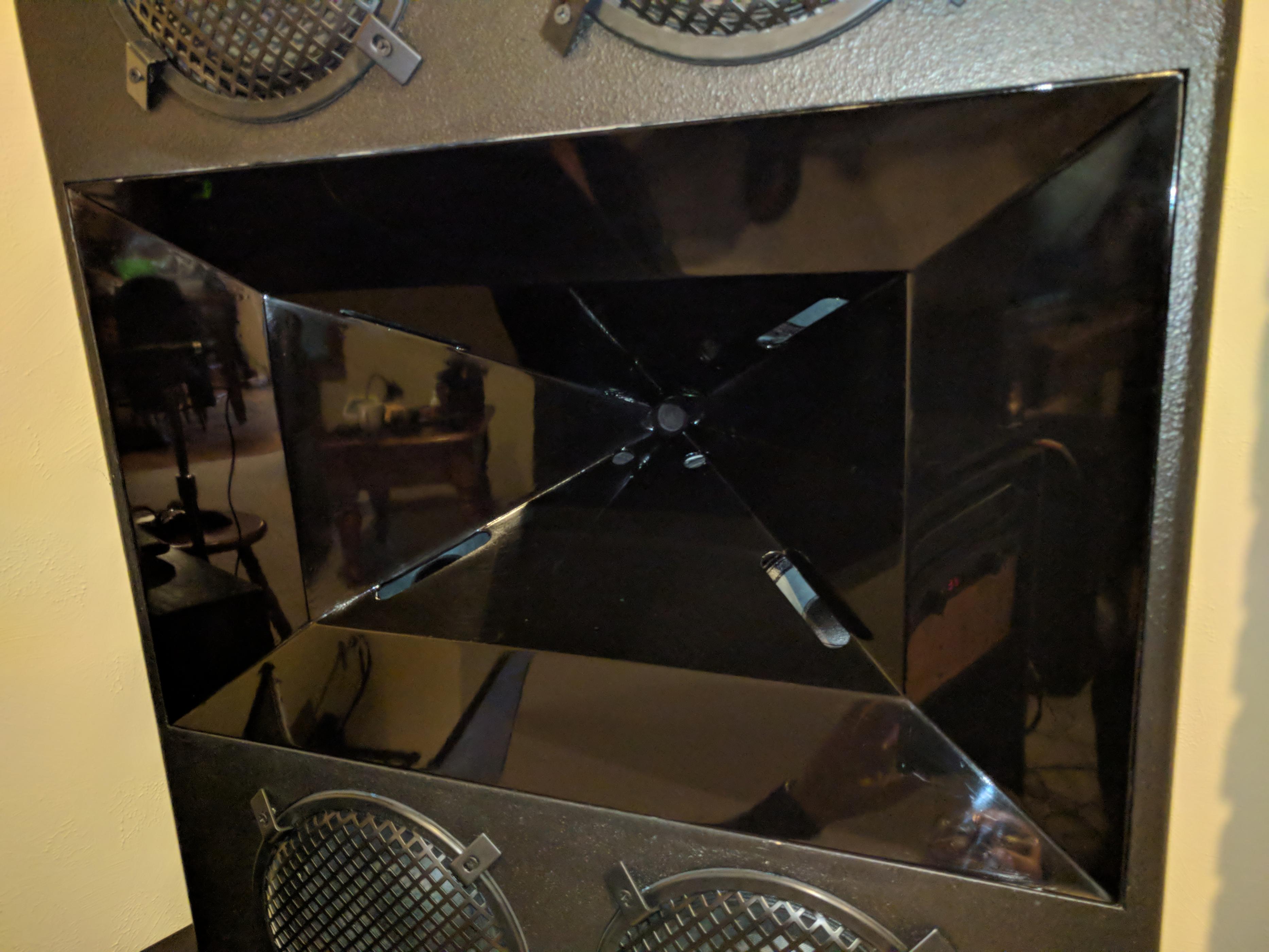

What horns did you use?Installed the mid-range and mid-woofers onto the horns, and getting them assembled now. a few hours of wet sanding and polishing the horns made a difference in the appearance. Next step is wiring the amps and configuring the minidsp.
wow these look insane! really nice! What's the lowest the horns play?
I'm estimating 90hz, but will probably cross over higher, like 120hz. I have yet to test them, and have some concerns around the excursion limits on the 6.5" woofers. I'll setup a few configurations and switch between them on the minidsp.
I originally had some other ideas around building these speakers. They are built using BWaslo's 60x90 synergy spreadsheet, a few inches larger in dimensions. I had the first prototype "unity horn" I was planning on having fit into the cabinet but decided to build a new horn to fit the enclosure precisely, and I decided what the heck, lets build a synergy and put some woofers in. This presented some difficulties around how to cross over the five sets of drivers. For now I plan on driving the 4x10" and 1x15" on separate amps both low passed from the minidsp driving the same frequencies. What would be ideal is to high pass the 10" woofers and low pass the 15" below the 4x10" but for now this will have to do.

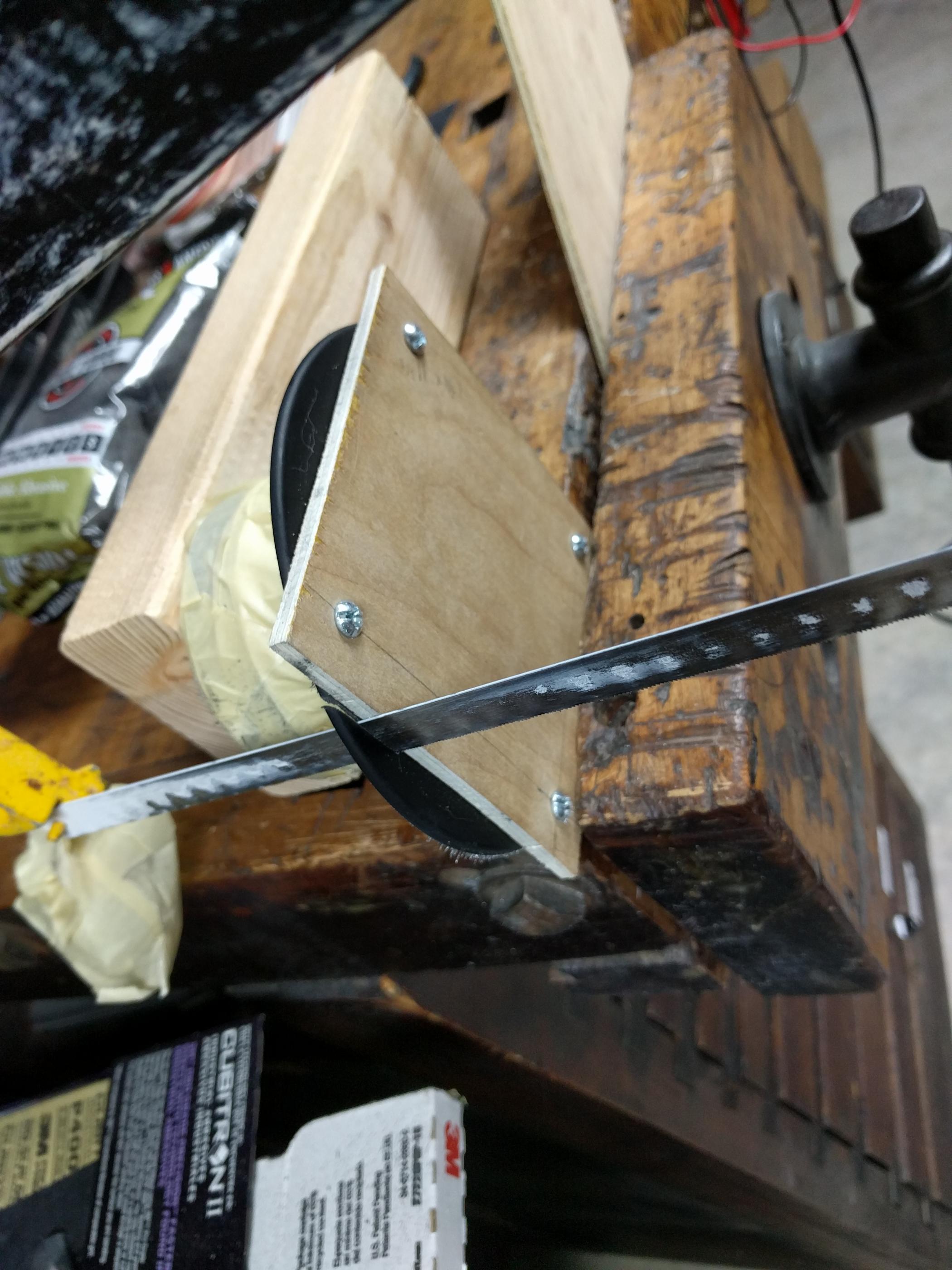

Cutting mids square for close spacing

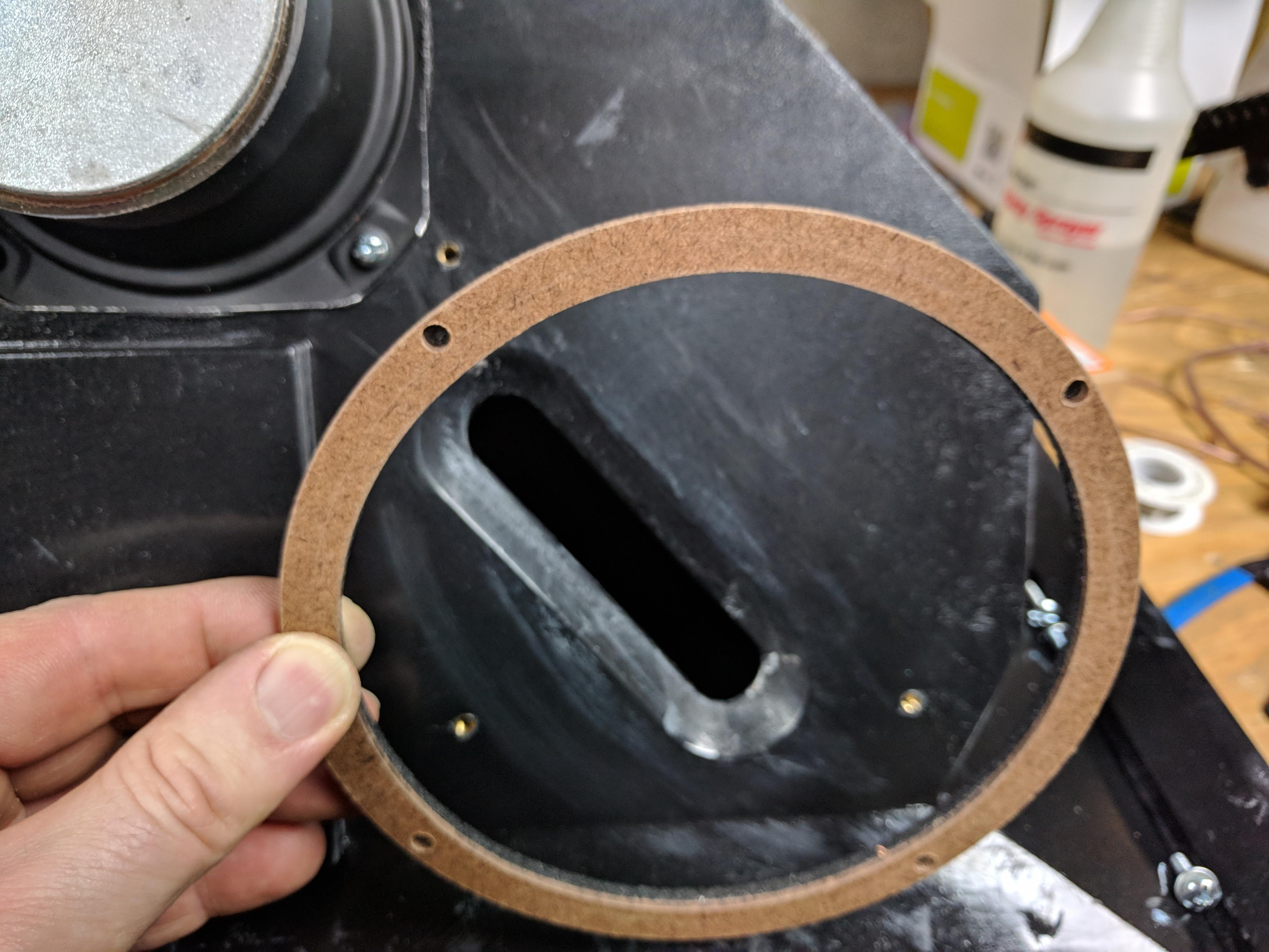

I decided to try GRS mids because the other buyout mids (Titan) were not performing great. In order to fit them on this horn they needed to be cut down so instead of trying to measure and mark where to cut I made a square jig out of a piece of plywood to help make the cuts. It makes this way easier. Use a good quality hacksaw blade and the cuts are fairly accurate. Cover the magnet and frame with masking tape to catch the filings.
I also replaced the buyout woofers with Dayton 6" pro woofers because some of the surrounds and dust caps came unglued. I noticed after mounting one the cone did not have enough clearance and would have smacked the horn so I routed out some spacers with the Jasper. Worked out perfectly to give just enough space, around 1/8 inch or 3/16 with the gasket.

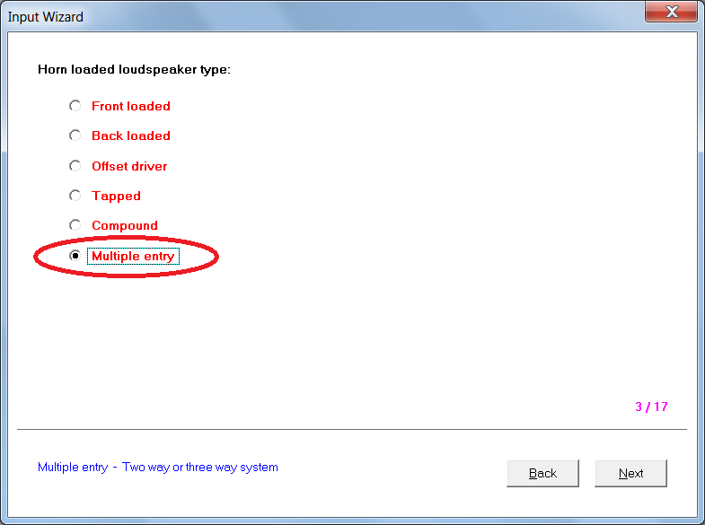

I'm really interested in learning the MEH wizard functionality in Hornresp but I have not been able to understand how to put in all the variables.
Have you tried using the Input Wizard tool to generate a representative example design, to serve as the starting point for specifying your MEH system?
Hi David,
The part I struggle with is inputing the horn geometry and also how to represent the sealed back mids which I don't have any parameters for. So far my design approach has been port placement based on crossover frequency using the perimeter of the horn at the port entry as well as placing the mid port as close as possible to the compression driver.

Refinished horns with grills added.
Kids and cats, too many accidents and mischief in the house to leave woofers exposed. I replaced a 10" woofer due to the dust cap getting crushed by a cat's rear legs when they jumped inside the horn enclosure while assembling (I always buy spares, and PE sent me a replacement one due to distortion/noise issues).
