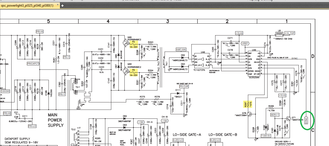

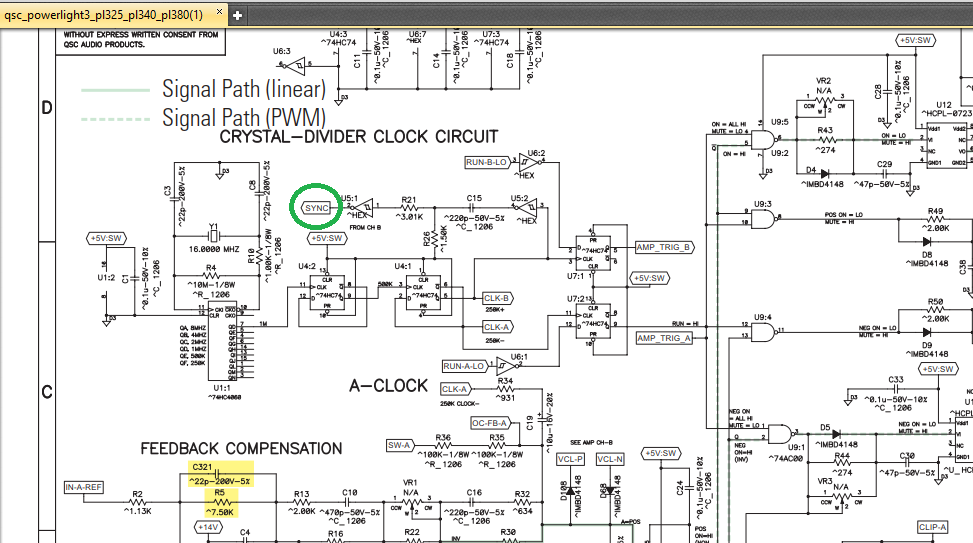

Hi, Q S C use this system. Look the green circle in the photo P L 3 8 0 amp service manual. Take in count that are using GDT in the SMPS. If is not too late for this
