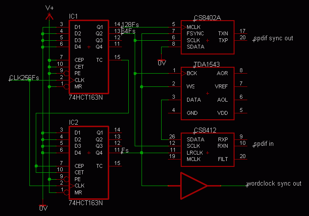

As the title says, how would I go about doing this? The easiet way, I presume, would be to output a SPDIF signal carrying the clock / bit depth / etc. data from the CS1842 receiver chip and send it to the SPDIF input of my sound card (the HDSP 9652). Is there any reason why this wouldn't work?

I haven't done this but it appears you can do exactly as you plan.

First a few words.
1. Consider this schematic a starting point.
2. If I had to do this I would use a CPLD or more likely a FPGA.
3. It is probably unwise to drive 4 inputs with the Q4 output of
IC2 without a buffer but I wanted a small image file.
4. Ulas would probably disapprove of my picayune effort.
The schematic.
