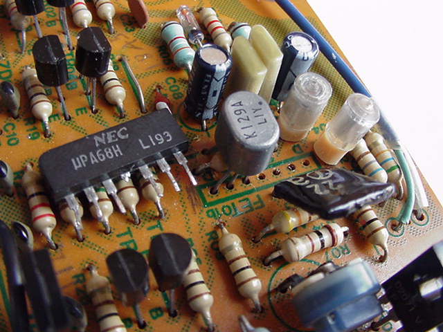

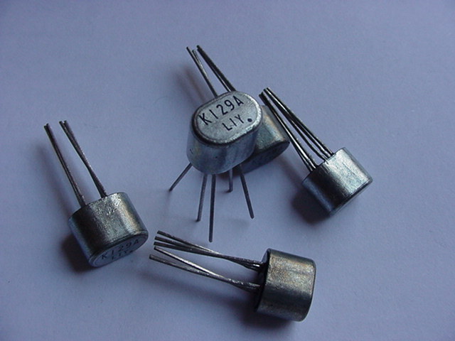

No spec. can be found for 2sk129a as of now but the equivalent UPA68H has:
http://www.datasheets.org.uk/specsheet.php?part=UPA68H
I have read ... regarding 2sk129 and it really help solve the problem with my AU-519 (DD/DC circuit) driver board.
Symptom, DC offset keep on rising on L board. Replacing this 2sk129a keeps the value steady at 0 mv.
My first Au-519 uses 2sk129 can type enclosure, while my other 519 uses IC type UPA68H. With the description on the board it's identical, the specs more or less the same.

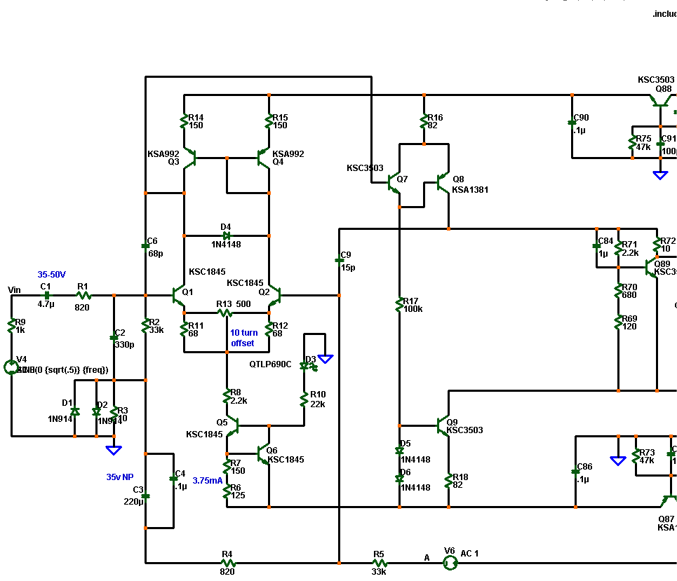

Symasym sucks... 🙁 go crazy, try something totally different. 🙂 gx is golden (luxman/apt) Fx (KoDA) is below .. check this out for crazy, no Cdom on VAS..sims at .0008%. still stable. 🙄 10/5/2010

I do believe this can be truth..but already made Ostripper
Understand that i do not want to copy topologies anymore..if already published in our forum... it seems to me something already explored... this topologie/style..we already have, in this same forum..yours!...so... you took the place with your topologie..this one you show.
The idea is to provide something different as Symphony...or the Blame evolution, maybe Blame MKII or something alike.
There are two things in the DIY game, at least my point of view...my own interest to do things and also the forum interest.... i do think forum deserves several different ideas and not the same amplifier in several stages of development.
Studying last years, you may see how many "almost the same" amplifier we had published... from the Dx we had several...from the Symassym too....yours look alike Symasym because first stage (differential and the one that follows it)..despite you claim it as another thing... seems to me that both, Symasym and yours came from the same source or same philosophy..if not the same... at least almost the same... inspired in the same root...Luxman you said.
