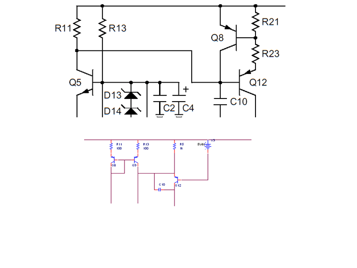

Symmetrical folded cascode.
Q5/10 and R5/8 aren't doing anything at the moment. They are there just for flexibility, so I can change it to a differential output (which I probably would do if I built it).
And yes, the zeners and current sources are a daft way around, as was pointed out before. The updated schematic later in the thread has them the right way.

Havent tryed, but a buffer with input Q5/Q10 kollectors driving the now gnd'ed side of R14 seems atractive as open loop gain is 2*.

I still vander why using singel ended drive to the folded cascode?
Here we have low input impedance to the 'cascode'. And current mirrors easily lets you apply more available current swing for the same innput (and the current is still from the input stage. And that's done without altering its bias current. Also the little noise (at af) contribution from the current sorces is balanced away.
as an exsample the Leach amp is 'singel ended cascode' drive: http://users.ece.gatech.edu/~mleach/lowtim/graphics/ckt.pdf
Lets just modify it so that its current mirror drive ( ya know there is bouth current sink and sorce available WHY NOT use it ?????). Like Slone "failed" to use double mirrors just because he used high input impedance to the next stage. Mirror input to the common base stage not make the biaspiont of 'vas stage' unstable as there is a low value resistor making the bias point.
For those not imaging:
For those who want to image:
