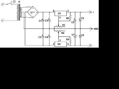

Another variation of pretty much the same thing but
rather than showing the line going from the secondary
center tap directly to the caps it is using the ground symbol.
The caps are also tied to ground same way.
Just another way of doing schematics
In any case no matter what schematic you use "PAY CLOSE
ATTENTION TO THE POLARITY ON YOUR CAPACITORS"!!!!!
Wire them with the + and - reversed and they can let
out a good boom as well as the resulting noxious chemical fumes!
The links may be more viewer friendly.
