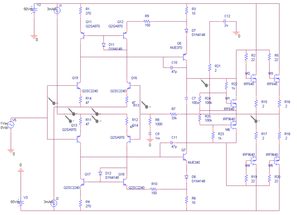

symetric amp with mirrors, vas bias stability?
Hi, this should bee near the 'SLONE' amp. But hopefully more stable than symetric with pure mirror's on the innput stage. Bias stability would bee fix by vas lokal feedback from vas, to the slightly modified mirror's. Hopefully this would work ? Coment's please.
