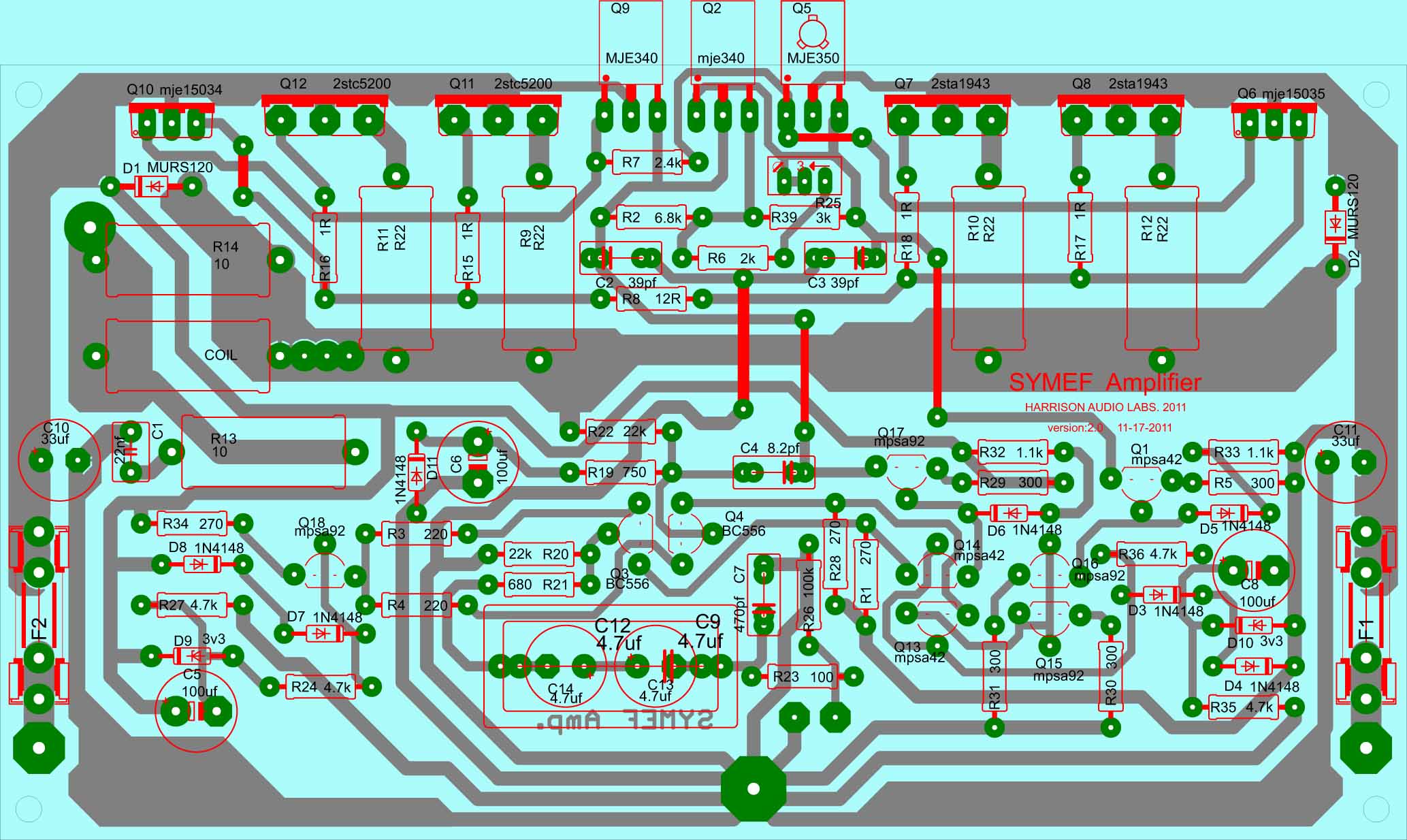

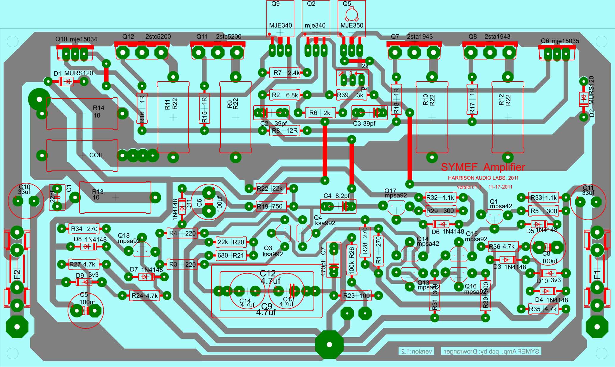

I have check the supplier the smallest casing is 26mm x 13mm it takes up the space of the whole input filter circuit.capacitor is metallised polypropylene is there any other way for this?
p.s. can i use metallised polyester or uncoated MKTpolyester capacitor and rating is 63volts?
regards,
joel
Hi Joel,
C8 Could be 4.7uF 16V NP . C6 100 uF 6.3V NP (you can get rid of the diode) unless there are any objections 🙂
kind regards

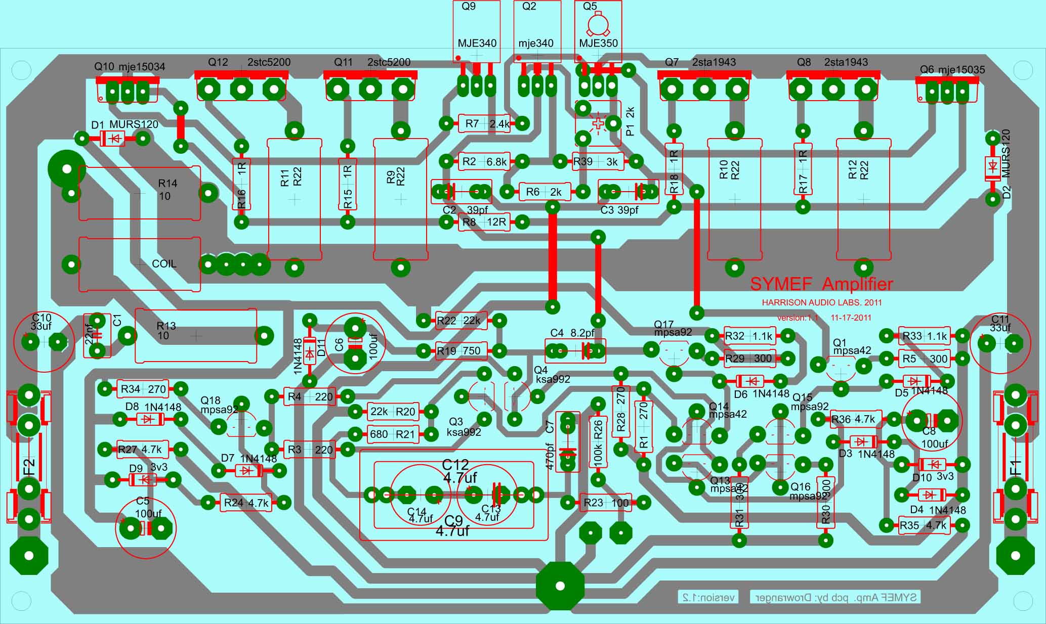

pin configuration of bc 556 is cbe while mpsa92 is ebc.im planning to use 2n5401 and compatible to the board i have design.is this fine also?
Hi Joel,
Your progress and work is looking soo beautiful 🙂 . You can use the 2N5401, however what you are creating looks promising 🙂 that is why I even suggest using KSA992 if you can lay your hands on it 🙂

This suggestion is for Q4, Q3 on your schematic
Hi Joel,
Some suggested voltages
C1 200V
C2 100V
C3 100V
C4 100V
C5 6.3V
C6 6.3V
C7 35V
C8 16V
C10 63V
C11 63V
kind regards

50V or 63V or 100V polyester or terephthalate or mylar. any of these will be far better than any electrolytic. All will be smaller than MKP, all will be cheaper than MKP.can i use metallised polyester or uncoated MKTpolyester capacitor and rating is 63volts?
You could go down to 2u2F or 3u3F.
2u2F gives up 2octaves of sub-bass. Might be worth trying that. You like the result.
c6 to 100uf
I retain the diode just in case it will be needed.I found 4.7uf metallised polypropylene rated 250 volts for c8 this is the lowest voltage rating.Also change the layout.check again if this is final.

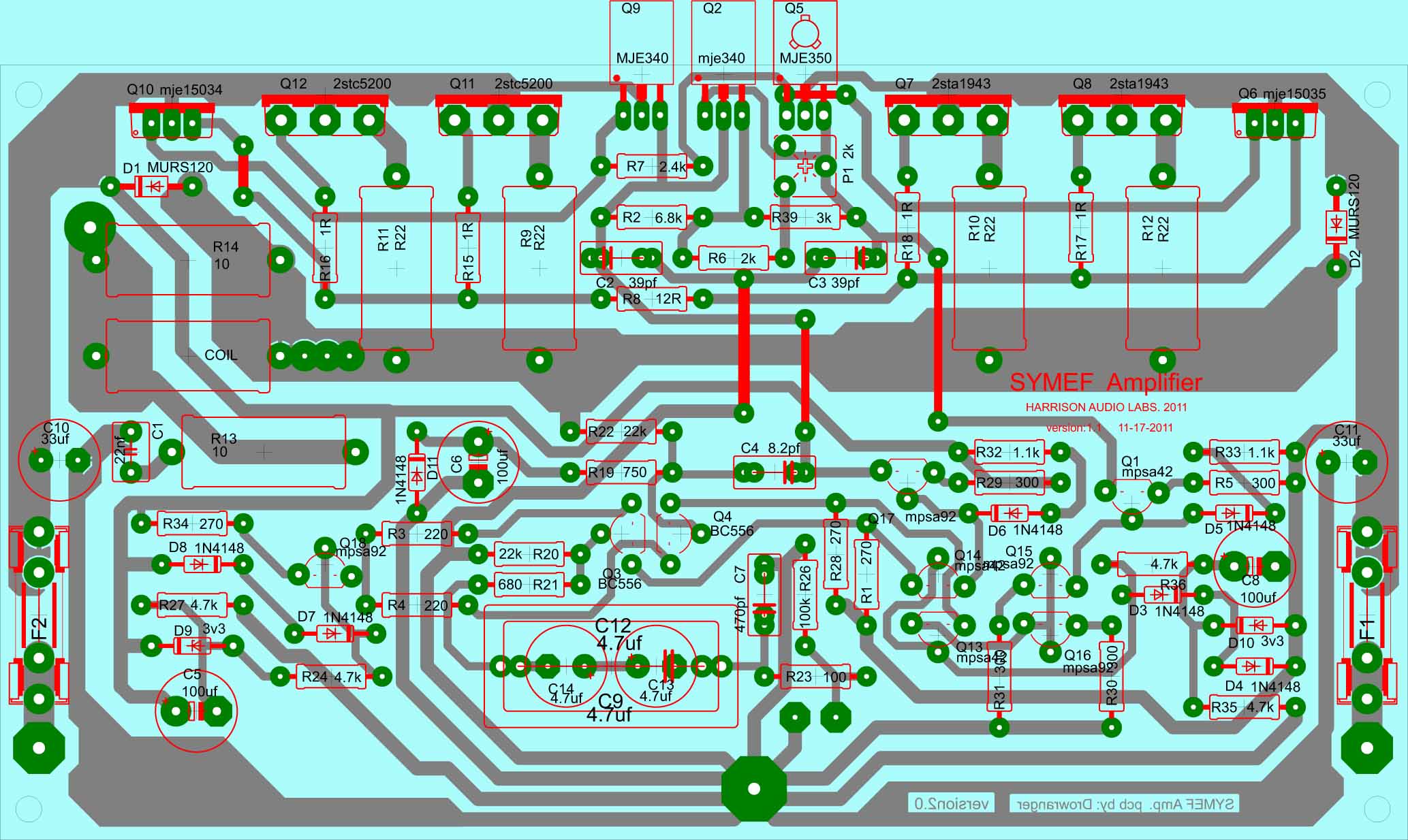

Hi Joel,
Checked the schematic, looks OK.
Cheers 🙂
using ksa992 and bc556b
I change pcb layout for ksa992 and for bc556b.does bc556b superior than 2n5401.it looks like ksa992 is hard to find but will try to get it.
regards,
joel
p.s. now I can start for the pcb.
Hi Joel,
kind regards

Joel, very PCB designs are really nice.
Can I suggest you add pins to allow mounting this style of
multiturn trimpots too for more flexibility?

That pic shows 3 inline pins.
Add a 4th hole/pad for the offset pin version.
This can be important when one wants the trim rotation direction to achieve the expected effect.

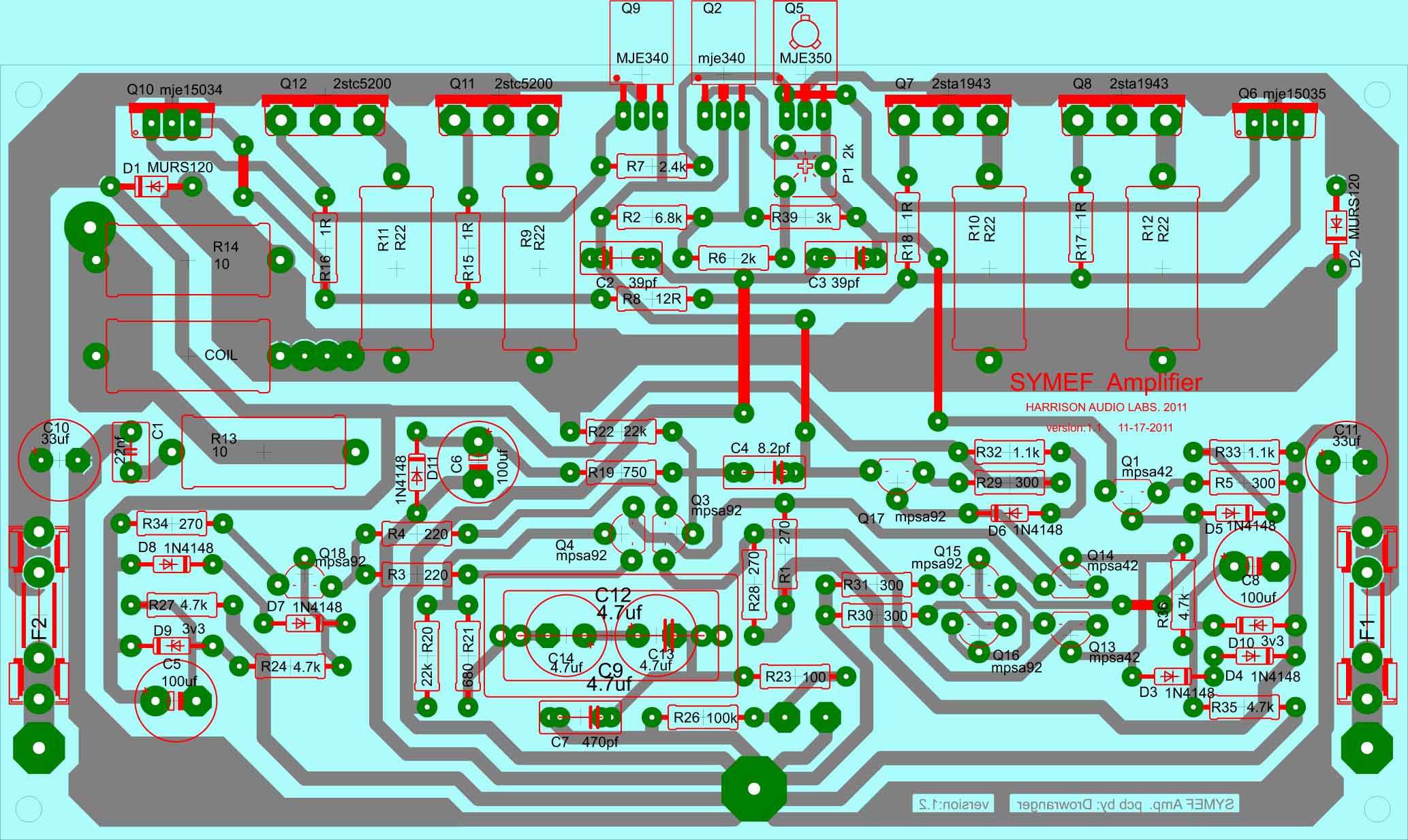

regards,
joel
Hi Joel,
Nice progress.
In reference to your schematic and layout
For Q3 and Q4 only: if you cant find the KSA992, Use BC556B or BC556C. If you cant find BC556B or BC556C use 2N5401. That is their order of preference for Q3 and Q4. 🙂
Let me get you right...for the rest of the small signal transistors you are planning to replace MPSA92 with 2N5401 and MPSA42 with 2N5551 ? That is OK.
Kindly consider using nothing less than tantalum for C10 and C11.
kind regards
change trimpot
it varies in differential transistor used.ksa992,bc556b and 2n5401 priority in order.
regards,
joel

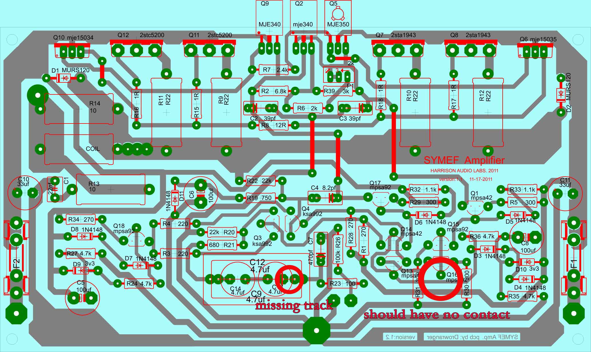

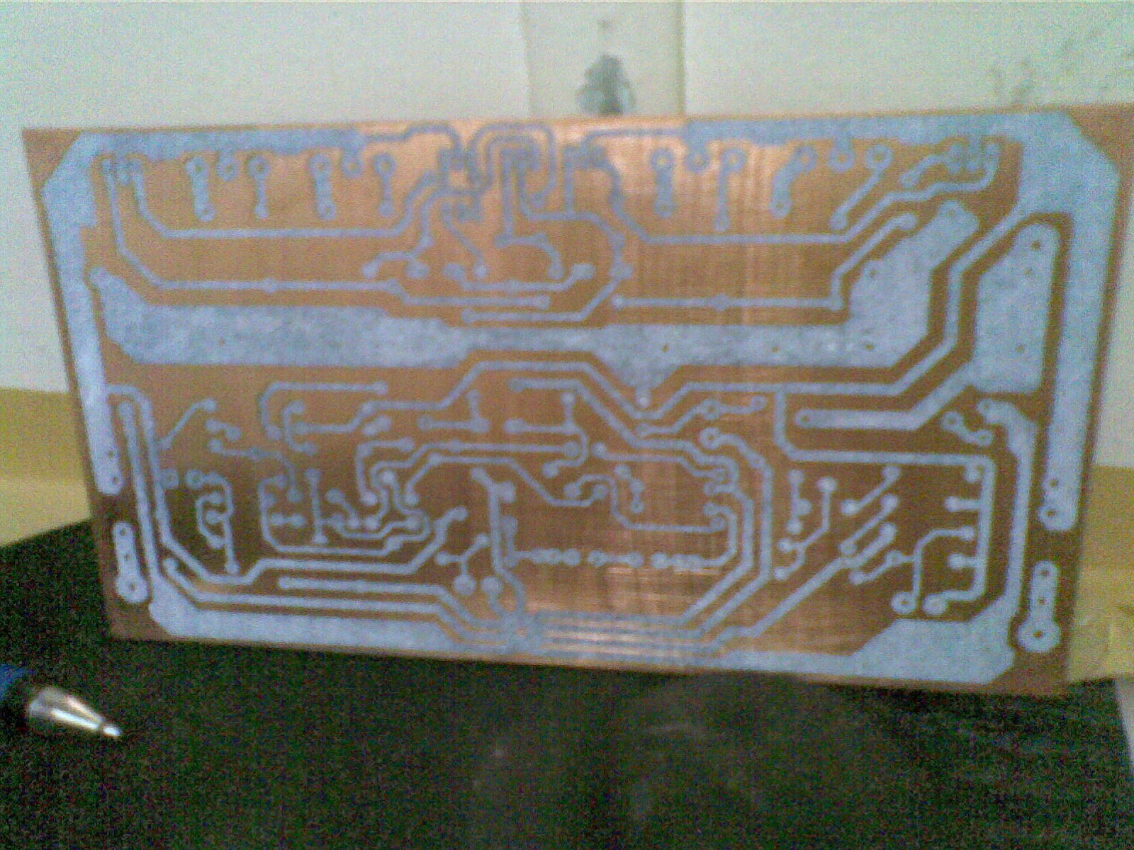

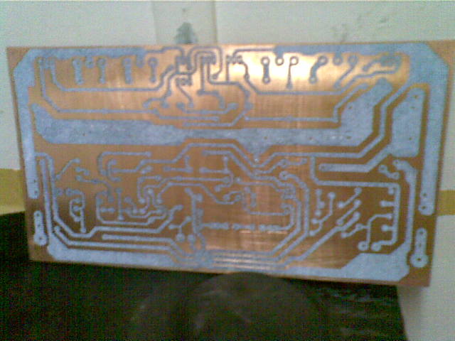

found mistakes on pcb design
I have finished making one pcb and have to edit today the pcb for small mistakes I made.sorry for the low resolution I'm using cellphone.
regards,
joel
regards,
joel

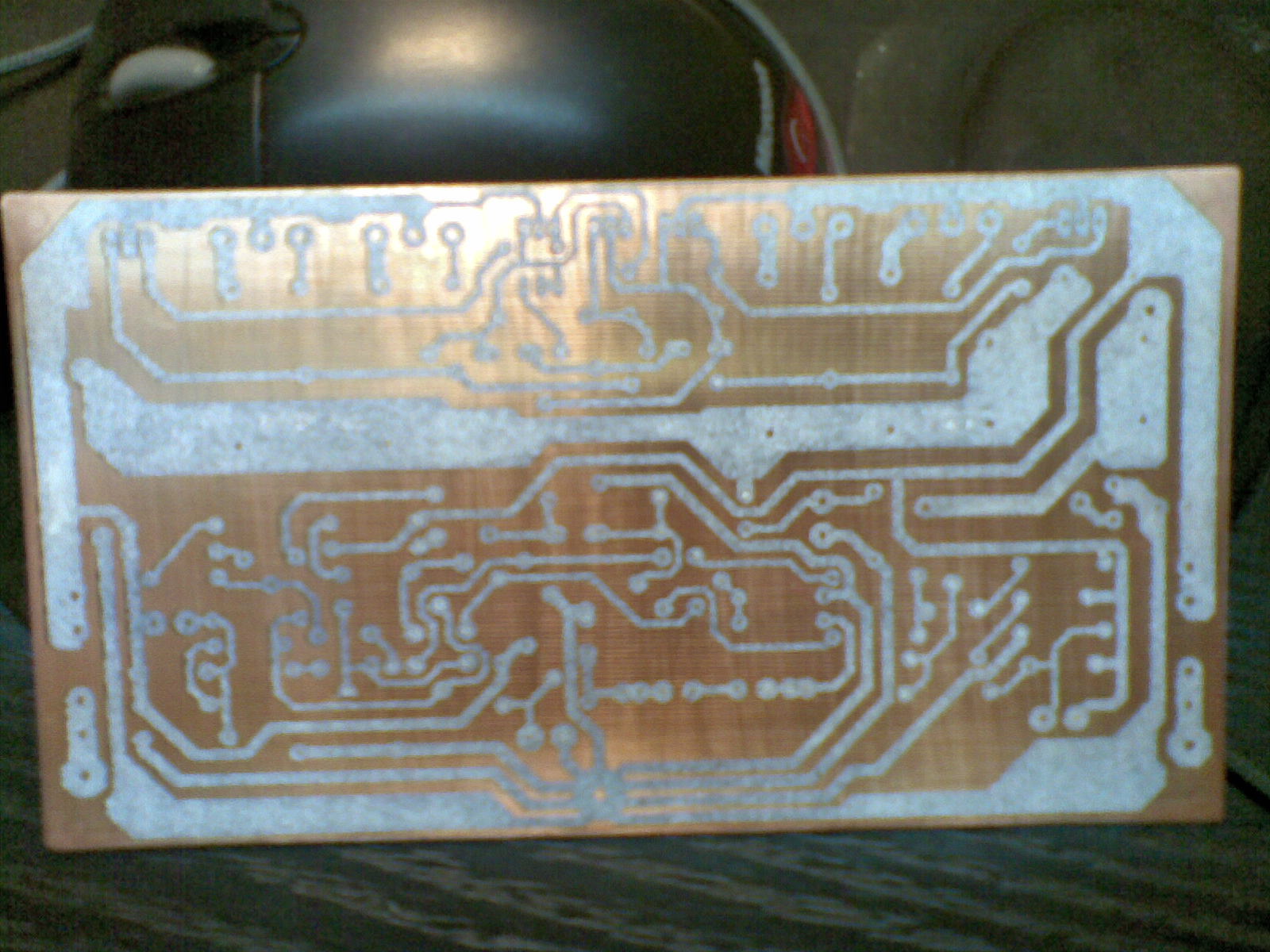

corrected tracks on bc556b pcb

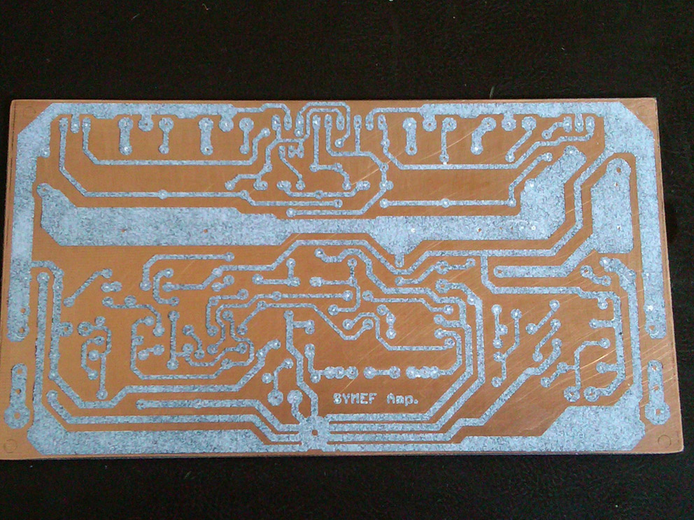

I have edited the pcb and also widens space of transistor driver pads suitable for toner transfer.In my experience having thick toner on photo paper and pressing the iron hard tends the toner to expand and fills the spacing between pads and tracks.and also check components pads vs pads vs tracks(clearance).
regards,
joel
p.s. will use this for the other pcb and post result on saturday.

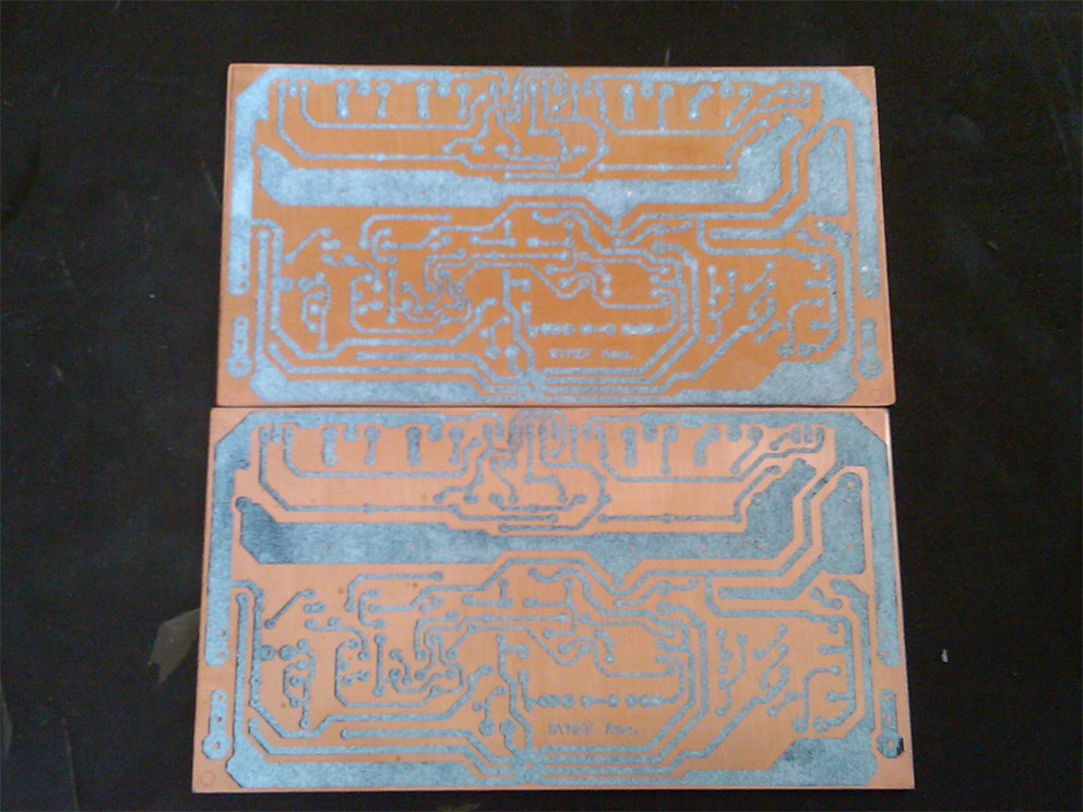

result for bc556b pcb post
I change my prevoius work with this latest layout for bc556b co'z I want the name SYMEF on my pcb.Next is to remove unwanted copper and make list for parts to be purchased.
regards,
joel
p.s. this layout is very suitable for toner transfering I have made the pads bigger and put enough cleara🙂nce.
