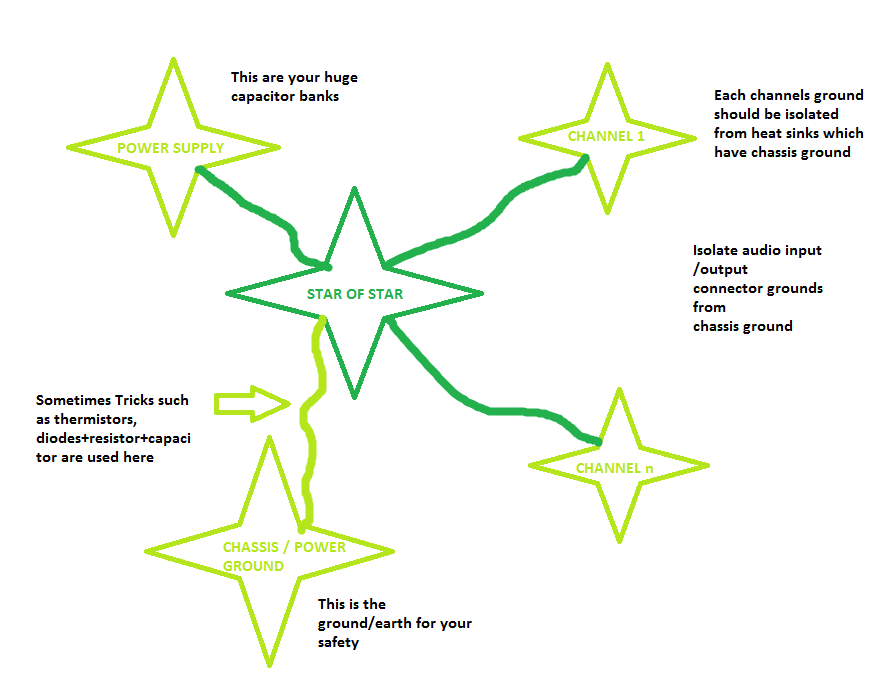

- in the circuit I have 2 gnd type: power gnd and signal gnd: how should I connect them?
1) together at the star center of the chassis ( so let them separate in the scheme);
2) directly short-circuited in the schematic > in the same pcb; ( I think so )
3) in the scheme by an RC parallel group (I've seen recently some schematics with this type of connection, or connected them by one low value resistor. In case: values?) ;

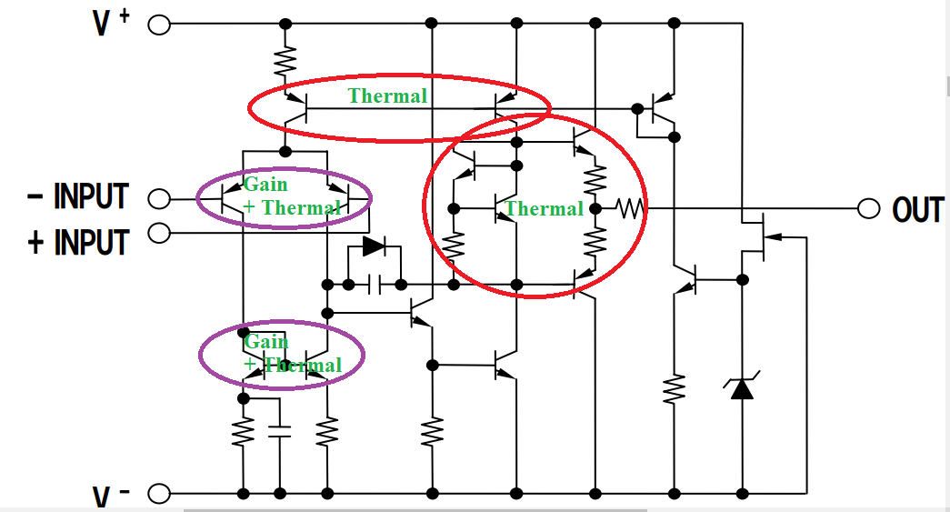

- I’ve to match pairs bjt of differential stage and current mirror ( same specifics ) ?; (I think so)
- I've to join physically the schematic critical parts ? I mean for example: joining by heat shrinkable sheath ( or another way) input differential bjt Q18 and Q19…other example: joining by heat shrinkable sheath the mirror current Q13 and Q15 bjt …and so on...). ( I think yes)

Within the pcb where the ground lands can be the local pcb star ground from where you source low current ground and high current ground. The purpose of the ground raise resistor is for discouraging high currents from using that path, sometimes the resistor isn't even necessary
good morning guys, ciao On, thanks so much for your replies . The gnd star center configuration you reproduced above is exactly what I have always foreseen and implemented in my equipment, to avoid noise and ground loops risks. I must say that it has always well worked: they are very silent. I see that you haven't provided any answers about the union of bjts, so it's reasonable to think that it's not that crtitical.

Matching isn't all that critical for this circuit. The vbias bjt provides thermal feedback. The output stage isnt cfp. for fun you could have an experimental proof of concept pcb where its on its own heatsink, add board fuses and see how much bias and how long the output stage lasts before going quiet.
...I assumed thermal feedback...but I tried the same...ok, I'll put the bjt on the same heatsink...thanks again On... Best regards Ros
symef has a polite input stage not as aggressive as other approaches that need tight integration of input stage

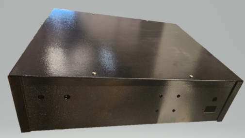

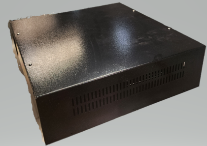

This two piece is
- Sturdier
- Quieter
- More electrically compliant
- Spill proof
- More aesthetic
- Easier to work on
- SYMEF amplifier
