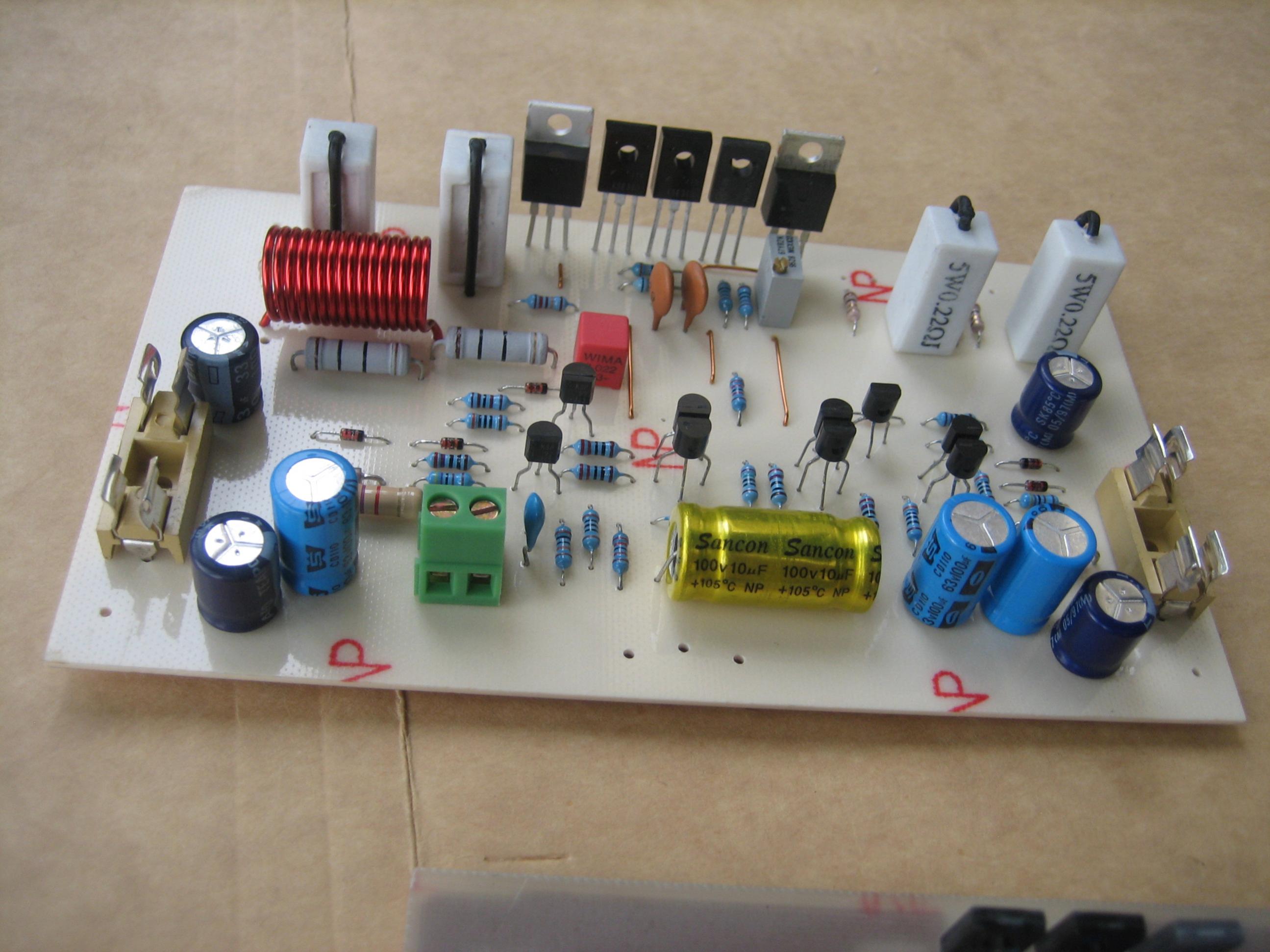

OnAudio Sir,
Any other suitable value other than 8.2pf? I could not find one with this value in my place.
Thank You!

Dear Abetir,
You could work with the following tolerances 1%, 2%, 5%, 10%,15%, 20%, 25% . If choosing a lower value limit is 10%. If choosing a higher value limit is 25%.🙂
Let me also take the opportunity of welcoming you to the club of exclusive amplifiers. Thank you for joining us. Nice board, looking forward to your completion and review.😉
kind regards,
Harrison.
