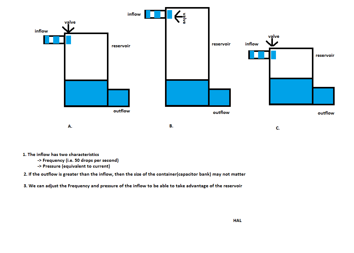

These numbers seems a little Chinese (or Greek as they say) to me. I stand to be corrected, but to store 3200J a 1 Farad Cap is required (since the caps are in series for each 40V rail 200 x 10 000uF caps would do the trick at a cost of around US$1800 at Mouser.)
According to Mr. Ohm's law P=I^2 x R; therefore P = 20^2 x 8 = 3200 watt, or into 4 Ohms P=1600 watt.
Your calculations are correct, but with this amp using +/- 40 VDC you will only be able to draw 10 A if you use 8 ohm speakers: 80V (p-p) / 8 ohm = 10 A
But with a +/- 60 V PSU (as suggested in this thread) you can theoretically pull 15 A with an 8 ohm load. That means 15^2*8 = 1800 W (!!!).
To get 3200W out of an 8 ohm load you would need to use +/- 80V PSU. 😉

I think we're all on the same page. I was merely trying to demonstrate that huge transients (neighborhood of 20A) is completely possible in this design (@ 4 ohms) and therefore an air-core inductor is the only sensible choice. I was also trying to point out that the "3600W figure" is simply not possible as increased load @ 8ohms effectively halves the Imax at the stated voltage (+/- 40VDC == 80V p-p).
The equations I have provided are all assuming DC voltage (and are "worst-case" scenarios if you like). The 3600W, 1800W and 1500W numbers that are thrown around here (jokingly on my part, I assume the same for everyone else) are merely to demonstrate the maximum impulse power and in no way meant to say anything about the rating of this amplifier (which is somewhere around 150W into 4 ohms).
I hope I haven't confused anyone..
