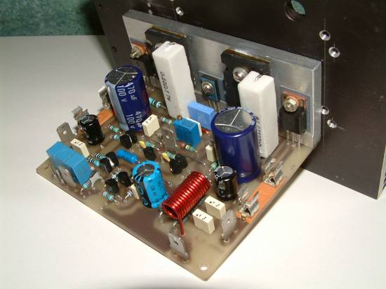

Back in the days of 2006 you posted a photo of an 11 kHz square wave into an 8 ohm resistor. This side steps questions of stability with loudspeaker loads.
I challenge you to post one with that load with a 2uf capacitor added in parallel.
Hi mjona,
Good catch, but the test was done without an L/R on the output purposely. I recommended it be added externally since there's no room on the board. IMO a better place to put it anyway. 8//2uF is pretty extreme test more common in electrostatic speakers than regular speakers.

One of my versions of Symsym L//R included (c 2006)
Brian

I posed my question about stability margins and 8 ohm plus 2 uF in parallel having looked at the claims made on Mr Bittner's website. For me this would be the quickest way to resolve what I saw as a credibility gap firstly over a figure for gain bandwidth for the 5.3 version of approximately 400 MHz and a phase margin of 90 degrees.
There is a link to a version by Mr Macura whose assessment is 1.4 MHz. He gives a stabilty margin of 56 degrees on the basis of -124 degrees at that 0 dB point. The link to the plots does not work however I think the phase shift figure is in error.
It is known that stored charge effects in Class B transistor output stages cause delays and phase shift from a point a decade in frequency ahead of the start of gain decline in loop gain. A reversal in phase to -180 degrees will always arise before the feedback gain has decined to less than one.
If the quoted phase margins have substance then the proposed test load should indicate a satisfactory result - free of significant overshoots, or ripple effects. I have strong doubts over this and no backer seems willing to take on the challenge.

Your Little Killer Amplifier does O.K. on that test load so it should handle transient signals in a real life situation.
However this follows a common practice in using a small Miller capacitor across the voltage amplifier transistor to create a single dominant pole at high frequency. This strategy has another advantage of making that stage more linear since it is an inverting amplifier.
You would perhaps want to add a low pass filter on the input to ensure the signal input does not exceed the slew rate capacity of that stage.
I suggest your Little Killer Amplifier sets your benchmark in terms of transient performance in a practical situation.
My question to you is whether or not your more complex Symasym with various forms of compensation can match this on the same bench load.

I built a few SymAsym amplifiers. I originally built one as a utility amplifier knowing it would sound good. Well, it sounds great. I have 6 more boards to build after I am finished some modifications (2SK170 pair for one). Yes, matching pairs of transistors really helps the sound quality out, but this is common to all amplifiers. My original 5.3 builds sound great even now. Do I have stuff that sounds better? Sure I do, but they are more complicated and higher power. I listen to the SymAsym, which was not the intended use when I first built one. For the money and output power, these are hard to beat. This would make an excellent first amp project that will reward you for years to come.
mjona,
People are not having a problem with these amplifiers. There was initially an issue when using different output transistors, but adjusting the compensation fixed that right away. Today there are versions that use all kinds of outputs. It is reasonably forgiving as long as you adjust the compensation if you use different outputs than they were designed with. No surprises there. I used the On-Semi MJW0281A and MJW0302A - excellent. I don't know what bugs you about the SymAsym, but give it a rest. More versions of that amp exist in the world than most any other "community kit" amp, not unless amps designed by ostripper have been more popular, and they may have as I was away for a few years.
-Chris

You do have an excellent sales pitch. All I have asked for is for someone who has built one to post pictures of the 10 kHz square wave into 8R//2uF. That would be the perfect ending, so why not just do that.
Hi mjona,
I don't have a problem doing that, but my amps are inaccessible for a bit. If I complete another I would be very happy to post the results.
I don't know if these are the most stable amps around here, but mine have always been very "settled". Not much seems to bother that design. One thing I didn't do with it that is normal for me is to take measurements, except when I set the bias current. That was only to find the correct bias point for this amp. My measurements are back in the original thread. The bias setting is very low, maybe 15 mA +/- 5 mA for minimum THD with the clearest residuals off the THD meter.
When I get ahold of a poorly performing amplifier, that is when I go all out with measurements. I'm looking for a problem then.
I'm not trying to sell the SymAsym. It's a great little amplifier (50 wpc), and would make an excellent first project, and something that would probably be in use for years. The work that ostripper has done has me planning to build one of his next. If it sounds better than the SymAsym, ostripper has designed a giant killer! This, I want to experience. I guess I should be looking in the 150 ~ 250 wpc range of amplifiers. The Marantz 300DC (modified) is my best amplifier. Its rated output is 150 wpc, with +3dB headroom!! That and Marantz products generally can produce 10 ~ 25 % more power than the printed specs allow. That is a tough amplifier to best.
