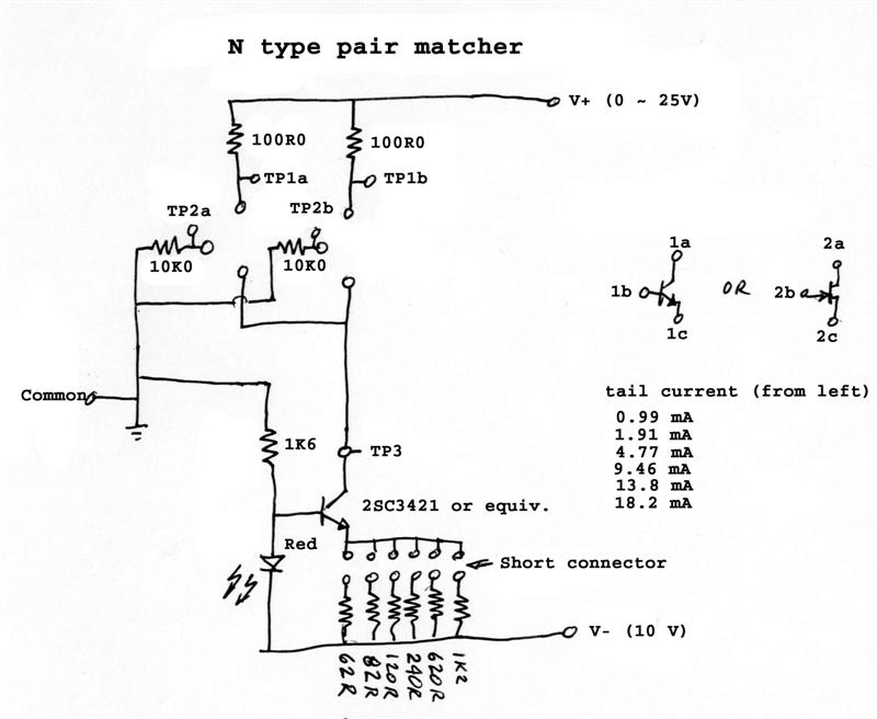

Hi Andrew,
I use a pair of inexpensive four position sockets. They are mounted adjacent to each other as you would set up a diff pair (guess what I was thinking?). I use a big alligator clip to hold the transistors together for thermal coupling. I will use heat sink grease if I am being very careful. They are set up with a matched pair of resistors in each collector / drain and also in the base / gate lead. I'll include a diagram. Bear in mind that I labeled the current select positions reversed.
A CCS regulates the tail current and is settable with a dual header strip and a short (as used on computer boards). They can be added together to select current levels. The current setting has some error term at the higher levels if you want to correct the resistance used.
The trick is to measure between the drains for a null. If they are at the same temperature, this is all you need. You can also measure across the base resistors and collector resistors to figure out BJT beta at different current levels.
Keep in mind it's a simple circuit. I use an HP 6236A or 6237B to run it. I do tend to test at a D-S (C-E) voltage around 10 VDC. This is in keeping with most actual circuits. I don't care what the specs say the devices do at 5 VDC, I never run them that low.
I did match some parts quickly for EC8010, but I don't know how they worked out for him. I suspect I have to allow more time for the parts to equalize in temperature.
-Chris

Hi Al,
The switching should be done electronically. If you could load it up and run all the parts, it would reduce the settling time. It's just that the premise I used was that the parts would actually be a differential pair.
If you look at mine, it can be improved. I designed and built in within an hour and didn't actually expect to use it. I am, so I will need to rebuild it at some point.
-Chris

Chris seems to get stability from his set up. I tried measuring collector to collector and the mV wanders all over the place. -20mV to -5mV in half a minute or so and back again with little ripples in the journey. (the difference tells me this is not a good match but all i need to do is find a pair that has a similar error).
I wonder if the real power amp LTP wanders like this? Most are not thermally coupled and most do not have a regulated supply.
The major difference between Chris' and mine is the CCS and thermal coupling.
The CCS is easier than building up a SIL based jig. So I'll try that first.
It is just possible that mains voltage causes tiny voltage changes in the lab supply and these impinge on the resistor ladder voltage feeding the base.
The SIL idea still works. Just unclip the bulldog, slide along to the next DUT, re-attach the 3pin plug, switch on the current & measure again.

Hi Andrew,
The CCS really helps settle things down as the pair will share a set current. This greatly reduces small shifts in your power supply.
Yes, this is how they operate in the real world too.
When I install pairs of matched parts, I use some thermal compound between them and use heat shrink tubing to keep them attached. I stick the leads in a proto-board (about all they are good for) and shrink the tubing there. Once cool they are pretty stable.
Anyway, if this quick little jig helps anyone out, then great. I find that it works for me and it's much better than trying to measure each part. I used to do that, not any more. The jig agrees with real life. The original reason I built it was that some pairs I matched did not seem to be matched in circuit. This jig conformed to what I saw in real circuits and so became a great way to confirm matches. Then I noticed it was far more sensitive, so I skipped the measure stage completely. I do measure one to get an idea what the beta is (for BJTs). You have to accept that absolute beta varies a lot. Getting a beta match that tracks the other is far more important.
-Chris

I tried Anatech's method of CCS and bulldog clip.
Short term tability is much better. The pair also become temperature stable more quickly.
Still a bit slow needing at least 30seconds to nearly settle. But consistent.
Went back over previous nights DUTs and found most results were out by quite a margin (+-2% of Ic) but very quickly found a supermatched pair and left them running on extended test. Same result, matching Ic+-0.2% and gain +-0.5% and identified a matched pair (+-1% on both parameters).
What did come from this, is that the supermatched pair tracked each other fairly closely as test voltage was adjusted 31V down to 25V and also at three test currents.
Whereas a pair that are out by +-2% on IC do not track as CCS current is changed. I have three CCS emitter resistors giving 0.94mA, 1.33mA and 1.72mA combined they give 2.66mA or 3.05mA straddling the Symasym 2.8mA

no, I like the jumper/s selecting a combination of fixed currents.You could make it (CCS) variable too.
I made up a negative CCS first and could not understand why it didn't work (selected a 2sa instead of a 2sc - oops) but when I reversed the LED all worked properly (some BJT are surprisingly robust with reverse polarity). Then had to make a positive CCS to test the NPNs.
Now all I've got to do is find 18 matched pairs for the six PCBs.
