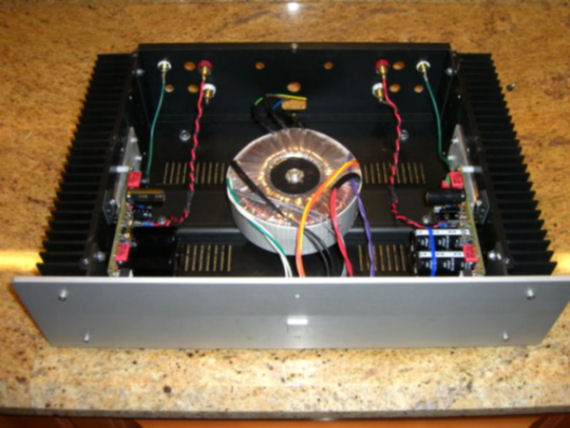

I finally have my prototype Symasym (the new mosfet version) in an enclosure. I put them in an ATI enclosure that I recently purchased from the trading post forum. I did have to modify the enclosure a bit in order to mount the boards, but it came out really nice. Now I just need to build two more Symasym modules to complete a four channel amp. Here's a pic.
Al

Hi Al,
That has a chance of sounding good too.
Changes I might suggest would be to increase driver current some and eliminate those source resistors. You may need to install a resistor in the bias transistor's emitter to more closely track the FET tempco.
You should use source resistors if you need more than one pair of outputs.

Some pix when testing the amp in the chassie:
As you se I had to stack the trafos,as this chassie was first intended for the original Symasym pcb with one trafo.I am going to do some woodwork to cover the trafo on the underside..anyway I got a pretty good airintake now..
Testing the top,but the pcb´s are about 0,5mm to high.. will fix that,infact I had to use my dremmel to take 1mm of each output transitor to...tight..😎
The trafos are now connected in phase (minimum noisefield)
Will fix all these small details before testing the amp on some more decent speakers,at least its working now..🙂
