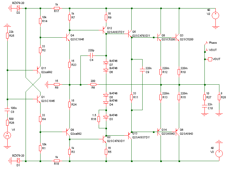

hello the DIYers, I agree with Mr.line up. Mr.bonsai must submit and publish schemes diyaudio forum.
This will definitely make it easier to discuss the details.
Not many bother to download a PDF.
Hello Wahab, you have posted the nx-Amp schema (thats the 100 W amp) and not the sx-Amp. As you note, thermal comp is different. The sx-Amp does not have the drivers and the bias circuit is different. I have no problem in posting the circuits up. I am surprised to hear that people don't bother to download PDF's. The sx-Amp has been downloaded about 200 times, the e-Amp over 600 times and the nx-Amp 100 times. The Ovation 250 schema has been downloaded 600 times . . .
