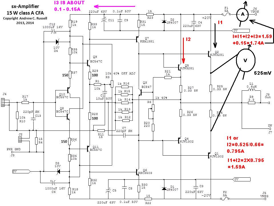

By the way, when I mentioned in post 1840 that the current should drop to zero, I meant in the output stages only - you will still pull current in the front end and TIS stage
Balu,
Across R24 (0.33R) and R25 (0.33R) = 525mv
This is 795mA per pair = 1.6A in the output stage excluding current required for the fron't end (another ~100-150mA). You should be able to adjust it down, so it seems you are at the top end of the adjustment range.
Can you take out R20 completely - the current should drop to 0 or a few mA.
But, before you do that, can you measure the voltage at the output wrt ground - it should be just a few mV.
Also, make sure your Zobel is connected correctly. *I once had the speaker output and the Zobel swapped.
Thanks Bonsai..
The Zobel is connected correctly, verified this. I will focus on fixing one board first.
The voltage at output w.r.t ground is -11mv.
Taken out R20 completely and when i measure current across POS fuse, its about 0.7A to start with and raising quickly all the way to 1.15A in about 2 mins. Its sort of hovering around 1.19A levels. Tested this for about 15 mins.
Across R24 and R25 its 350mv.
If its useful info, R30, R31 are 15 ohms as indicated on pcb.
One more observation: After taking R20 (its floating), adjusting R6 is increasing the current.. is this expected ... If i take out R20 does not it also take out R6 out of circuit??
Please advise..

hello, everyone!
i have built the nx-amp few days ago and today i got the chance to test it. i was very exited because i gave a lot of effort on buying the correct parts and not making any compromise... but unfortunately it didn't go well... :/
i bought the original pcbs, the parts were mainly from mouser, only transistors were from ebay, the output ones were matched, others no.
first power up went ok, adjusted the current to 300ma with no issue, emitter voltages were ok, ~40mv...
but when i tried to adjust the offset i encountered a big problem - minimum value is more than 2v and i cannot reduce it, no way.
the amp heats up i would say normally, there is no excessive temp from any of the components...
only difference to the original specifications is the trafo which is 35v so i get 50v on the rails, but that should make no difference for the offset, right?
is it possible that i got this problem because i didn't match any small transistor? but i at least followed closely the gain grades, they match the board markings...
any idea what could have gone wrong?

With 2Vdc of output offset the DC detect should have triggered turning off the SS relay.
It is off? Both relays go to OFF when either channel has an excessive offset.
yeah yeah, it goes off, detection is ok, i forgot to mention that, but anyway i continued testing with only +0- connected... like mentioned in the manual...
EDIT: i'm sorry, i noticed a mistake now. it seems that i followed the photo from the manual instead of the board layout when installing C6, i made the same mistake as one user few pages ago, i was just browsing and noticed the same problem with my board... no time now to correct it, will try later and come back with the results!
