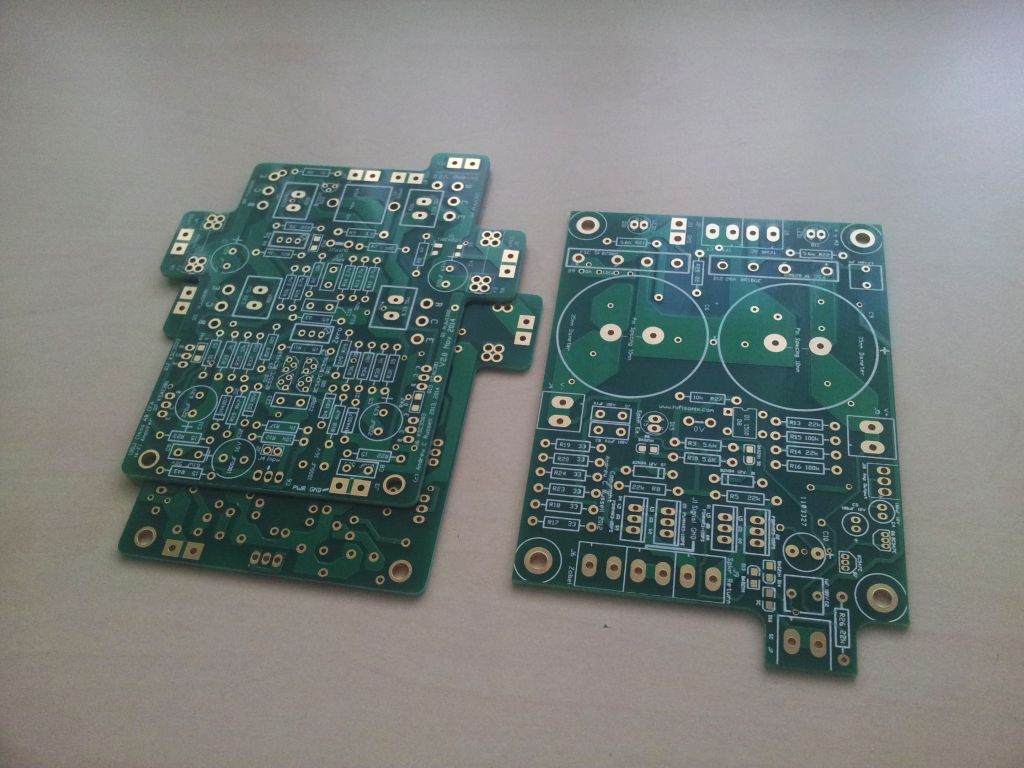

Thanks for sharing such great project for diy ... please do you mind uploading the PCB files .. it's not available at the site now " New file to be added shortly" besides if it's available in PDF .. i'm not good dealing with gerber files i think it's for mass production or to be manufactured .. i will just DIY my own use...

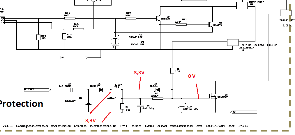

NX amplifier PSU testing

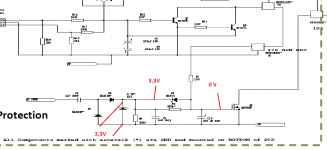

Hi bonsai I was just building your NX amplifier.I have one doubt regarding the PSU testing. I have completed the PSU and is now tested with a testing transformer of 22-0-22 ac .I can see the D15 speaker engage LED blinking when the power applied I cannot see any time delay there.Is this issue with the input voltage which is less applied here instead of 34v ac or any other can you guide me on this.
Hello hifiramr
Unfortunately the solid state speaker relay will NOT engage with 22-0-22 VAC transformer rails. You need at least 30-0-30 rails and my recommendation is 34-0-34 Vac. After rectifying and smoothing, you should have 50-0-50 VDC.
Also, running the nx-Amp of such a low supply voltage (22-0-22) will mean very limited power, and probably much higher distortion than necessary.
(Apologies for the late reply BTW)
Thank you Bonsai for your prompt reply.I will arrange 34v Ac transformer and will check it.I will post the update here

Thank you Andrew for the reply.As the power supply was tested with 22-0-22 the delay settings is working fine now I have replaced 2n7002 diode and PDTA114ET.I use this voltage only for testing PSU the protection circuit was not tested.I have done a mistake in getting one parts that is PSMN4R3-100PS 100V 4.3mΩ TO-220AB N-channel NXP.I ordered a compatible one with 44mΩ.
