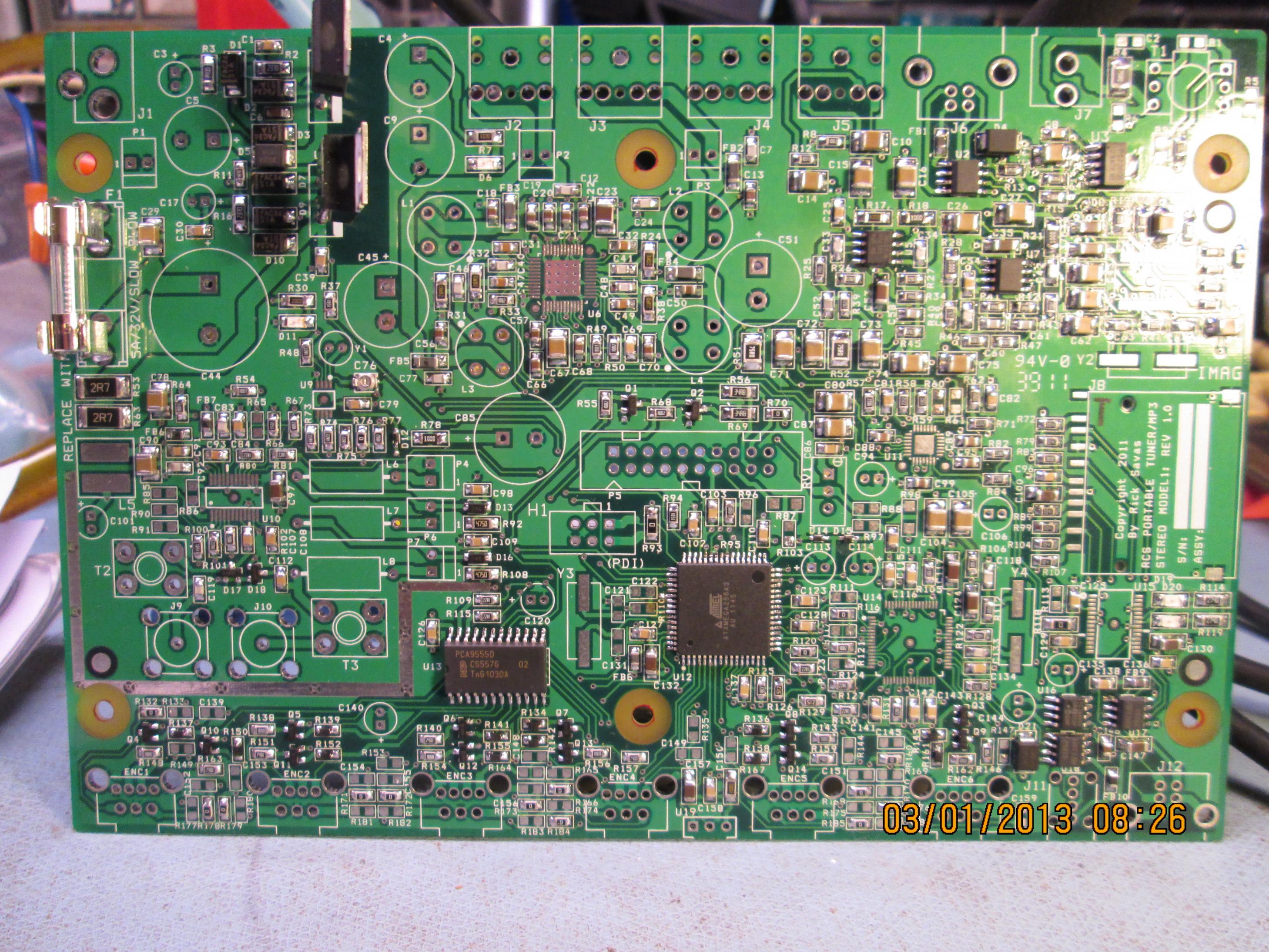

OK, so I'm all ready to start soldering my parts and figure I'll start with the SMD parts. First one I grab is BZX585. D17. Can't for the life of me find it on the PCB. OK, I set that aside, and grab BAS21H. D2 & D6. Great, I find them on the PCB get ready to solder them and it dawns on me I don't have a clue which end goes which. Seems the polarity is not marked by the silk screen. Guess I need some help determining the orientation. Someone who is familiar with SMD please help me out.

Assembling using SS alone, is not a very good idea, unless it is very well done, which it does not sound like in your case.
Assembly drawing/BOM are the references to follow. In many dense designs, 0603/0402, it is hard to see comp's using SS.
Do you have a 10x magnifier?, I use both a jewelers loup and have one of those headbands as well.
It is almost imperative to have magnification for SMT, regardless of type.
Also good light, as at times you have to view comp markings on a angle to get the right contrast. Many comps are laser marked/etched, so it is difficult to see, unless you have the light/angles just right.
Good tweezers, no-clean glow core solder, two irons with fine chisel tips, are the ticket. I have done SMT since the 80's.

BAS21H diode will have a line to mark cathode.
If in doubt, always check mfg DS, they will show markings, even give the code, which is 2-3 digit code, ie "3A5" to confirm it is exactly what it should be = more 10x mag, see my point ?
I always do the passives first, starting with C's, R's. Gets you warmed up for the fine pitch stuff.
THT stuff at the very end.
Sometimes, I will assemble partially, like PS, get it going/test then continue.
Place very small bit of solder on one pad, place comp, using tweezers, re-heat joint and get comp aligned and flat, do the other terminal, go back and add a touch more solder on the fist pad so that you get a nice fillet. Inspect, use 50mil solder wick if you have too much solder. You aim for a nice glossy joint, with a fillet and no icicles.

Thanks for the tips. Fortunately I had just bought a magnifying lamp yesterday so I had that covered. My main problem was not knowing how to tell the orientation for the diodes as there are no markings on the PCB. I thought I was missing something. I finally just used the schematic and followed the traces on the PCB to determine the orientation. I had watched a few videos on youtube about soldering SMDs so I had a bit of an idea what was in store. Not a fan right now. I spent more time getting those few parts soldered than it usually takes to solder up a whole board of through hole. Learned something new so it's OK.
