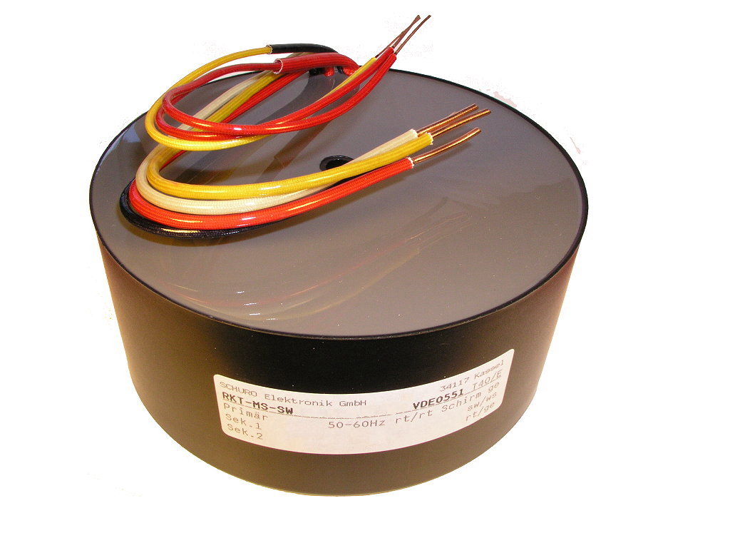

Hi Patrick, yes I did use 35Vac.
http://export.farnell.com/multicomp/mcta500-35/transformer-500va-2-x-35v/dp/9532951?Ntt=9532951
I ordered a 400VA from antek on ebay
400VA Antek Power Transformers An 4234 | eBay
Item #370951442131
Item #370951442131
What are you guys using for the TIS transistors? I can't find them in the same grade.
Thanks, Terry
Thanks, Terry
The Antek transformer arrived today. Unload it puts out 36.7VAC and rectified is right at +-50VDC.
