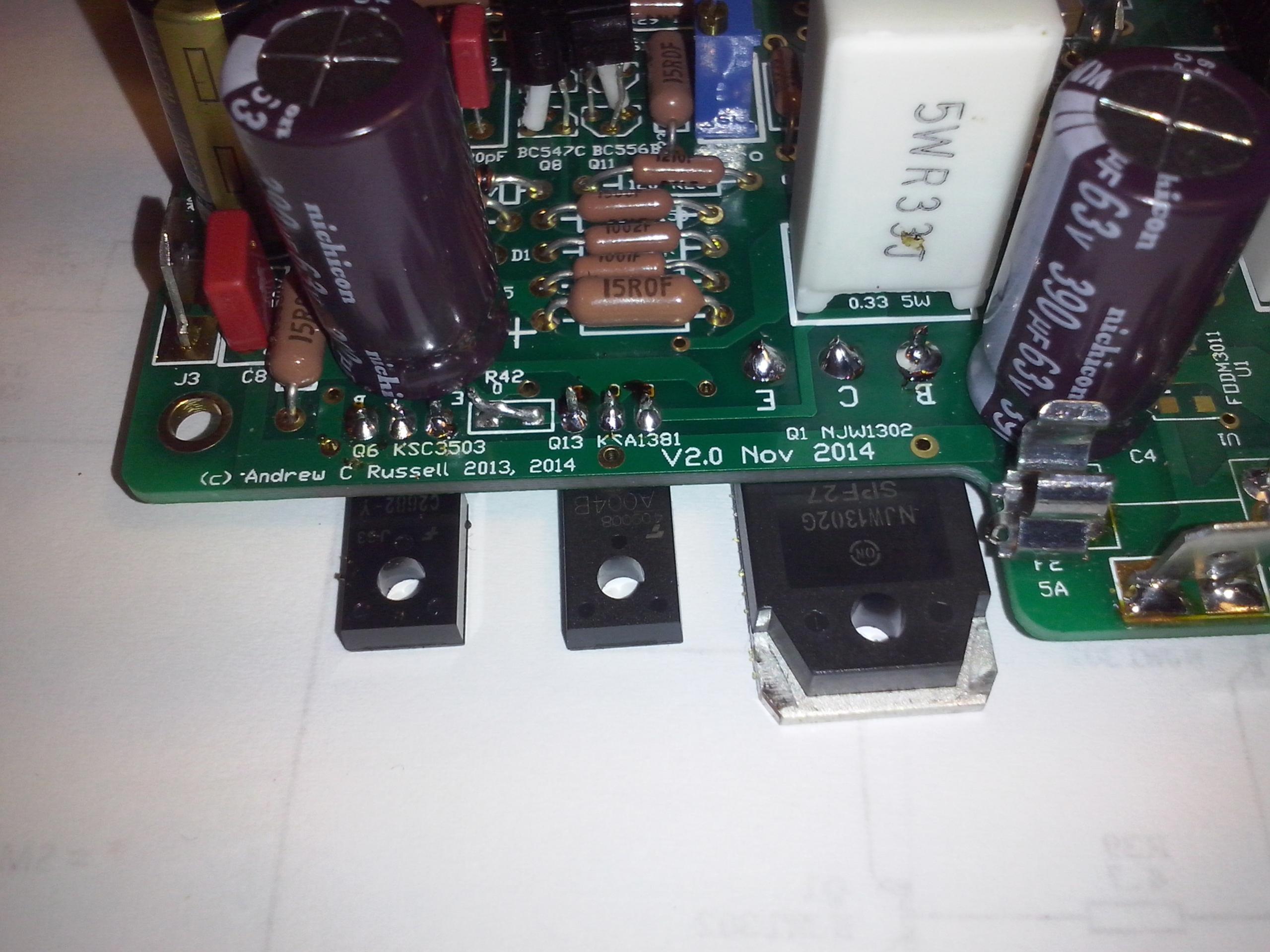

Have you downloaded the latest sx-Amplifier doc from the website (V2.10)?
There is no BC847 in the sx-Amp.
The BC547C devices may be difficult to get because a lot of semi vendors are moving away from TO-92 devices to SMD (SOT23 for example). In the first post some alternative types are listed that you can use.
C1 and C2 are 1206 devices - one filters the offset adjustment - that's the one near the 15 ohm resistor - and the other decouples the bias controller around Q3. These are very easy to solder - use a pair of fine tipped tweezers and a fine tipped soldering iron.

Hi Bonsai,
Thanks very much for your reply! The BC847 lingers on in the BOM although I couldn't find it on the board nor the circuit diagram.

It's the SX. But the 847 still makes an appearance in the BOM of the latest revision (item 19). The circuit board doesn't have any pads for it, either, so it was perplexing me!!
Therer are none 847 in that amp 🙂 Its probably a typo.
The BOM says Q3= bc847 but the schematic says Q3=bc547... The schematic is correct.
You can use bc550 instead of bc547

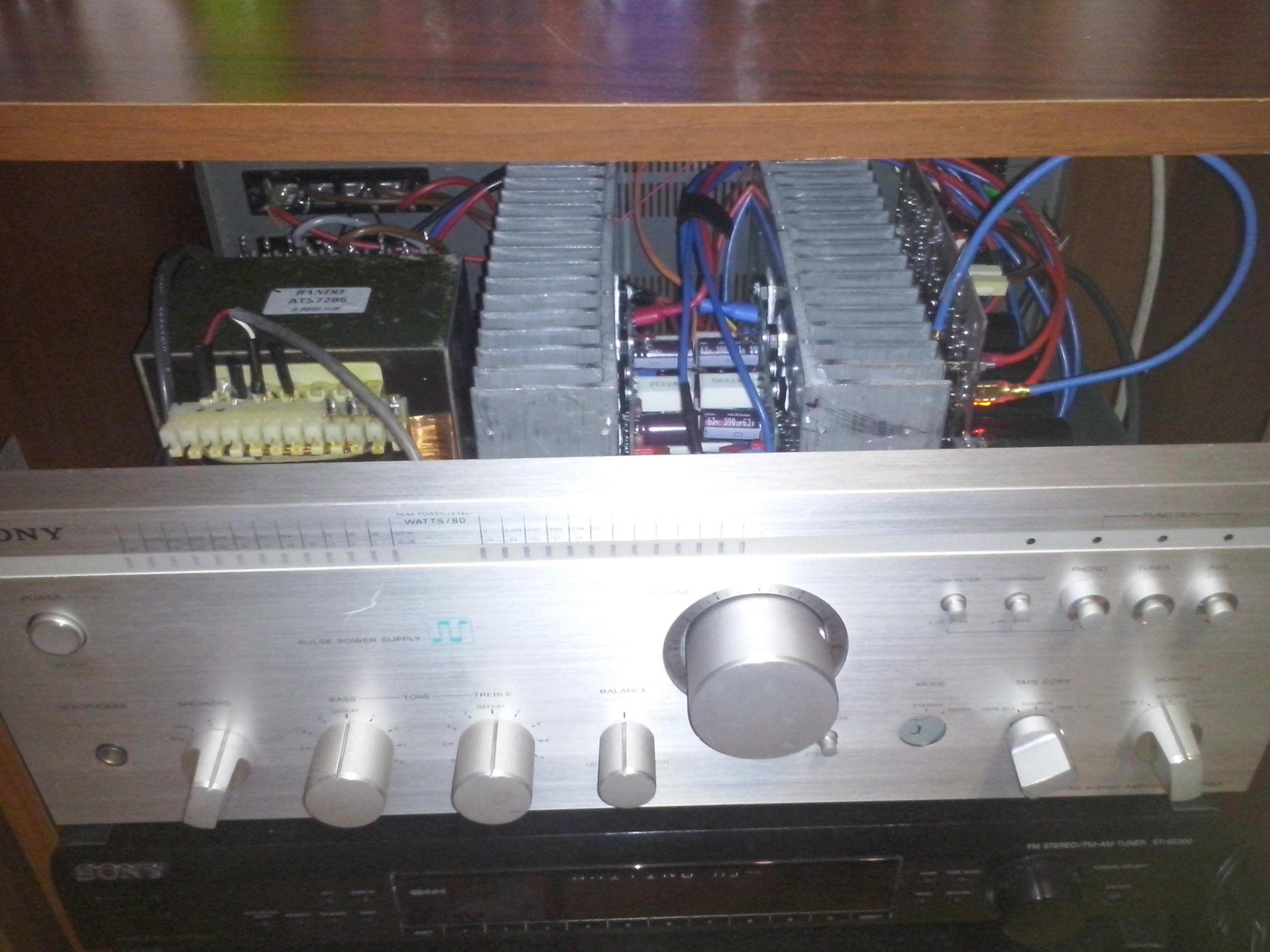

My nx it works great from the first time and it sounds much better than my old amp. I have used transistors KSA992, KSC1845, KSA1142Y, KSC2682Y, TTA004B, TTC004B, NJW1308G and NJW3281G. I had to use heat shrink tubing and silicone paste for KSA992 and KSC1845. I also managed to buy the body of the old Sony looks good and I am very happy, I like vintage. Now I needs to do preamp and fit it to the body. I want to make a simple version of The Ovation preamp but I do not see diagram 0dB Buffer in doc.
Very nice! Glad you like the sound!

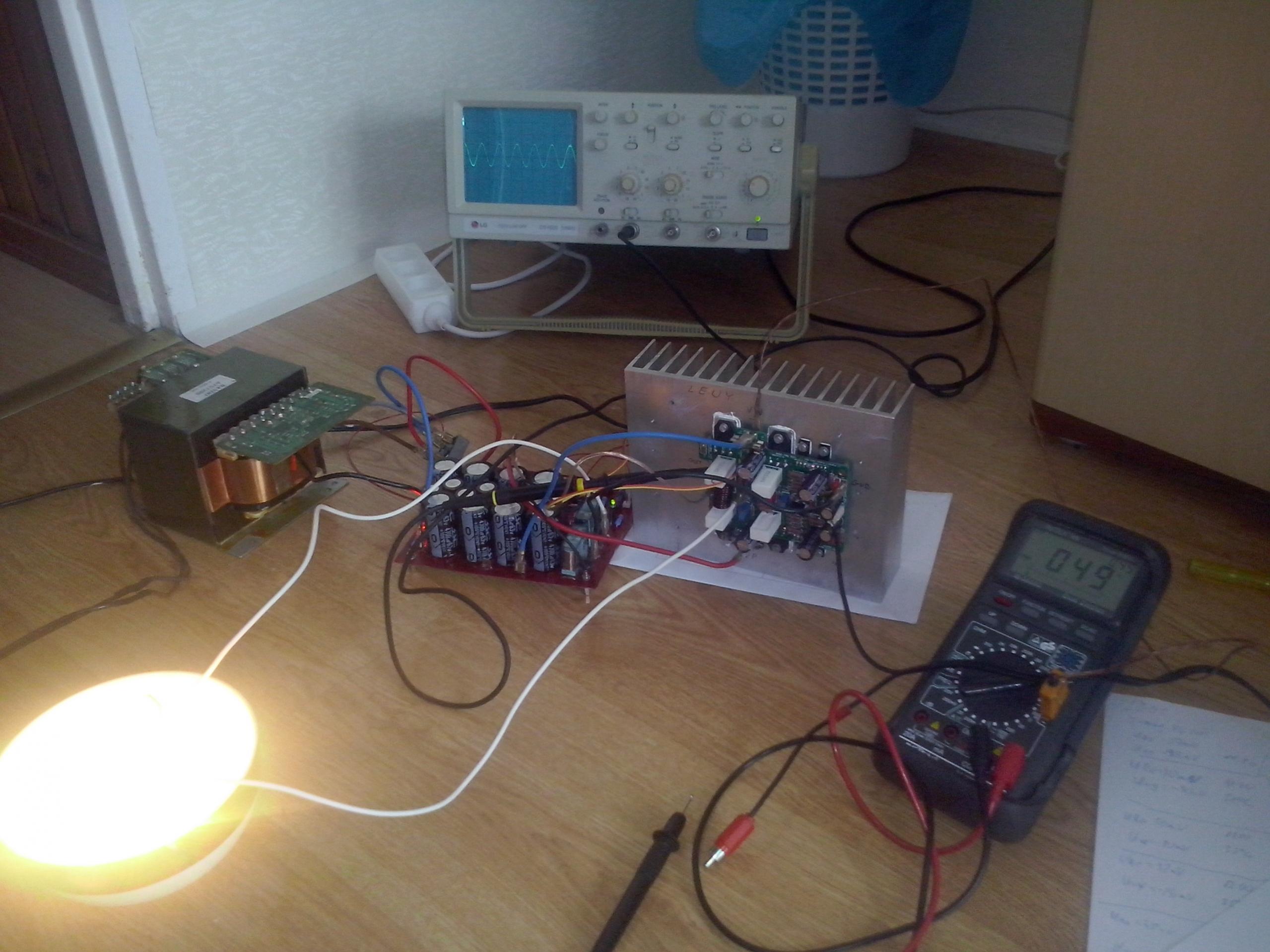

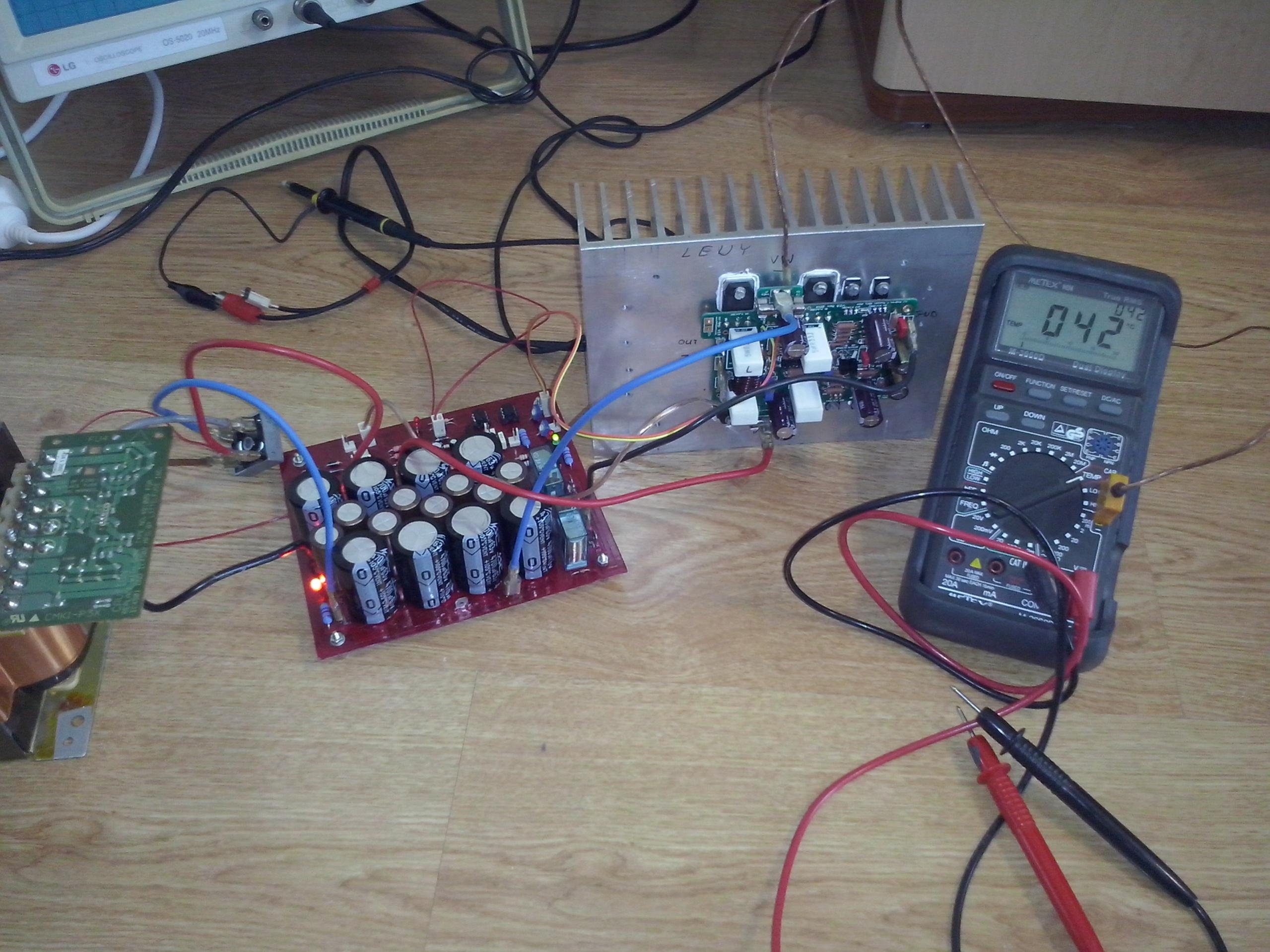

Progress report on the SX build,
Jims boards, parts from Mouser/CPC/Farnell/RS Components and Joshvi. Aliexpress case.
I now have the SX working.. I tested the amps on heatsinks yesterday and wired it all into the open case today as a lash up. I have been listening for a few hours and it is very good. Everything worked straight away and it was a doddle to set up the 1.4A and zero. The offset pot on one is close to the end of its travel so I will investigate this but there is no need to modify much as when warmed up the offset is about 3mV. The offset drift when warming up is only a few mV. Even with this quick connecting up there is no noise or hum, in fact I couldn’t tell they were connected to the speakers!
There is plenty of volume and the clarity and speed are excellent, the bass is very articulate and accurate. A most impressive little amplifier, and a lovely project to build.

I used BC550c/560c and matched them carefully, and thanks to Joshvi for the driver pairs.
