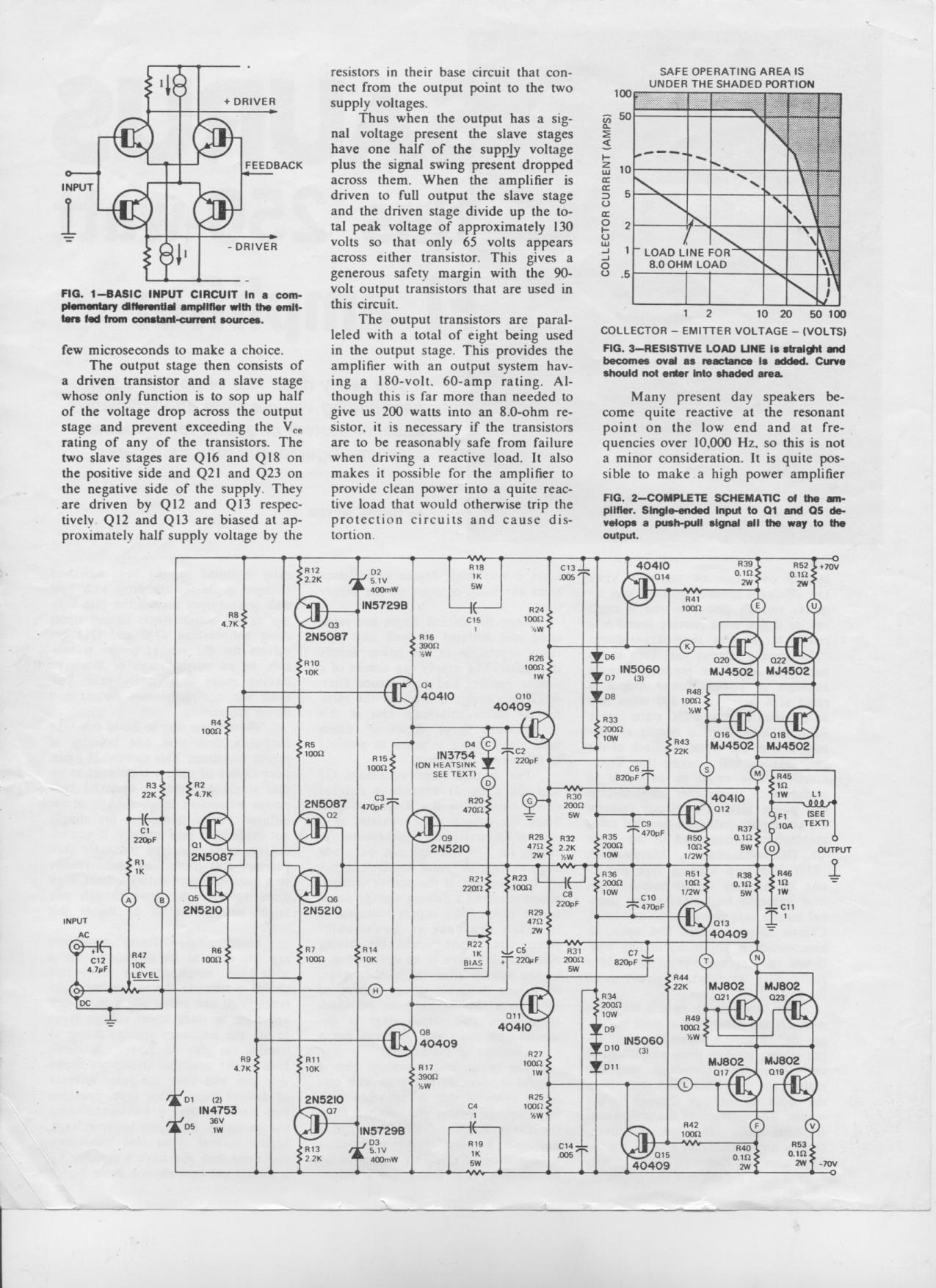

It looks like R26,27 are current limiting resistors for Q10 and Q11. They are a bit of a compromise. At 100 ohms, I doubt Q10, Q11 are protected enough when Q14, Q15 turn on hard. At 1K, they impose a rather low limit to the base drive current for the output transistors.
If one is to do away with the over-current protection (ie Q14, Q15), R26 and R27 can be omitted.
They do limit the current to some extent and also lower the Vce on the drivers under high current but they are not required due to the protection since the base of the output device is never more than a volt or so below the rail. They have to be 100 ohms or less and the max driver current into a short circuited load is determined by the sum of the emitter load and that 100 ohm resistor. I would go lower with more capable drivers. 1K would not provide enough drive to the outputs.

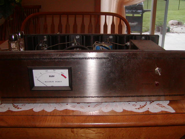

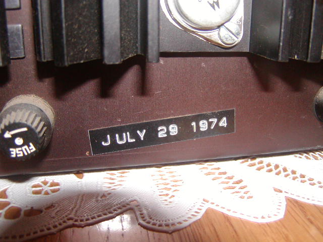

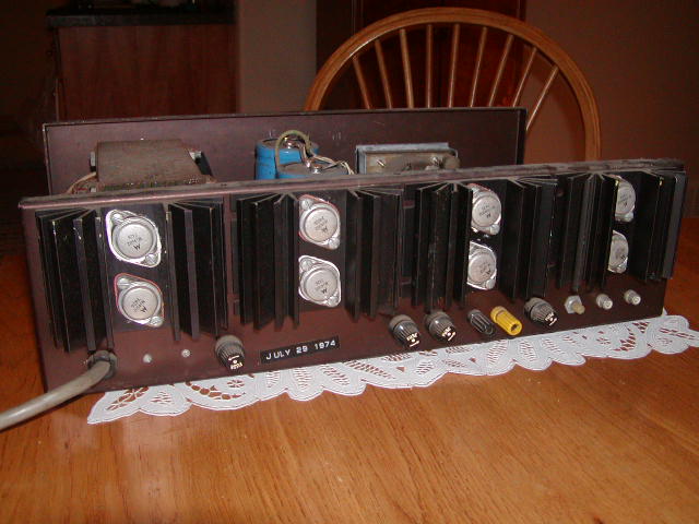

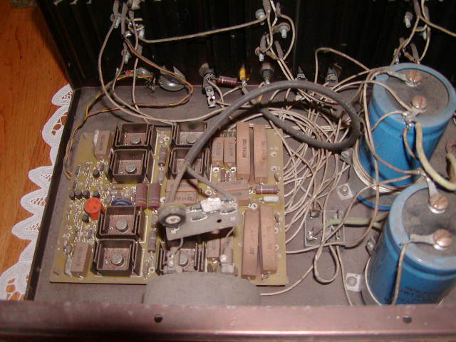

A few pictures of one that has not had the best of care. It still works however.
Mine have 100 ohm at R26,R27
I measure 10 ohm in circuit for R46
I measure 1 0hm for R45
C11 I have .10/250volt

I showed that the reverse Vbe of the drivers is exceeded in the simulation - you seem to ignore that. I mentioned a long time about about the output and probably driver SOA. I have a donated Marantz 250 that is blown, the owner was not a head banger but the outputs accidentally shorted and it blew: Marantz 250M Repair After looking at the schematics, and doing some simulations of it, I would never spend the time to try to fix it given what a mess it is. It is certainly a very different topology, there is a sort of virtual ground that the input stage drives into. Still, it is a complete mess. And it does have active output stage protection - obviously it doesn't work.

At the risk of sounding monomaniac again, wouldn't the big Tigersaurus be good candidate to modify the output into a cascoded one?
Just swap "outer" transistors "Q20, Q22" for "Q17, Q19" and vice-versa, making them run common-base, and then modify the signal path so the drivers (Sicklai) go to the "slaved" BJTs "Q16.Q18" and "Q21, Q23" in common-emiter configuration. Provided proper biasing and maybe other mods that I fail to see now, it should work. No need to get rid of the X4gain, because the amp should be hopefully stable into previous risky freq (faster output, lower Miller)...and sound good also.
But, would power headroom be compromised?
What do the experts think?

MaxLorenz: The circuit you show already IS cascoded.
Conrad hoffman: Your blameless sims might look good but if you build it with carbon resistors you will never get that performance. To me, those amps dearly lack in high-frequency performance and never escape that lin-miller sound.
Tony Tecson: You must not be familiar with Bryston circuits, as they have a gain of three in the output stage. The Tigersouarus as shown above has a very similar topology with low-voltage input section, output stage with gain, and cascoded outputs back in that era. Bryston switched to nonCascode when suitable BJT pairs became available and very quickly went to their Quad Complementary output stage in everything larger than the 2B.
Bryston's designer would have been smart enough to properly clamp the output stage, to prevent the severe overdrive and excessive reverse vbe. And not to use a dinky TO-5 to drive two pairs of high power outputs.
There are more modern output stages with gain that have good reliability records. Ther have a few more parts in them (diodes) and TO-220 drivers.
The problem with cascoding is that if the output stage misbehaves, you won't get a nice voltage division between master and slave outputs. You have to either prevent all possible misbehaviors, or use devices rated a lot more than half the supply. The more common EF3 cascode is a lot less susceptible to problems.

Guys,
Look at q16/18 and 21/23.
They are tied bases and tied emitters. They do not current share properly. To do it right, break the emitter ties add two more 100's. Also, the r 14 10k needs to be half watt, not quarter. IIRC, it dissipates 300 plus mW.
