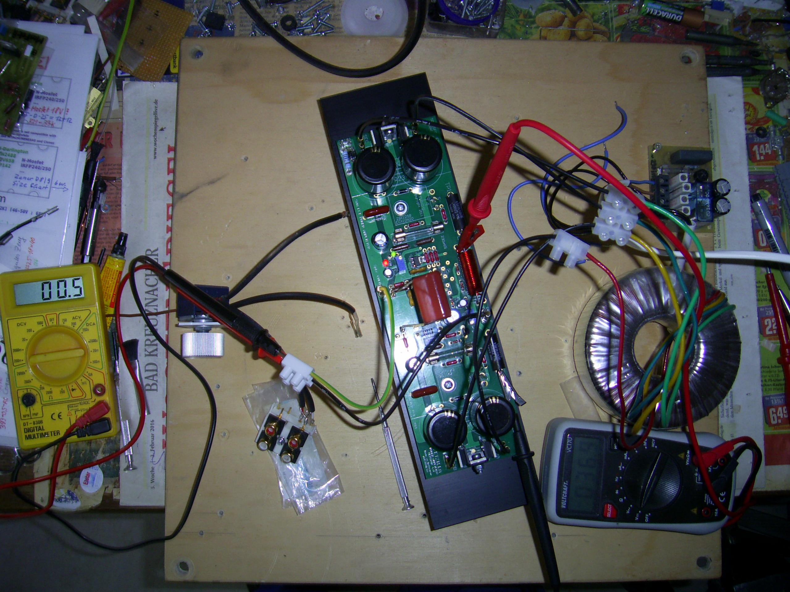

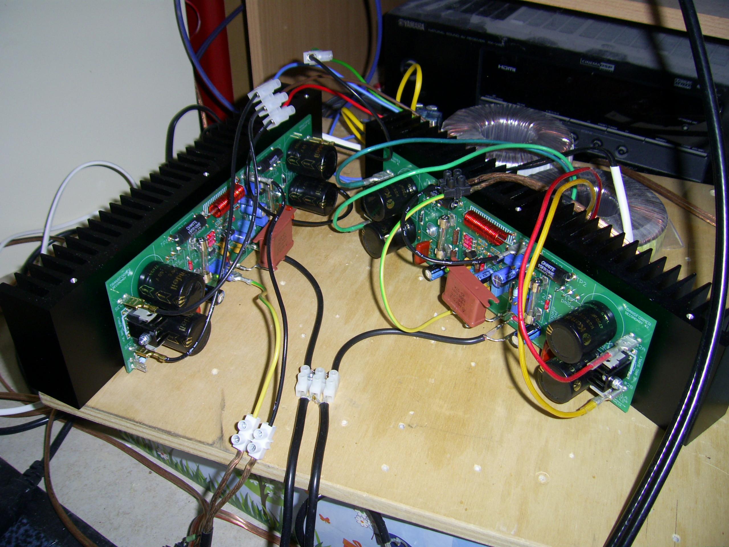

Hallo to FetZilla Community.
First i must say great Thanks to Hugh, Greg, Lineup and Mikelm for sharing
his knowledge with us DIY assemblers.
My Boards are from last Group Buy- Thank to Meanman this Way.
After long Time collect all Parts together, i've now finitely all assembled- puuhhh!!- long time was gone.
2 Days back i've started with setup procedure. After 1/a half Hour they running
stabil with offset crossing the zero- Point+/-, all good.
Now it's time to listen- late Night, first!
I don't like to spent expensive Money for PP- Input Cap, so i found by reading
on Greg Erskin's AKSA 55 Comment the use of Nichicon QXP.
With first listening i use it impressed me much. After 2-3hrs burn it it gives a
nice Imaging Stage, good Solist/Instrument separation and Front- backwards
orientation.
Also there is a full bodied presentation, nice human Vokal
Next Day i tested out russian PIO- Cap's MBGCH, MBGO.
The first gives more in Treble rendering, it loose in separetion
Second MBGO (see on Pic) soundet in kind of QXP and wins about bigger MBGCH.
In use with good choice source the Amp is singing.
Musik begins to flow out of my budget DIY Speaker from German K & T CT225 Strassacker: Loudspeakerkits (DIY kits), but sounds
surprisingly good.
The Amp sound in Region what i'm searching and i agree what Hugh wrote
about #High End Class# Amp.
Also a German Distributor have Heat sink Fischer SK 56/75/SA which i use.
https://www.hifituning24.de/mechanik/profil-kuehlkoerper/fischer-elektronik-sk-56-75-sa.php
At these given point i'm very lucky to finish mine successful now.
Hope i can reassemble a second with new Boards Group Buy.
Are in new Boards some changing Part Spacing!!?
- the Fuses 6x30 could not placed exactly
- the Rectifier Diodes Hole Dimension was to small.
- the Mosfet could not change to Exicon, also the given Holes to small.
hope it could be possible increased in *The NEW FetZilla Board*
For the Moment Thanks to Patric for starting new Group Buy- i'm in.
Also Thanks to all Mentors and DIY'er that we can enjoy a wonderful Amp.
In Moment if i write here i'm listening to Kabel- Radio- Station: Cool Jazz-
it's really cool to listen.

Thank you too, Bangle! And to me, like Meanman, the FetZilla is pretty important in my heart too!
If the fuse connects well then that is sufficient; if you use 20mm M205 fuses it's fine as long as they contact at the ends.
The FetZilla has very good resolution and it delivers a full body presentation. It is ideal for older music, recorded in the sixties and seventies, and very good for TV music on a soundbar. I found the best sound around 350mA quiescent, but the heatsink does get warm.
