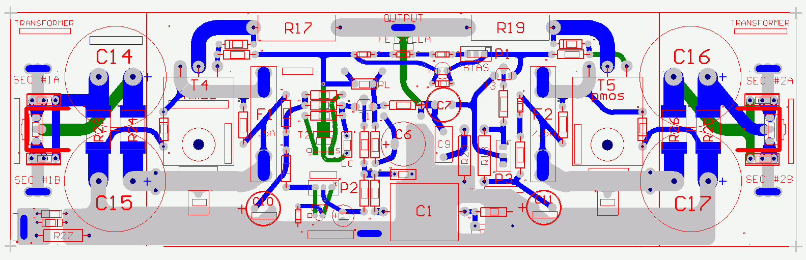

Let me give some explanation of progress. Paul Bysouth, a local engineer, and Greg Peters, aka SWF on this forum, have been in discussion at some length.
Firstly a decision has been taken to keep this as simple as possible for exceptional performance, no simpler, but certainly not unnecessarily complex, as this would put off early adopters who should be encouraged to build this lovely amp. This has meant power supplies on the same board as the amp, so it can simply be hooked to input/output and trafo, simple mounting onto a large heatsink to permit choice of quiescent currents without thermal stress, and through hole components wherever possible.
Secondly, there is a lot of design input to the switch on/off transients on this amplifier. This is always a vexed issue as people are very leery of seeing their speaker cones excursing across the room a la Back to the Future when the power switch is thrown. Switching spikes are largely caused by settling currents in the input stage; with zero volts at both gate and source at switch on, we have the jfet moving immediately to Idss; in the case of the 2SK170 this is typically 8-12mA and this current viciously turns on the VAS, which responds immediately with a large voltage spike on its drain. The output stage faithfully follows this spike, and voila, we have a spike on the speaker itself.
The correction is effected when the input cap and the fb shunt cap are charged to the set bias voltages; but this takes time. What is worse is that the 1.5uF input cap charges via the 33K bias resistor (time constant 50mS) and the fb shunt cap, fully 1000uF, charges via the source current of the jfet (which initially is at Idss). This charge pulse also prevents immediate current flow through the series fb resistor, further preventing offset settling.
Mitigating circuit conditions are in the power supply, however. LTSpice calculates switching spikes on the assumption that the rails build immediately to the 36V chosen here; in fact the process is more gradual as the filter caps take finite time to charge. This reduces the output spike. With mosfet (DN2530) input device, LTSpice indicates about a 19V spike, yet with the 2SK170 device SWF says the spike is no louder than the sound of the toggle, and the speaker cone hardly moves, indicating much, much less in practice. [EDIT: Paul has just informed me that with the 2SK170 front end device modelling in LTSpice indicates only a 3.6V output spike, less in practice, so all is well. HD] In order to avoid the complexity of a servo, I feel this is quite adequate. If it proves an issue for more fragile single range drivers like Lowthers or tweeters I would suggest using a three position (double throw), three pole power switch, with 1st position off, 2nd position amp on, and the final switch position connecting the hot output of the amplifier to the speaker. Since settling time is less than 100mS, as long as the user is not sniffing white powder all should be well.
I have made subtle changes to the layout. There are vertical overlay lines demarcating the power supplies from the amp module, so that they can be cut off if desired to permit use of off board supplies; smd provision for the ZVP2110G, the mosfet 2W version of the ZVP3110A VAS; RC decouplers on both rails for quieter operation, and rail/ground diodes to offer DC protection to the speaker should only one rail fuse blow. I have configured the output stage so that source is the center terminal, for both Exicon (Profusion) and Hitachi devices. Note that this is NOT the same pinout as the IRF/Vishay hexfet Mosfets, which are Gate Drain Source, left to right. I have also added a very clever CCS/bootstrap hybrid which combines the best of both approaches, courtesy Paul Bysouth, a highly competent local engineer. C1 is a large (20Lx17D), quality axial component, I have selected an Auricap of 1uF. I have split the bias generator into three 4148 diodes and a 200R trimpot to reduce 'accidents'. If quiescent control in hot conditions is poor, the diodes can be relocated on the underside of the pcb, facing the heatsink base. This will offer some thermal feedback and should throttle back the output stage in very hot operating conditions. I have confined max adjustment with 12mA VAS current to about 4.5V. 2.53V gives a calculated 350mA bias current, so this would give us up to just shy of 1A, sufficient for this design - deep Class AB. I'm assuming 0.1R source resistors and 0.7 Siemen tranconductance on the outputs, about the average. In practice this will vary somewhat, but the range of adjustment is quite adequate and ensures that it will be 'safe' to set up. I've done a general tidy up of the pcb, it's looking quite refined now and will, I can assure readers, be very easy to build.
Throughout this design phase Greg and I have moved away from Lineup's current drain approach on the input device using a CCS. While this approach has strong appeal for biasing reasons it slightly reduces PSRR as the very sensitive fb node, the source of the jfet, is coupled via CCS to the negative rail with its half wave rectified pulses due to output stage operation. It also adds at least one other semiconductor. In my experience a CCS is NOT a firewall for noise; it's actually quite sensitive to noise injection. The decision to pass all jfet current through the series fb resistor is logical from a noise POV as the output is one of the best decoupled nodes in any amplifier. This approach does mean that a bias voltage must now be applied to the input jfet gate; but this actually polarises the input capacitor and greatly improves its sonics. Knowing what can befall amps in the field, I always cap couple the inputs of my amps; it's a safe approach and avoids many mishaps.
Greg is presently on holiday in Singapore, Munich and Paris and will be back in Brisbane on 11th July. On arrival he will verify our choice of ZVP2110G and recheck the turn on transient for the Fetzilla.
I have attached the revised board. All my experience with amp design over 15years tells me this will be an extremely good ampifier.
