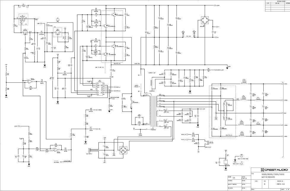

Hi Kanwar,
Have you the complete Crest amp schematic? This is possible send me:
fabrasantos@@@yahoo.es
Thanks,
Fabrício
Thanks,
Fabrício
