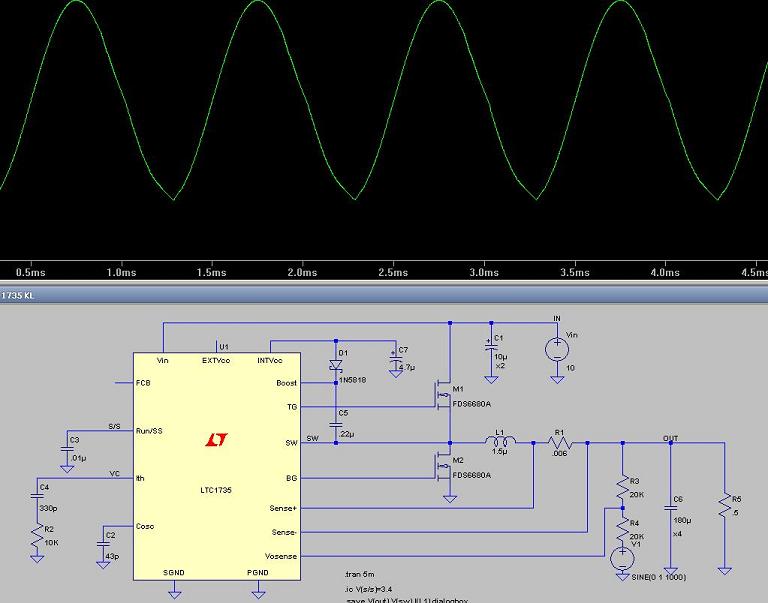

I was going through my National databook and noticed a striking similarity between their switching regulators and digital amplifiers. Both of them have an integrator upfront, an oscilator, an comparator. Now, their drive mechanism isn't exactly the same: those switching regulators tend to drive just one mosfet, vs. half / full bridge for digital amps. sure, there are other differences but I think there is a chance we can use those switching regulators in a digital amp.

here is my preliminary thought:
a) we can keep the front end of the IRAudamp, and replace the logic gates and gate driver with a simpler solution, like LM5104 - it requires just one signal, and has shoot-through protection, low-voltage lock out and soft start, not to mention programmable adaptive dead time.
b) we can also replace the entire front end of the iraudamp, with a pwm controller. here we have a lot of choices. my favorite is lm5030: high switching frequency, high voltage, etc.
The difficulty is to feed it with an audio signal, 🙂.
Those pwm controllers have an error amp where the feedback (from output) is compared to a reference voltage (usually 1.23-1.25v). obiviously, that doesn't work for us unless you want to listen to DC.
so my suggestion is to use an enternal error amp / summing amp that calculates the difference between the output and audio input and feed it to the feedback pin on the pwm controller.
c) this solution is also quite interesting. There are switching mode regulators that integrate the pwm controller and gate driver - lm2655 for example. so with it, you need to add a mosfet (for asynchronous amplification) or a couple of mosfets (for synchronoous amplification) and you are ready to go.
The downside is that they usually handle low voltages so that is kind of limited to low power amplifier. but nonetheless interesting to try.
One final point: all those solutions assume single rail, and due to their regulator nature, they can only source current. As such, there is a DC element in this type of output. I assume that you can use a DC-blocking capacitor after the low-pass filter to keep the DC out of the load.
what do you think?

it seems to work!
here is a digital amp based on linear's LTC1735 - the first one I tried out of the SwCad download.
Vosense is the feedback point, and I added the signal source, V1, to the bottom end of R4.
The output is a reasonably shaped sine wave - the bottom end needs more work.
maybe it can be further improved?
I remember posting the idea of SMPS modded into a voltage controlled voltage source some time ago in a different thread. This way you won't need additional power supply since all is switching mode.
I simulated this against quite a few Linear SMPS controllers and it does seem to work, at least at low frequencies (1khz), due to their somewhat low switching frequencies (usually around 150khz).
so I think the concept appears to be sound. We just need to find the right chip to make it work.

soongsc said:1. Resolution of the output in response to the input signal.
that's something I am finding out. the responses from those pwm controllers don't seem to be particularly fast. Not sure if the circuitry needs tweaking or the chips are foundamentally slow.
soongsc said:2. Load variation.
so far, they seem to be pretty immune to that, in simulation at least.
