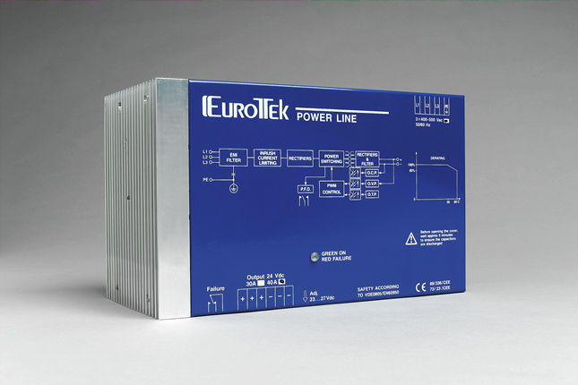

Hi guys,
Can I use a switching power supply with a Zen amp? Is there any problem as long as it delivers the requested volts?
Thomas B
Just check the output noise under load with a 'scope. All SMPS's will have *some* residual noise (as do linears) so a little extra output filtering caps wouldn't go astray perhaps, depending on just how good the unit is. Use low esr types that specify the esr at high frequencies. When you get the thing going, please publish the great results and benefits so that the anti-SMPS crowd can put you straight. :rolleyes:

I would be very interested in trying out the switcher shown, perhaps with some added LC filtering on the output (both lines).

Another issue with SMPS is that they typically have relatively poor performance at low power output. Looks like the unit in question is a 40A unit. You will be unlikely to draw anywhere near that with your amp. If I knew something about the topology of the SMPS, I might be able to suggest ways of setting it up to be good at lower current (unless it is a resonant mode device -- in which case I won't even bother trying). Potential remedies is added inductance in primary or secondary, increase switching frequency etc.
