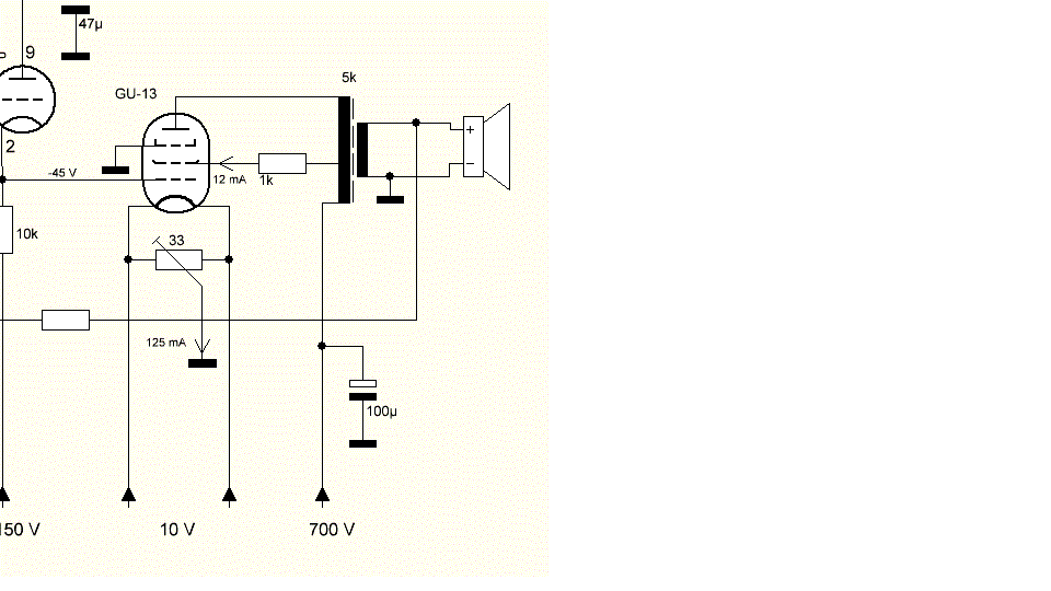

Do you have a hum canceling resistors (trimmer) across the filament, similar that is used when having AC-filament voltage ?

Thank you for the suggestion
I did use hum cancelling when supplying a.c. to the filament. For HF switching PSU or buck converter, it is less effective.
With filament bias, the ground return has to be on one end of the filament connection.
