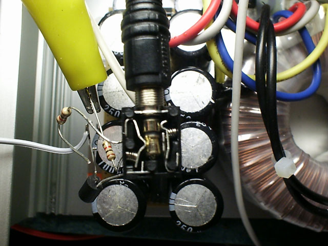

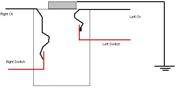

I would like my amp to turn off the speakers when I plug in my headphones. So I bought a headphone plug/contact with an internal switch. But, because I don’t have a separate headphone amp ( just running them on the power amp, 330 Ohm resistor from speaker terminal) this switch now becomes useless. This, because the switch really is just a plate that contacts the signal pin.
I can’t make the switch turn on relay, which in turn turns off the speakers, because I can’t put a signal for the relay on the channel-pin.
Any bright ideas? The contact looks like this illustrated on a drawing and a pic.

Why don't you get a regular headphone jack, connect 330 ohm resistors to it from speakers output and install a switch at the back of your amp which can disconnect the speakers. It may be mechanical (like double pole AC switch) or toggle switch controlling a relay. Do you really need convenience of automatic speakers shutoff when you plug your phones?😉
You can easily pass the necesarry voltage through the contacts in the jack to fire a relay to the speakers and use caps to bypass this voltage from getting into phones and the amp. I don't see why it wouldn't work, perhaps even very well... If you guys want a diagram of what I'm thinking, I'll happily supply it!😉
Heh. Try this (it's quick and cheap and may be okay). Use a single 330 ohm resistor in series with the ground of the headphone jack, and get rid of the other two resistors. The left and right channels will blend somewhat, but you may like this effect. You can play with the resistor value a bit. The speakers will cut off when you plug in the headphones, but the resistor will not affect the speakers, just the headphones.
THEN, build yourself a decent headphone amp. See www.headwize.com.
Yeh, that be a really good idea actually. But why would the channels blend a bit? Seems like that would work just perfect putting twice the value resistor on the ground instead.
Or, I'll go with Peter D. suggestion. I've seen larger (not 3,5 mm but 6mm or so) phone plugs with a separate switch, which would be ideal.
Then I'll just make it draw a relay when plugged in, which disconnects the speaker. There will probably be some kind of click in the speakers, but I'm sure it can be fixed somehow.
/Chris
