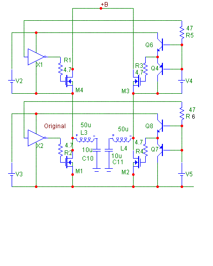

For switching lots of fets (2250pf gate capacitance each and there five of them) should I incorperate a extra strage to my PSU which give a extra 10v on my rail voltage and use a bipolar stage for switching them? (like the ESP SMPS)
also is it possible to saturate the transisters by having a 25v base signal and have it switching ~50v?
any better surgestions would be appreciated :)
Thanks all
Do you have a diagram? Do you mean like the mosfet driver stages here? BTW the junction FET constant current source here needs to be replaced with another type which can handle higher voltage. V9 and V10 could be mosfets with the gates tied to the drains and sources by means of potentiometers and be mounted on the heatsinks for thermal compensation. I don't know if the circuit works since I was only able to simulate it.

Frequency is about 100khz, Current can be almost anything as i'm just adding windings to a 10kw torroid of a SMPS for a car amp.
its for a class D amp whereby a lm4651 give out a 25v pulse (typically use for a integrated H bridge) @ 100khz to the music and the rail being swithed is about 47v.
As far as I figured I'd have a PNP and NPN on thier respected rails (one GNS the other VCC+10v) driven off the same pulse so that when ones on the others off at all times. The outputs would be tied to the array of fets with each fet having its own charge/discharge resistor. FAirly simialar to the schematic posted.
Is it gonna work?

fr0st,
I am glad you mentioned the gate resistors, the importance of which I failed to mention. I think I see what you are doing.
Sounds like you are going to make quasi H-bridge and you are constructing buffer emitter followers whose bases will get their signal off the drivers for the two mosfets there already. Those two pairs of transistors will then drive the two new mosfets via suitable gate resistors. Sounds like a good idea and quite feasible.
But I suggest you reference the mosfet drive power supplies to the sources of the mosfets being driven, like shown in my diagram. You should be able to add as many windings to the transformer as needed to derive those voltages. Be sure they are regulated to no more than the voltages driving the original mosfets. However, you do not need the biasing diodes I included in my diagram between the bases of the buffer emitter followers for your application. Be sure to take the drive signals for the new mosfets before the gate resistors of the original mosfets. Is the diagram here like what you are doing?

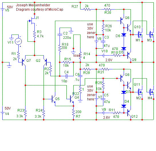

the bipolar stage here is what i'm getting at, except replace the transisters with higher spec'd ones where neccesary and raise the Vcc to 10v above rail. One question is with the fet on the negative supply would te source voltage be 0v (using n channel's) and the drain would be at the negative rail voltage? this would make the voltage needed to switch it on 10v?

The main part of the ESP schematic I was refering to was Q1.2.3.4 and M1,2,3,4.
My plan was to instead of the pulse from the 3525 the class D chip signal would be fed to the bipolars. Q1 would have VCC + 10v (in this case 57v) instead of 12v and Q2 would remain grounded. The signal being fed to the base of both bipolars would be the 25v.
disregard the rest of the schematic but the bipolars, mosfets and resistors between.

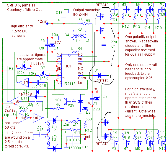

Is there any chance that your able to reference me to a discrete version of what your describing, from the descriptiong I can't quite figure out how it all fits together.
OK, I will try to help you with bootstrapping and how you can use the IR2110 to drive as many mosfets as you like. This schematic can be seen at my web-site in my signature.
I solder the IRF7343 directly onto the ir2110. It is the only SMD I use. It has very low channel resistance figures for both its mosfets in its SO-8 package.
D1 and C1, the .22uf monolithic or tantalum may have be increased in value if you're driving much more gate capacitance than 10000 nF. The IRF7343's are configured as source followers, so they do not waste any power while switching.

One concept I havn't yet benn able to figure out is how the IR2010 would work in a split rail H-bridge rather than having the low side grounded. so I've got a few more questions :dead:
what is the bootstrap cap charged to (voltage wise)? and what is it reference to?
I imagined it was charged to Vcc so when the positive side was refenced to the gate the Fet saw a 12v difference between the gate and source but this is probly wring since the cap would have no way to charge since the Vs pin only ever see's the high rail. (if that makes sense).
Also is the IR2010 capable of putting out a -40v as a gate drive or will if use a bootstrap topology again?

Hi fr0st,
Well, for one thing, if you use split rails, you do not need a full H-bridge. You can still do that with no problem if you want to by simply placing all the control and logic circuitry on the negative rail where the IR2010 is referenced. You will need two IR2010's with signals on the input pins 180 degress out of phase with each other, and then take the output across the mosfet totem poles.
With split rail power supplies, you have the option of using the simpler setup of the half bridge. You can take the output between the totem poles and connection between the upper and lower supplies. But either way your IR2010 has to be at the lowest voltage location.
It sounds like what you really want to do is use a single polarity power supply with your control circuitry at ground potential, the bottom, and take the output from a full bridge, or H-bridge, as it is also called.
The bootstrapping is a good thing. It makes it so much easier to drive the upper mosfet. The VSS pin is actually pulled low when the lower mosfet is turned on. Of course, the upper one had better be off at that time, or smoke! Then, when the IR2010 turns on the upper mosfet, using its source pin, carries the bootstrapped power supply up with it. I did not see on the data sheet that the IR2010 uses internal logic to prevent both outputs from turning on at the same time, but I am aware that the IR2110 and the IR2113 do.
