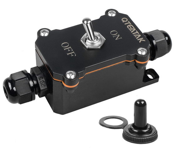

hello everyone. lately i've been doing a lot of impedance measurements with a 100 ohm resistor in series with the speaker connected to the headphone output of my e-mu sound card. sometimes i have to switch to SPL measurement and therefore i have to change the connections. i would like to use a box that allows you to change the type of measurement with a simple switch. i could build a box like this by buying all the components online and then proceed with the assembly but i would like to know if there is a ready-to-use box that doesn't have an excessively higher price than the diy self-construction. hello and thanks.
Are you looking for a box with a single pole switch that can bypass a 100 ohm resistor in series with the speaker?

I did exactly what you are proposing. I had the resistor divider in a small project box and switches and RCA jacks etc. It worked, but in the end when trying to do precise distortion measurements I found there would be problems. I eventually just made a cable with the 100 ohm resistor, RCA plugs and the TRS plug with hard wired set of clip leads for impedance measurement separate from the attenuator box that I use for amplitude measurements.
I found ARTA-box. For impedance measurement I use the LIMP program that is part of ARTA so this box would be just right for me. I usually use the headphone output of my E-mu USB sound card (and I would like to continue this way because it is more convenient) but it seems that this box uses an external amplifier.
